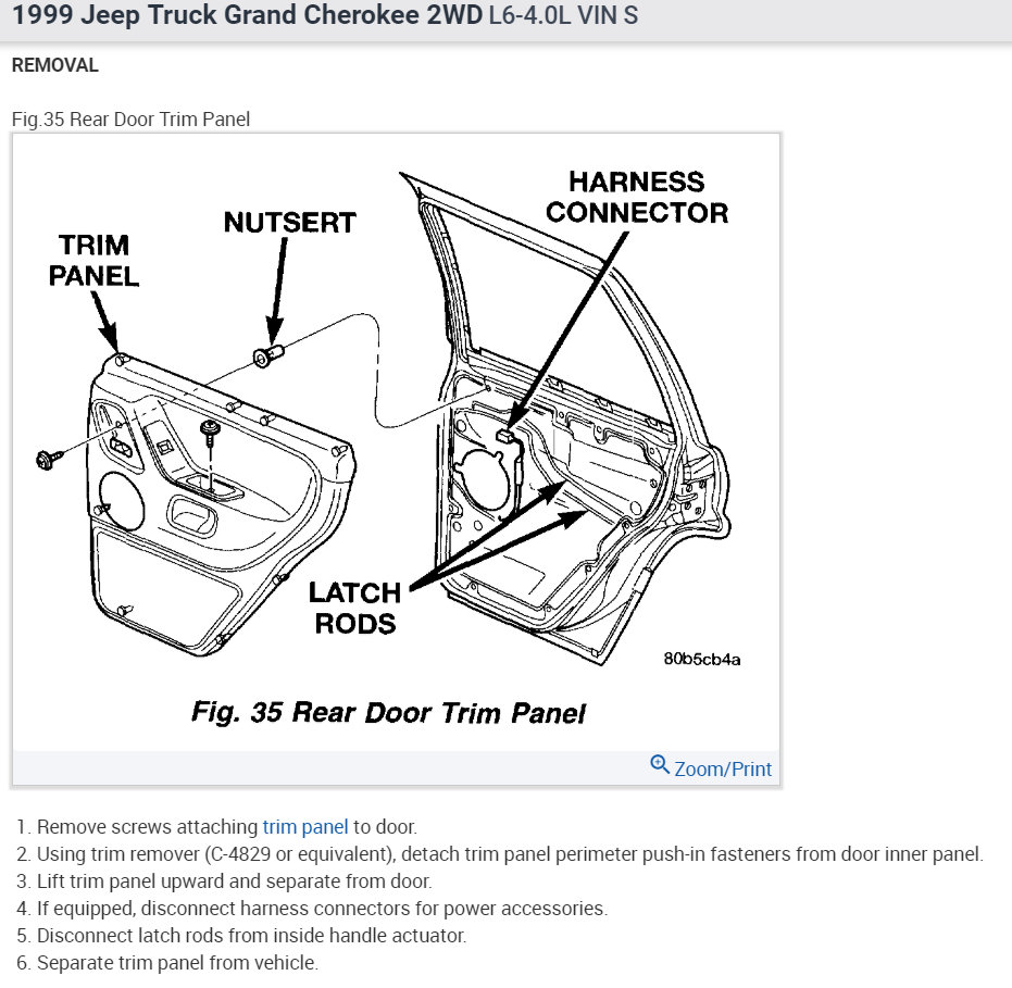

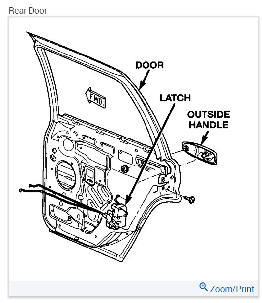

Rear door does not lock. All other doors do.
Jul 28, 2018 at 6:23 AM
  • 55,433 POSTS

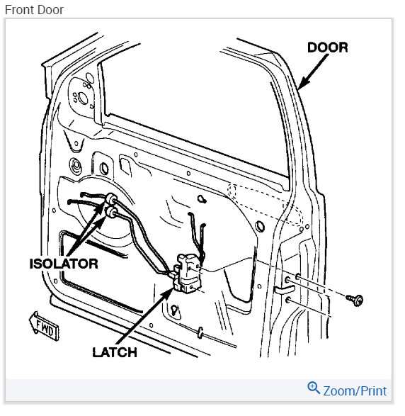

It sounds like the lock actuator is not working but to be sure lets see if it is getting power when you work the locks. Here is a guide to help you see how check both wires:
You must remove the door panel.
https://www.2carpros.com/articles/door-panel-removal
If you have power at the lock actuator replace it with new. Here is how it will be for your car.
