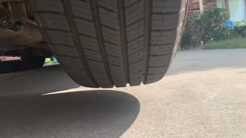

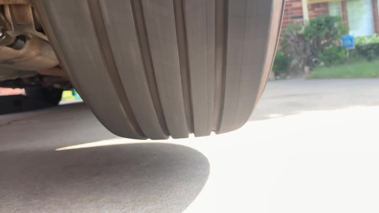

I’ll try to take a video of them, I just swapped out the axles this morning and it seems better but still does it.
Oct 1, 2019 at 1:06 PM
Try and upload it to this post for me.
Oct 1, 2019 at 1:27 PM
1997TOWNCARSIGNATURE
  • 10 POSTS

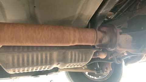

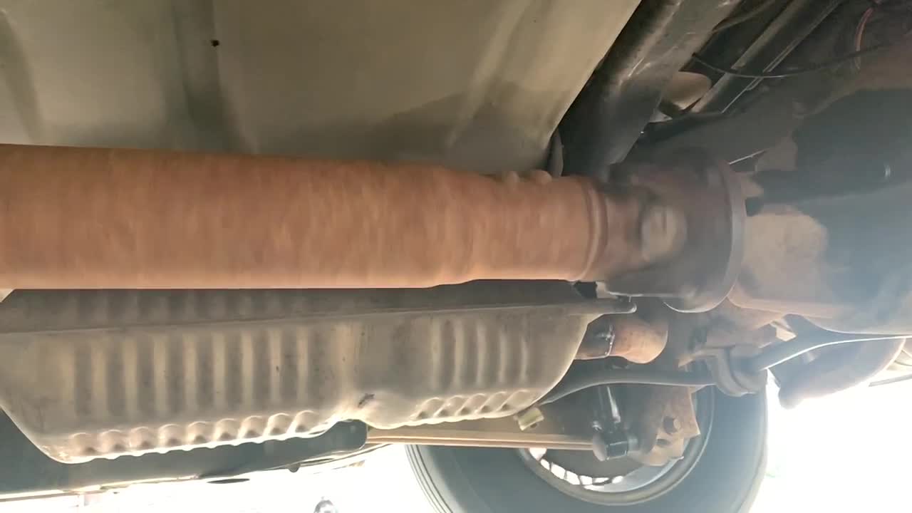

Could the driveshaft cause wheel hop?
Oct 3, 2019 at 3:34 PM
That was the next thing. If you have a driveshaft out of balance, it would do it.
Oct 3, 2019 at 3:39 PM
  • 10 POSTS

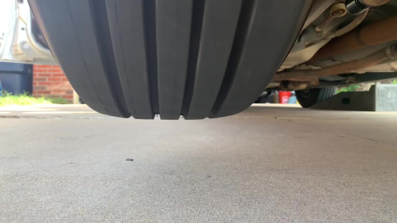

Here are the videos:
Oct 3, 2019 at 3:42 PM
Great videos.
Remove the driveshaft and make sure the U joints are free to move.
The first 2 are good.
Oct 3, 2019 at 3:52 PM

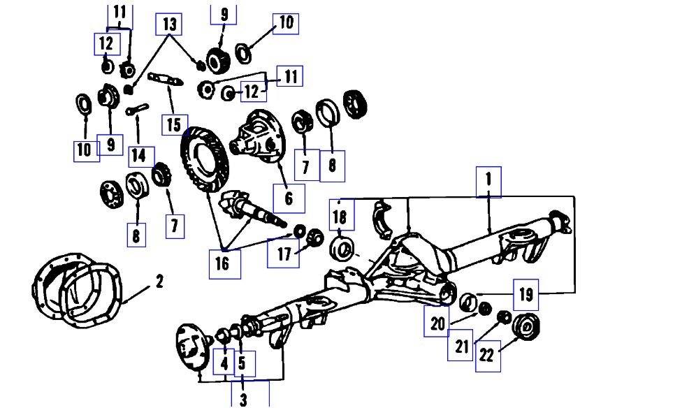

The driveshaft is balanced, the only thing left I can really think of is the differential carrier or axle tubes.
Nov 4, 2019 at 7:12 PM
  • 10 POSTS
And one of the u-joints was a little difficult to move, so I replaced it and had it checked and it balanced out.
Nov 4, 2019 at 7:13 PM
Looks like it is the housing itself. Very rare that is a failure unless there was an impact.
Nov 5, 2019 at 1:16 AM
  • 10 POSTS
Could the spider gears cause a hop? I noticed on the videos I took of the wheels they both would hop once per revolution or couple revolutions. The passenger side seems to do it more frequently.
Nov 11, 2019 at 6:58 AM
It could be bearings in the differential. I doubt the spiders as they would make a lot of noise.
