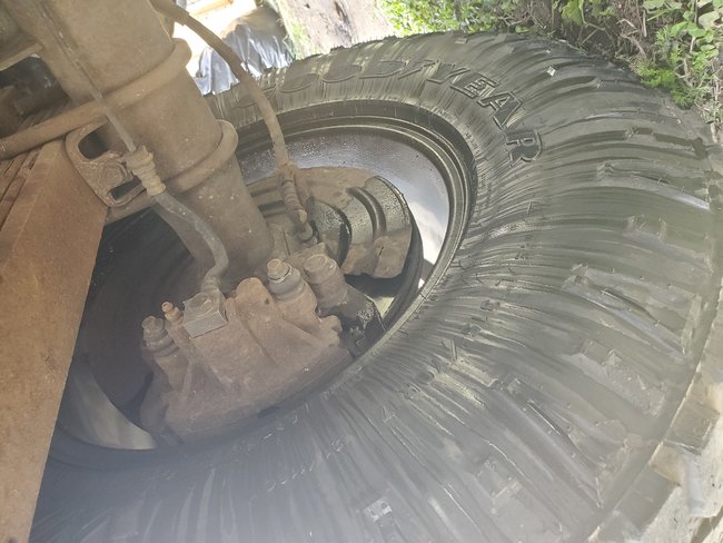

So shortly after I looked under the truck one day and noticed some type of fluid that splashed all over the inner side of the rear driver side tire and a drip from the heat shield on the hub, I thought it was brake fluid but the hoses were bone dry and so was the caliper, so I got some on my finger and sniffed it and it was differential oil.

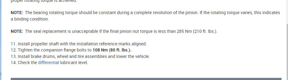

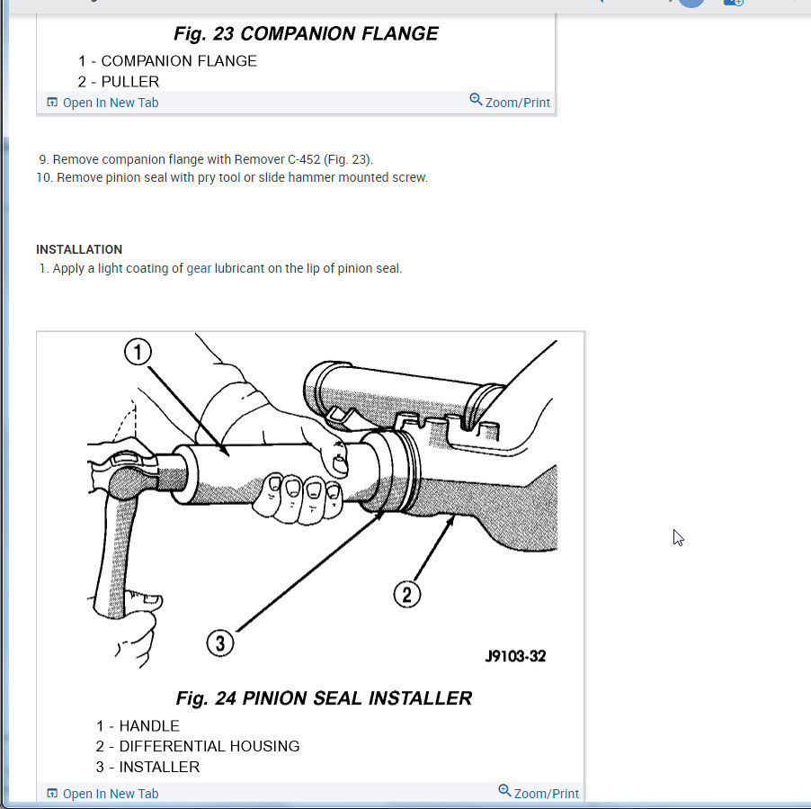

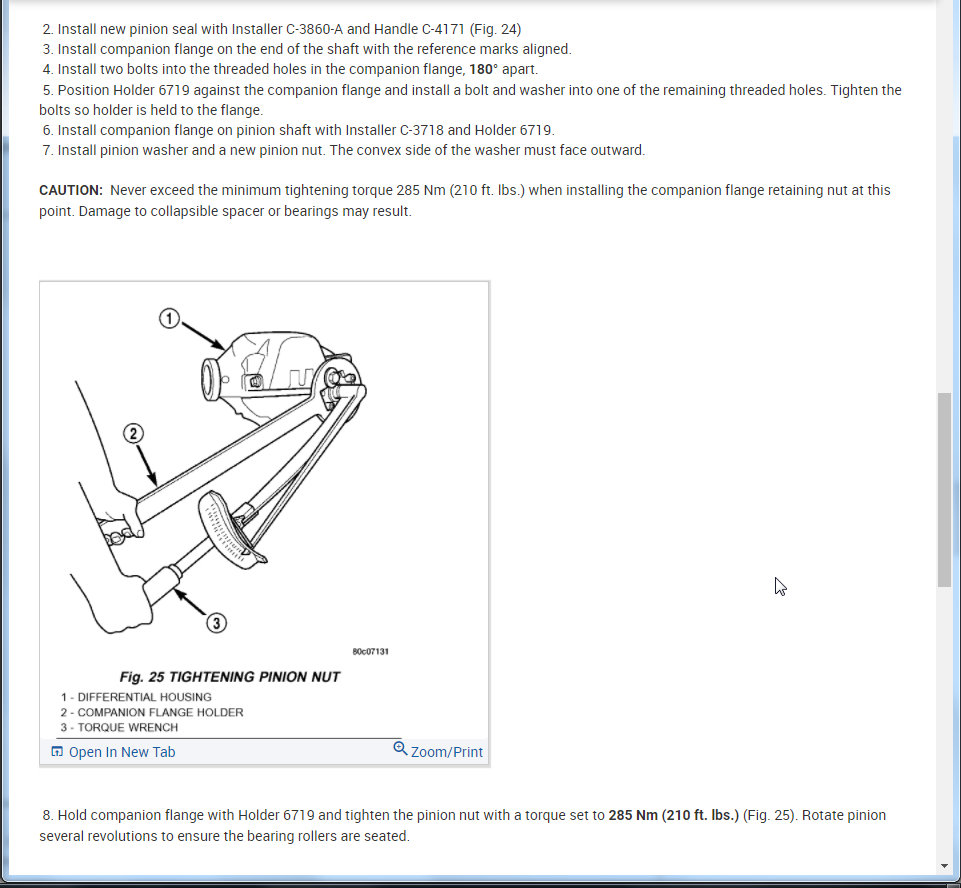

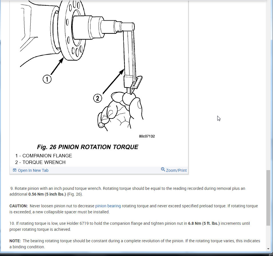

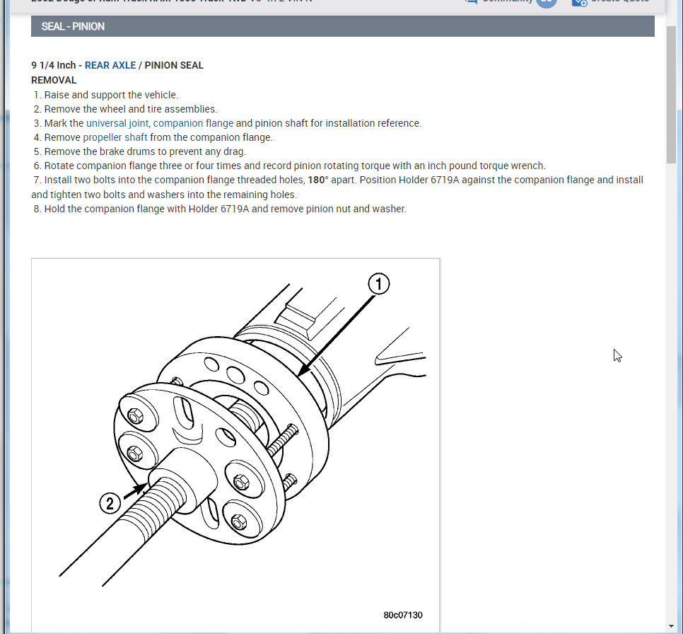

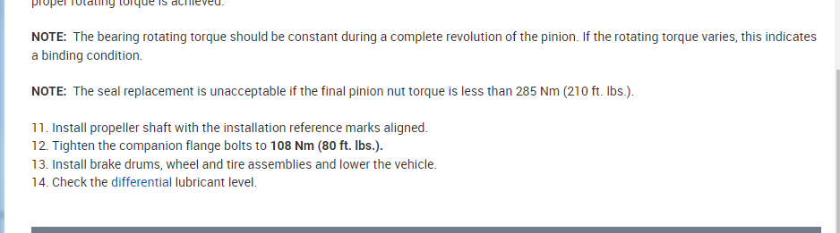

What I would suggest is start with what you know is leaking. Replace the pinion seal and then clean the entire undercarriage with a degreaser and hose and then recheck it every other day to see if there is any new fluid.
Here is the process from the manual that will help with this. Please let us know if you have other questions. Thanks

I guess I can't say how long either leak has been occurring, the first one I noticed was the pinion seal because I happened to notice a small amount under the rear end, it was only about the size of a half dollar coin, and I saw a drop hanging on the bottom of the driveshaft u-joint. So afterwards I decided to just get some differential oil and start filling it, it took a full quart before it was full, then when I went to check the fluid about a week later I noticed what's in the picture, so I don't know if this had just started happening or if it's been ongoing. So far now I haven't had to put any more oil in it for a good minute, I use my pinky finger to check the level and each time it completely submerged in oil in it. I'm going to check it again tomorrow or next day.
I guess now my questions are which should I replace first? And is the pinion seal causing the axle to leak?
And based on the picture what is the severity of the leak?

That is a pretty substantial leak. I doubt the pinion is causing the axle to leak so if it were me, I would replace them both. However, if you are going to start with one, then start with the pinion.
Let us know what other info you need.

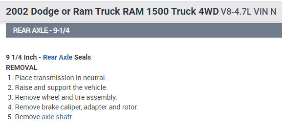

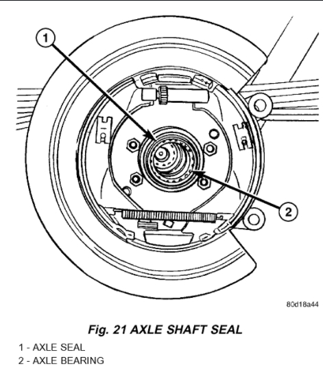

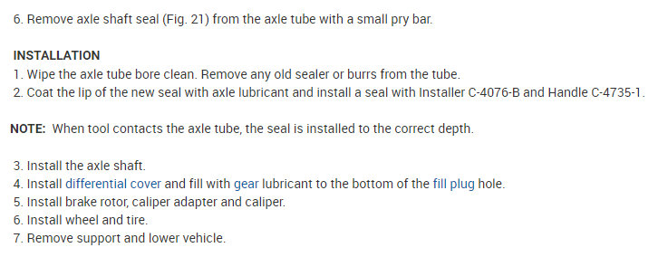

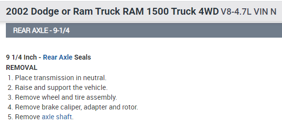

You will definitely want to change the rear axle seals because I'm sure the rear brakes are completely contaminated. Here is a tutorial showing how to replace the axle seals:
https://www.2carpros.com/articles/rear-axle-seal-replacement
https://www.2carpros.com/articles/how-to-replace-a-rear-axle-bearing-and-seal-3-4-and-1
I've attached picture steps below on how to change the axle seals for your truck. Does your truck have rear disc or drum brakes? I will attach those instructions as well once you get back to us with the answer. Brake pads or shoes once contaminated cannot be cleaned or reused. Hope this helps and thanks again for using 2CarPros.
