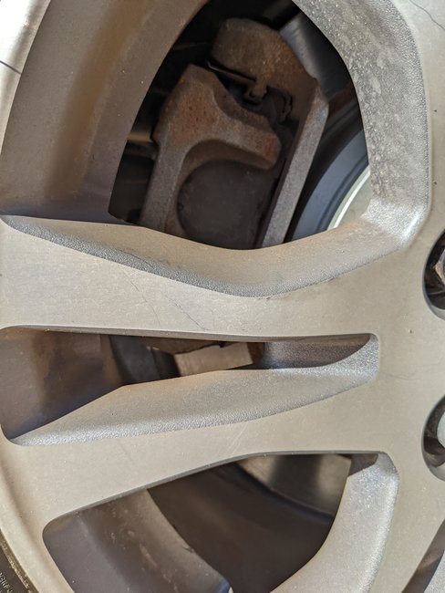

It doesn't happen often, but sometimes when I'm driving, I can hear the rear brakes engaging. It's an audible single "click" when I press the pedal. I'm not sure if it's both or just one. There is no squealing or dragging, just that click one time. This van just had all new brakes and rotors installed at the dealer around 10,000 miles ago, as well as a brake fluid flush and replace.
Is this something I should worry about? As I said it doesn't happen often, but I just want to be sure nothing is about to break or fail.

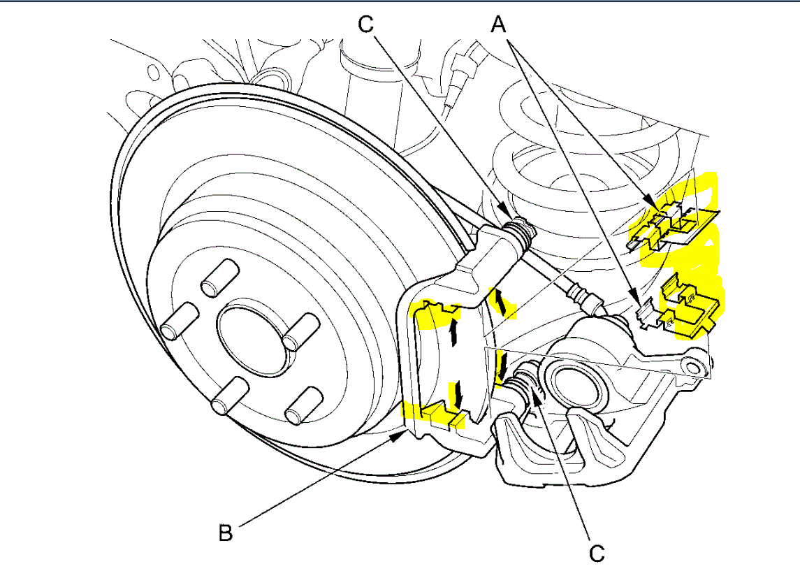

You shouldn't hear a click. Is it loud enough for you to record and upload for me to hear? Is it only when you apply the brakes? Have you ever heard of it when going over certain bumps?
There was a technical service bulletin a few years back that required the parking brake assembly be properly adjusted to eliminate the click over bumps.
If you still have the receipt from the brake work, see if park brake adjustment is listed.

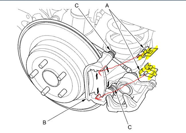

One other thing is this. Before the new brake pads are installed, there are pad retainer clips that may have failed. I attached a pic below showing them. If you can, look through the wheel to see if you notice anything as far as damage to them or if one appears out of place.
Let me know what you find or if you have other questions,
See pic below.

The only time I hear it is when stopping I press the pedal and I hear a click coming from the rear of the vehicle. I'll check over the paperwork and also see if I can notice that retaining clip.

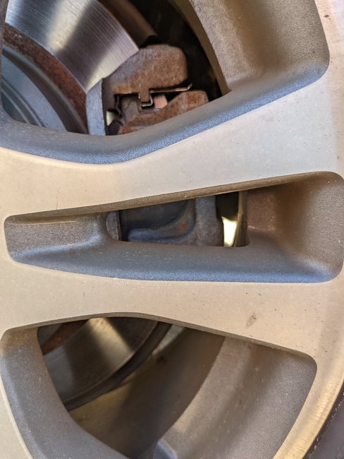

I looked at the rear brakes and the clips look to be in place to me, but I've got pictures for you to examine for sure.
Looking through the maintenance records for anything related to noise in the rear. I show rear struts replaced at 75,000 miles, the rear spring seats were replaced around 150K miles, and the aforementioned 4-wheel brakes done at 190,000 miles.
I don't see any mention of adjusting the parking brake. But I don't notice the noise when applying/releasing the parking brake, only when stopping occasionally...

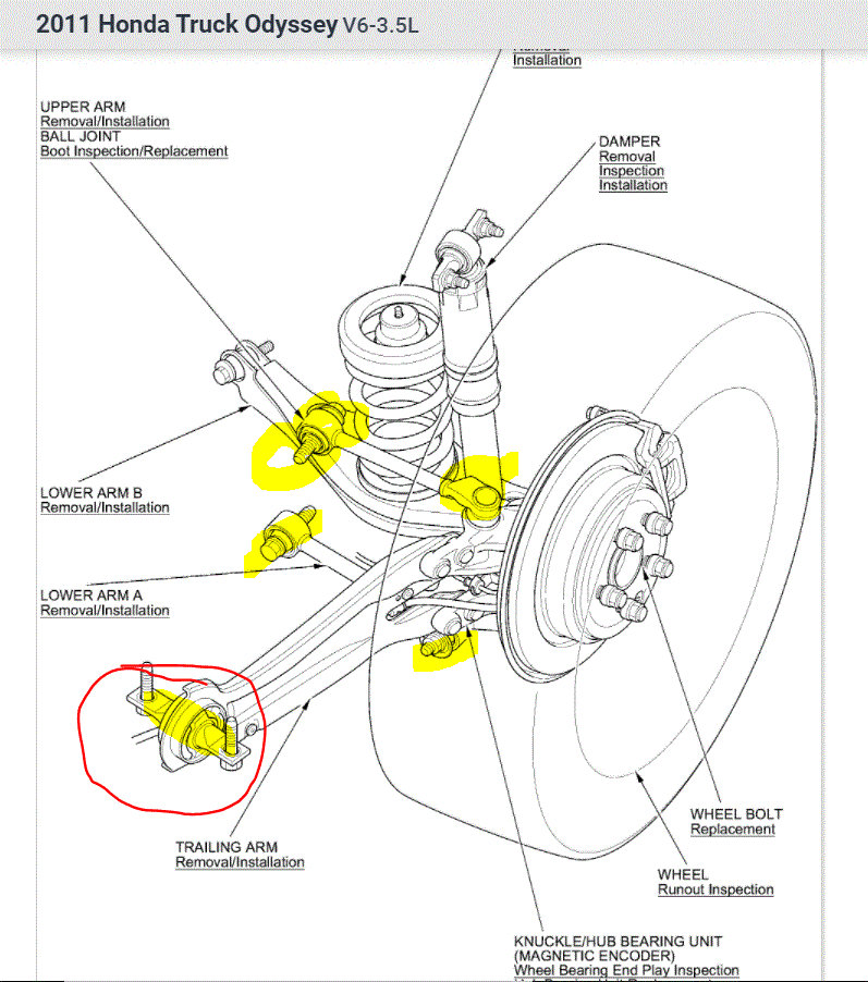

Everything in the pic looks good. There are bushings that can be worn. Since it happens when the brakes are applied, it could be the trailing arm bushing.
The only way to test the things I highlighted is to remove the weight from the wheel and then take a pry bar to see if there is excessive play in the bushing. Also, check if there are any cracks or damage to the rubber.
The one I circled would be most likely to make noise when braking because the wheel would be pulling on it when braking.
Let me know if you are comfortable checking this.
See pic below.

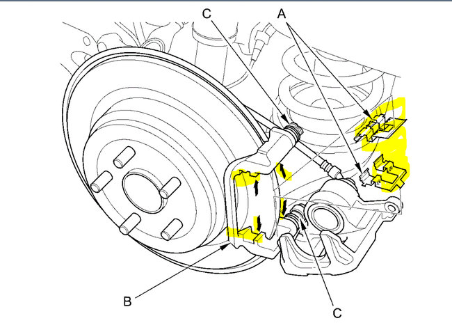

If the brakes caused it and it was that loud, you should next confirm the correct brake pads are installed and the caliper and caliper mounts are tight.
Is that something you feel comfortable doing? If so, make sure nothing is loose as far as the aforementioned bolts. See pics above for locations. Also, make sure the brake pads are tight and don't have excessive play.

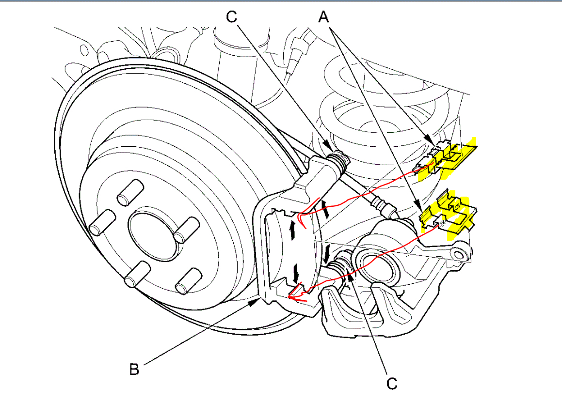

Regardless, let me know what you find. Also, make sure the pad retainers are properly installed and do not allow the pad to move up and down.
See the pic below to see the retainers.
Let me know what you find or if you have questions.
See pic below.

Okay I did the tire rotation and the only thing I found out was the little tabs on the brake clips were not down all the way. Some were bent flat, and others were a little lifted off the caliper. Would that cause the issue I'm having?

If the brake pad clips are not secured properly, certainly that can cause a click. Can you take a pic of what you see and upload it for me?
