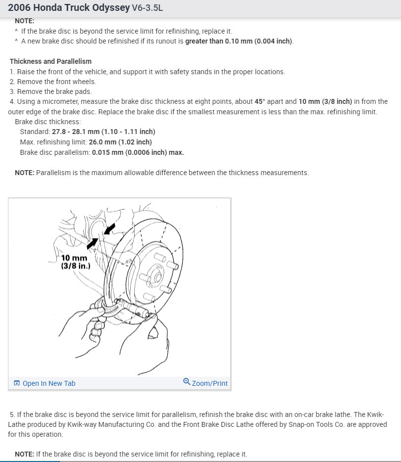

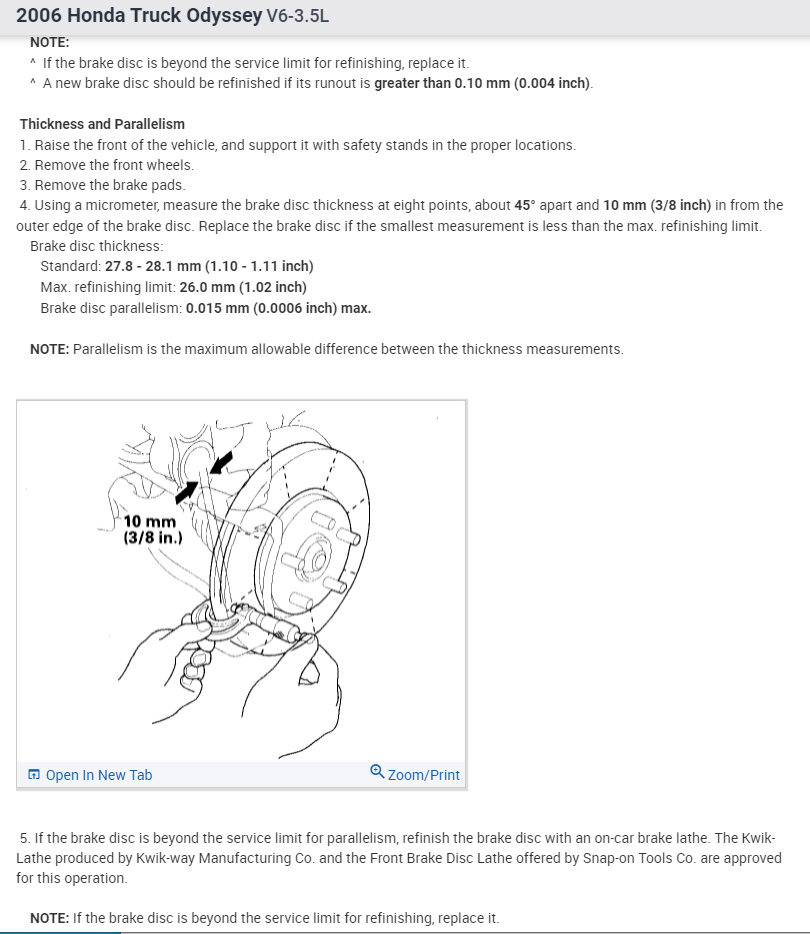

Steering wheel can shake for few different reasons.

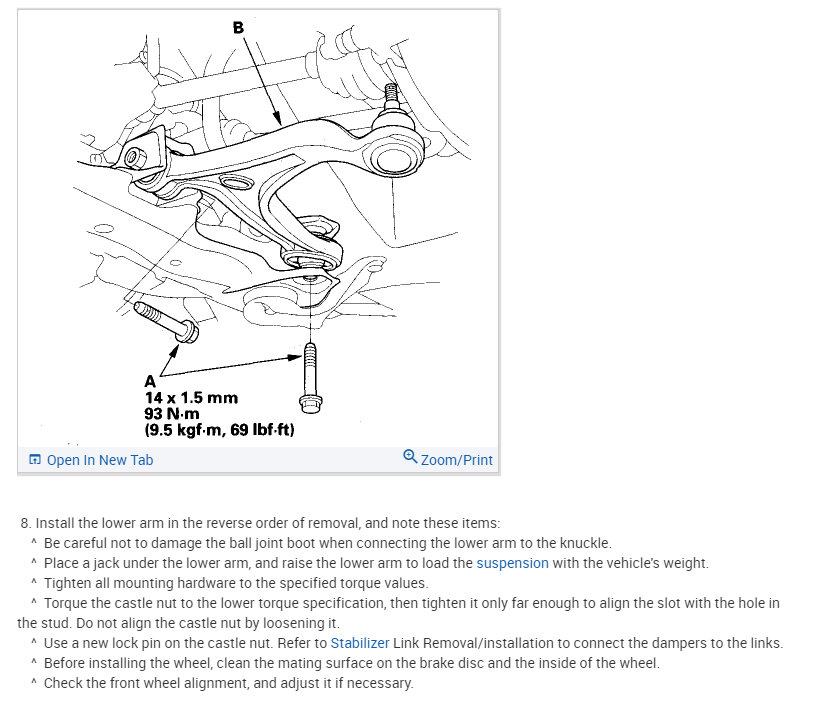

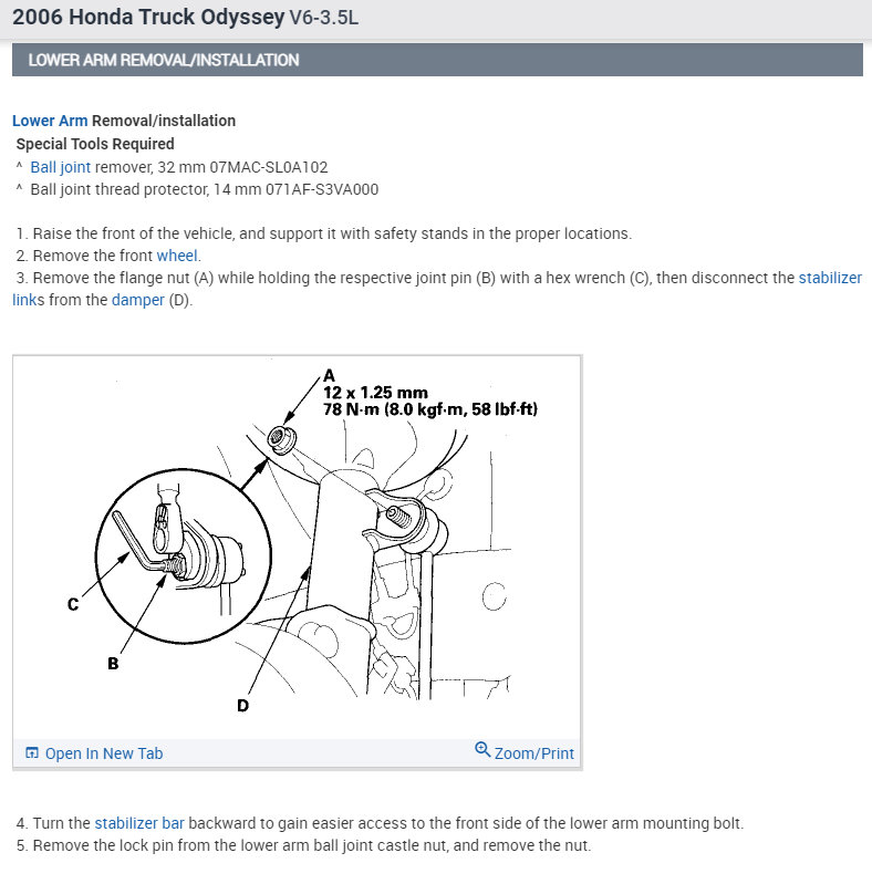

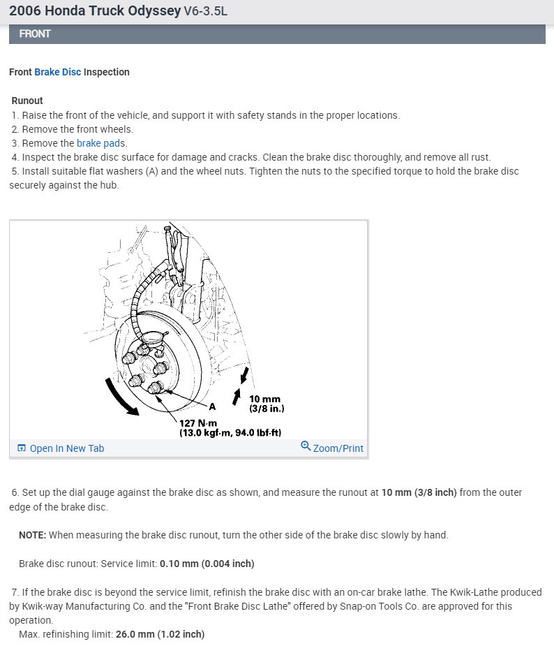

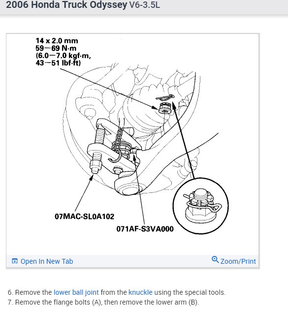

It could be due to worn suspension components like ball joints or control arms. Also, due to worn strut mounts. Another possibility is wrapped brake rotors.
Do an inspection of the suspension components. Look for any loose or broken components. Also check for excessive play.
The rotors should be checked for having excessive lateral runout.
Here is a helpful guide, run through these steps to determined what could be the issue:
https://www.2carpros.com/articles/steering-wheel-shakes-when-accelerating-or-braking
