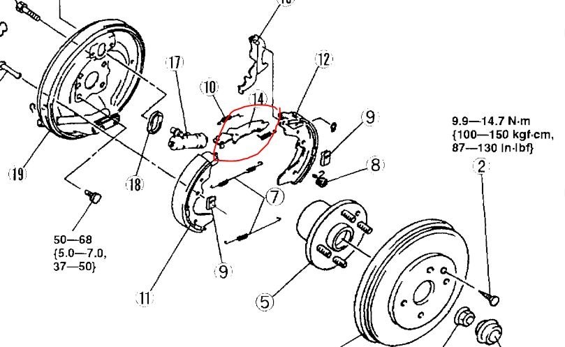

The rear brake adjuster on these vehicles are different that the traditional type. These have a ratchet type which are not accessible from the outside. So, here is what I suggest. First, make sure the retaining screws are removed from the outside of the drum. There are two and they should be a number 3 phillips. Next, make sure the parking brake cable is loose.

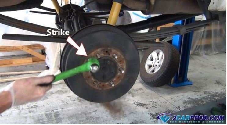

Then you will need to smack the drum between the wheel studs. Don't be afraid to hit it with a heavy hammer. See if that loosens it. Then tap around the outside diameter of the drum. (See picture 2)
I attached an exploded view of the brakes (picture 1). I circled the adjuster.
