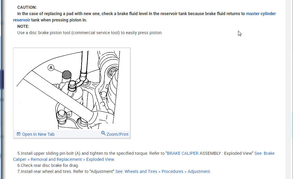

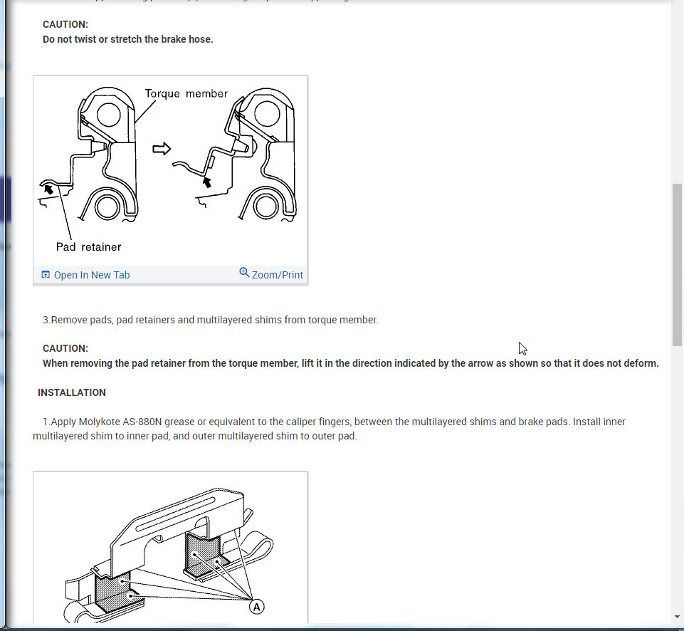

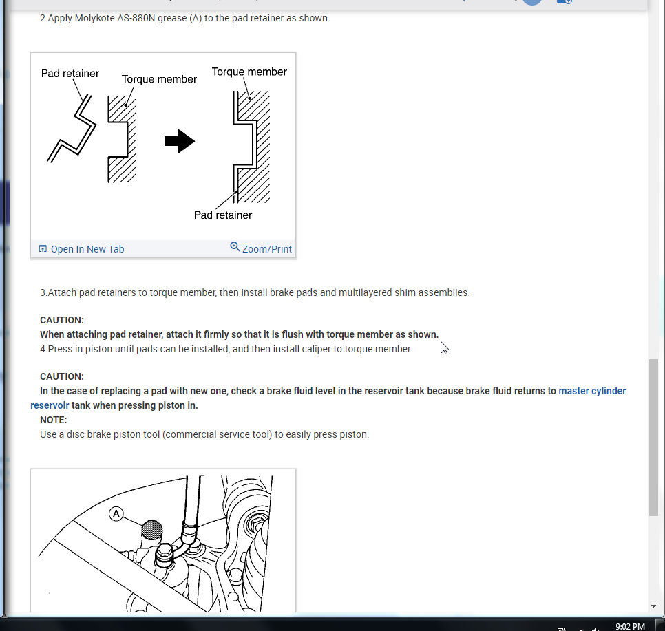

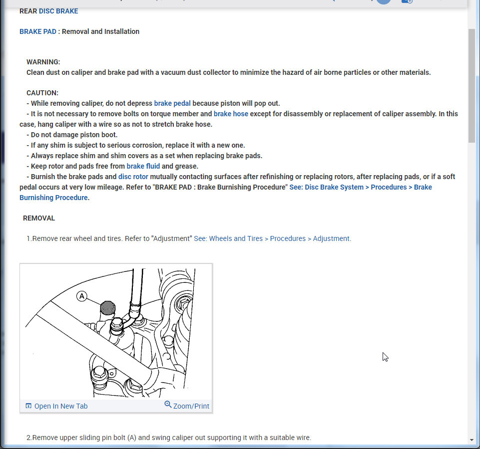

I am attaching the process below on how to replace the pads so you can review just to make sure you performed the repair properly.
