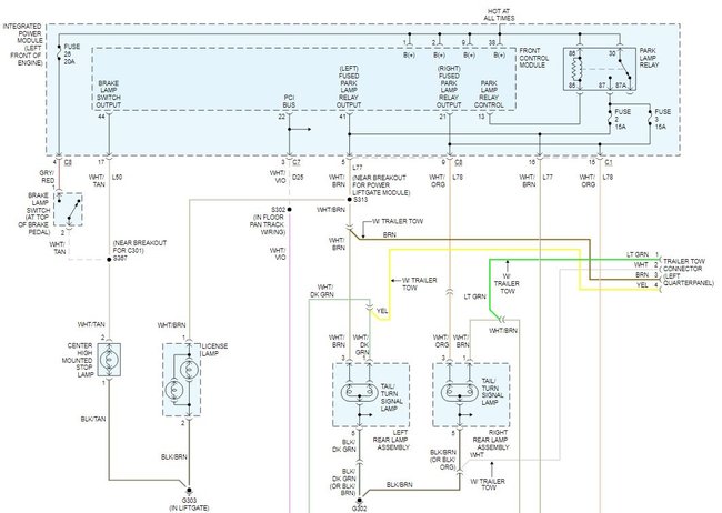

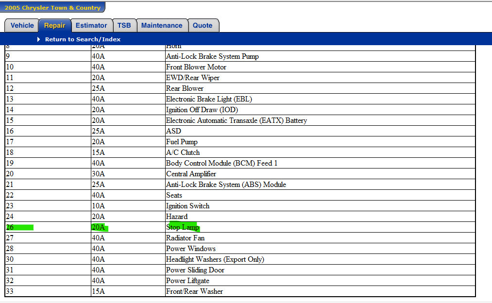

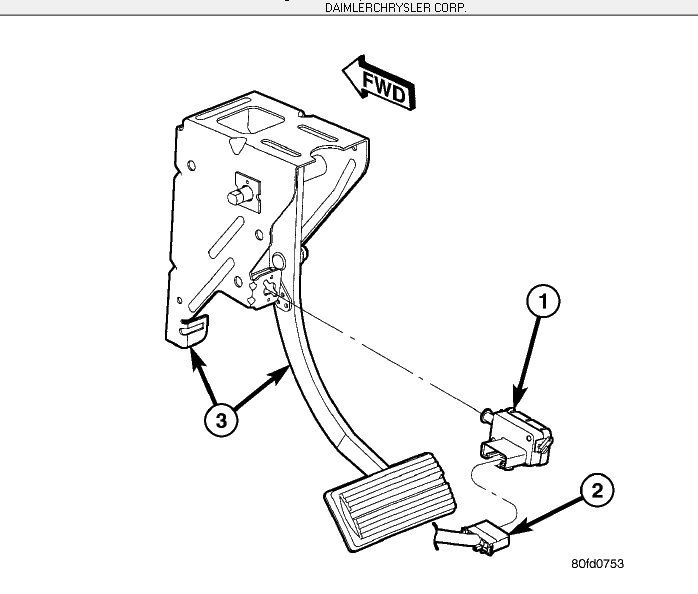

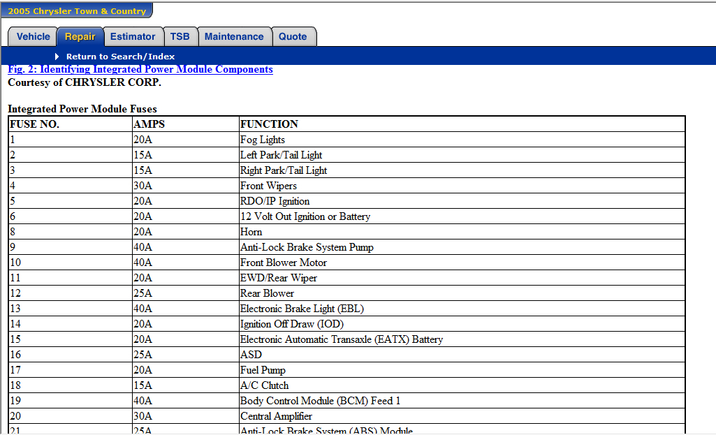

My rear brake lights are out and I just need to know where exactly the fuse needs to go in my fuse panel. and what other fuses might need to be replaced in order to make the rear brake lights work again? Please help..

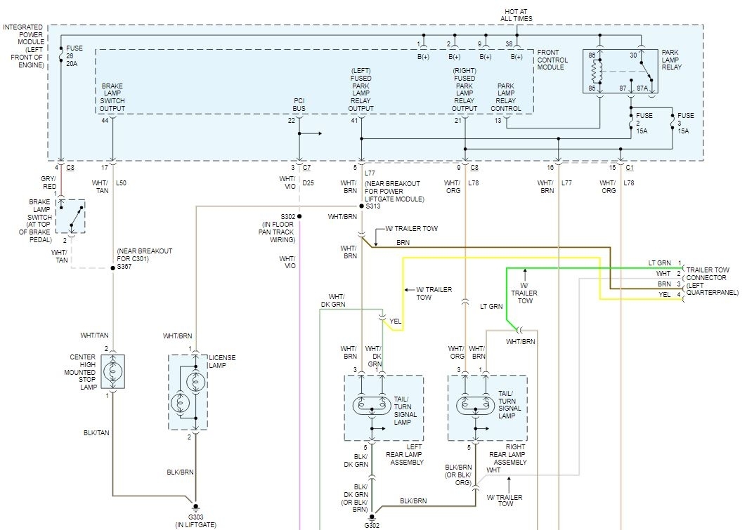

I'm sorry to say there is no fuse for just the rear tail lights. The only lighting fuses power the front and rear lights and are split so that if one was blown you would have either the right side or left side lights working if both were bad you would have no tail lights, front marker lights, or license plate lights.
If it's the brake lights does the upper brake light work?

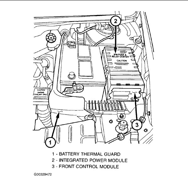

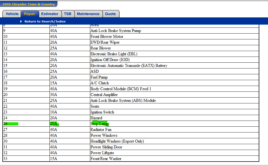

For the brake lights there is a fuse #26 a 20 amp one in the totally integrated power module under the hood.
So first we need to be sure which lights are the issue as there are two different circuits involved and two different control modules. So please verify all lights that are not working.

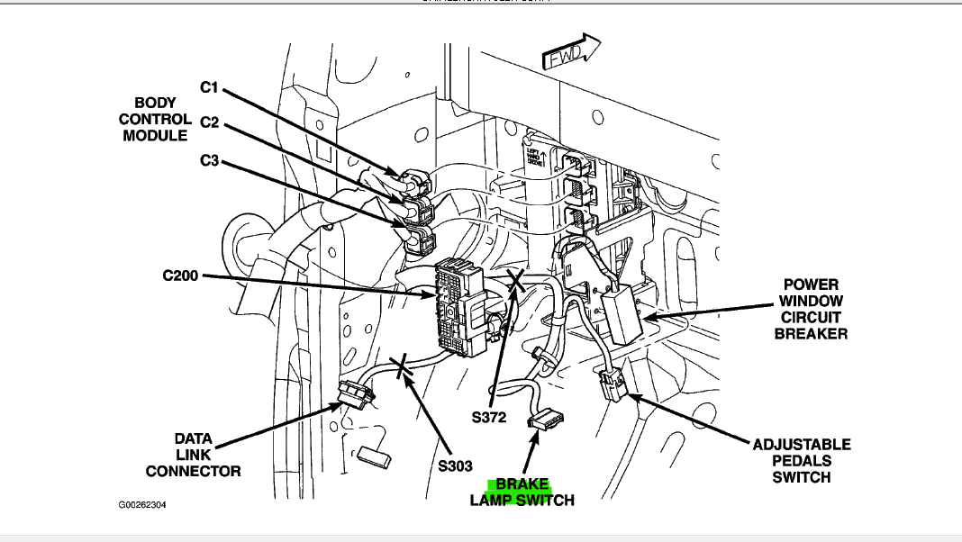

Problem can be from a fuse or the brake light switch that is located rear of the brake pedal.
check the diagrams below figure 1,2,3 for fuse box location and the fuse number, which is number 26 20A .

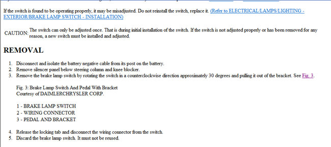

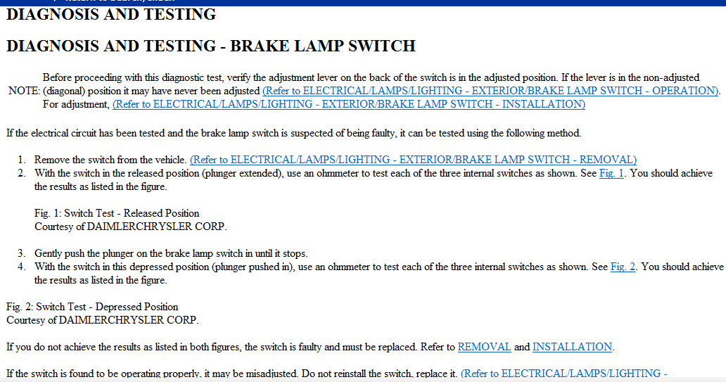

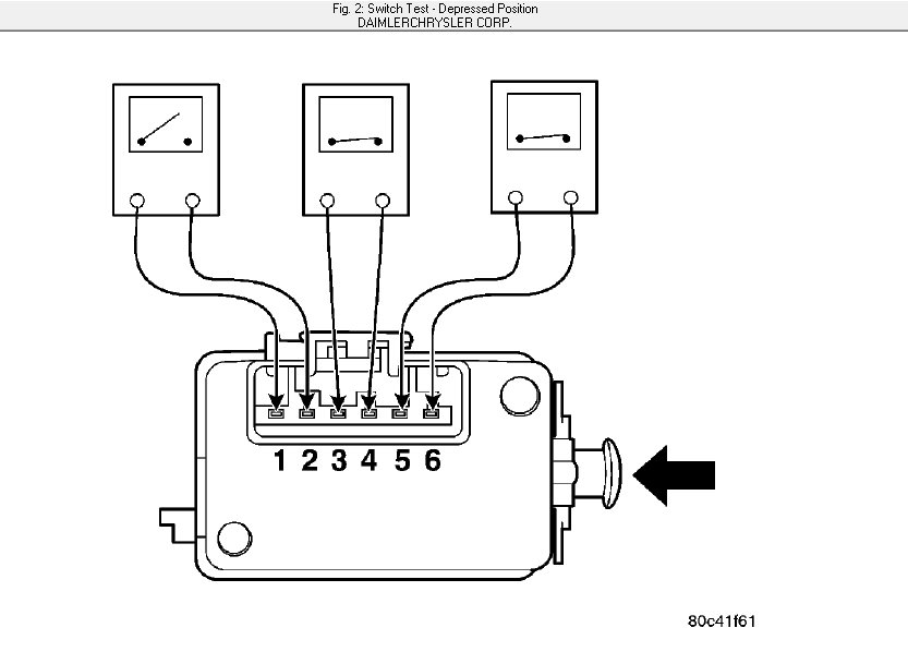

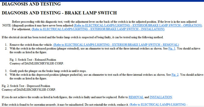

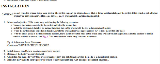

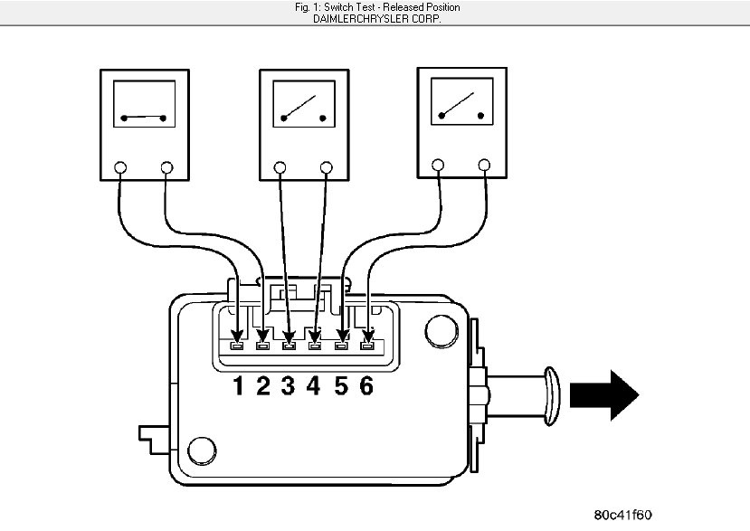

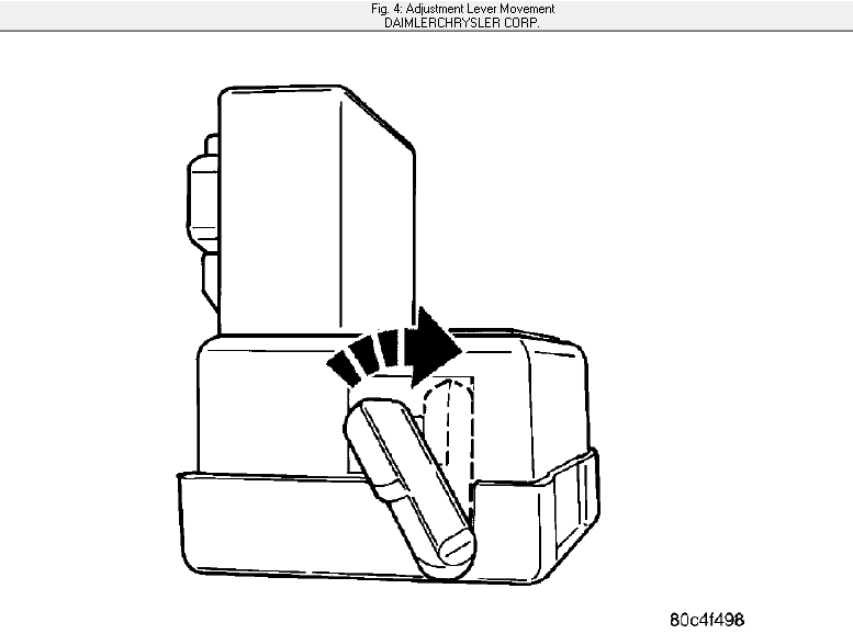

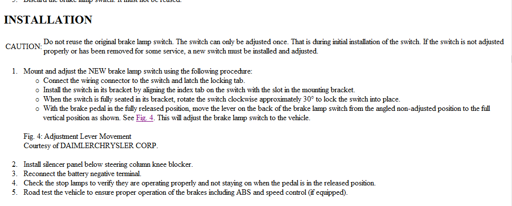

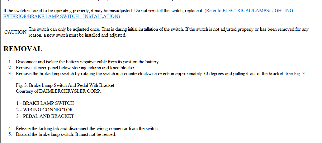

Checking the brake switch location check the figures 4 and 5 below, check the procedure how to check the brake switch at release and pressed positions by using ohmmeter, check pictures below figure 6 and 7.
check the procedure below figure 9,10,11 how to test the switch and the removal and installation.
