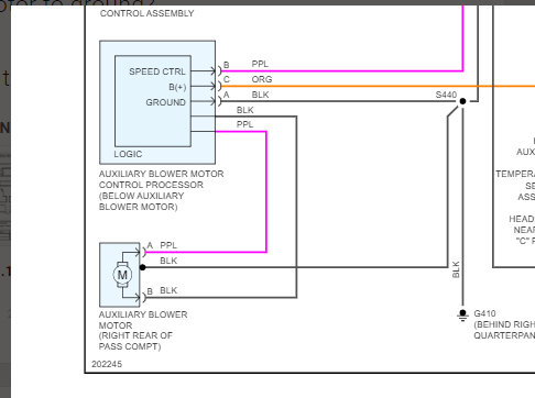

The blower is fine, I took it out and tested at the battery. I replaced the blower motor module, and it still does not work. I'm stumped.

Just to be sure you replaced the aux blower motor control module and not the one in the front.
If you did, then we need to check two more things.
First, we need to check the power at the blower motor and confirm you are getting 12-volts when it is on high.
Then we need to check the grounds by using the 12-volt source and then both grounds and your meter should read 12-volts.
If it does, then we need to move to the control processor. We need to check and find out if there are 12-volts on the B+ circuit and then the speed control should change as you increase the speed.
Lastly, we need to check this ground the same as the other.
Please run through this and let us know what you find and then we can go from there to find out the next steps.

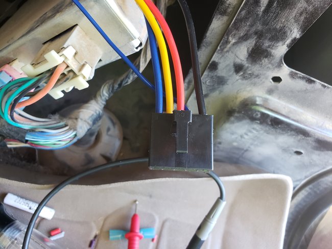

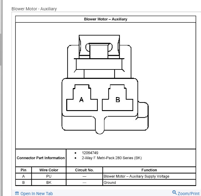

Just to be sure, you are jumping a wire from the motor to ground and the motor runs.
Can you confirm what terminal you are jumping this wire from on the motor to ground?
I am attaching the blower motor connector below. Thanks
Jun 13, 2022 at 7:58 AM
ELMERMAXX
  • 20 POSTS
Yes, I used the black wire B on the pic.

Sorry I had issues connecting to the site. Yes, I jumpered the B wire in the connector, actually it's an orange wire in my truck but the same location. And the blower motor ran.
Jun 14, 2022 at 3:48 AM
So, if you provided ground and the motor ran then the module is not grounding the motor. That means that the module would be the issue.
Is that what you replaced?
Jun 14, 2022 at 4:12 AM

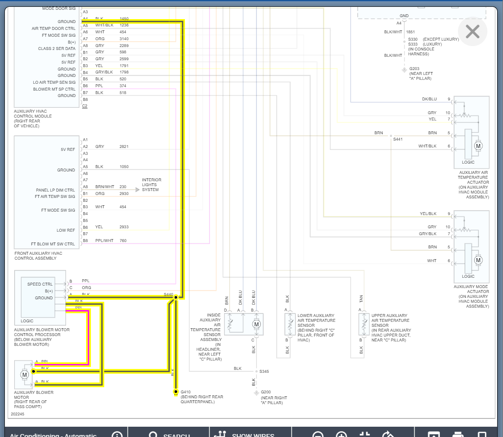

Okay. That keeps us focused on the ground from the module to the motor. So, the black wire that is connecting the motor back to the module should show ground as all the other readings are correct.
So, this means we need to ohm out the wire itself.
Take a look at the diagram below. Disconnect both connectors (module and motor) and we need to measure the resistance of the wire itself from connector to connector.
You put your meter on ohms and then just touch one terminal to each end of this wire and tell me what the resistance is.

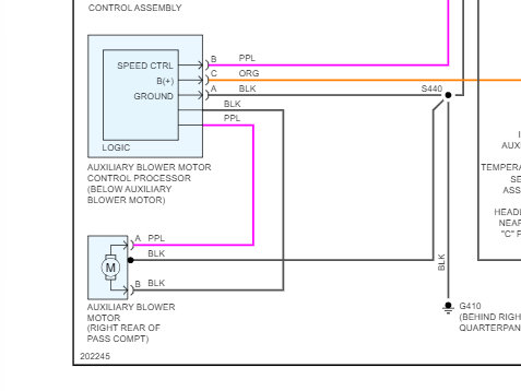

Here's the current module wiring.
Jun 16, 2022 at 6:08 AM

E-M(+) pillar ground>E=14.84v, this must be 0 volts. Can you run a ground wire to this one first to see if the system starts working?

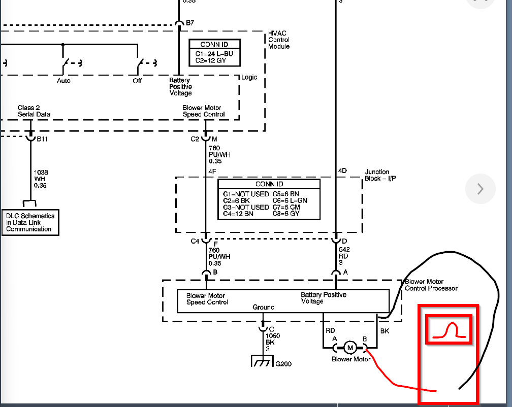

can you put the wire to ground to see what happens?
Jun 18, 2022 at 1:50 AM
ELMERMAXX
  • 20 POSTS

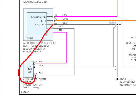

I just went out and ran wire from The A pillar to the blk B wire on the motor. It runs but very hot. Am I doing something wrong? So, it's my understanding that the ground into the module comes from the A pillar and then feeds the other ground D(M-) that runs to the motor. Or does it do something else entirely?
Jun 18, 2022 at 5:20 AM

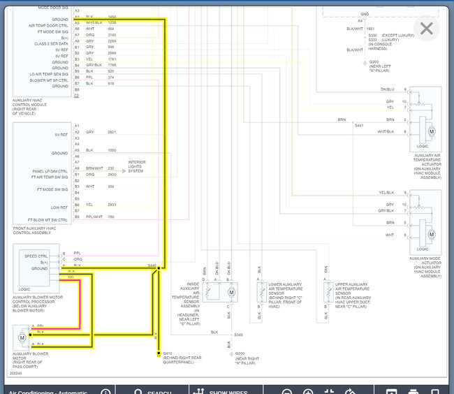

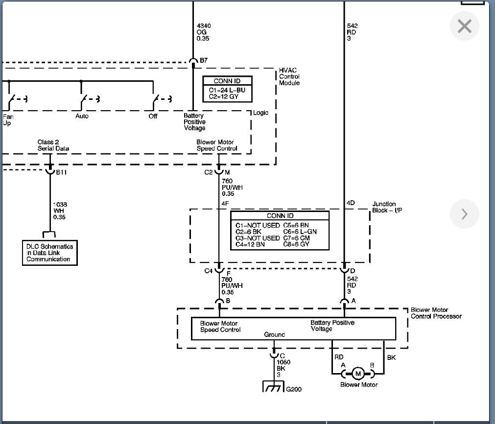

Okay. I think we are missing this. The blower motor processor powers and grounds the blower motor and the processor have its own separate ground. The fact that you are grounding something and it is getting hot means you have resistance in the circuit.
So, let's use the OEM wiring diagram as it lays it out a little better and check this all with the blower on high. I think this will be a recap, but I am worried we got onto the wrong path.
Use the diagrams attached to this post not the previous ones.
1) You should have battery voltage on pin A of the blower motor processor.
2) Then when checking voltage from pin A to pin C you should have battery voltage.
3) Then when checking pin B to Pin C your voltage should vary depending on the fan speed setting. I think the lower the voltage the higher the speed. 3 volts should be high but check that by monitoring this voltage and change the fan speed. The slower the speed, the higher the voltage should get.
Lastly, are the motor wires themselves.
4) Check the red wire to pin c of the processor and when on high, it should be 12 volts.
5) Then check the ground back to the motor by checking voltage from pin A to B of the motor connector. You can back probe this across the motor.
I suspect number 5 is the issue. So, we need to check the resistance (ohms) from the motor back to the processor. Basically, you are checking just the wire to see if it is a complete intact wire. So, unhook the connectors at the motor and processor and check from terminal to terminal of the black wire.
I think you said this is not doing anything even when you put it on the tone. If there is no tone, then that means there is no continuity.
However, your meter should read OL which means out of limit or that is an open circuit.
Can you set this up and then send a picture or quick video of the meter?
If this is the case, then that will explain why when you ground this wire, the motor runs. It is because the wire that the motor uses when you are not applying your own ground is open or has high resistance. So, the circuit is not complete.
Hopefully, this makes sense.

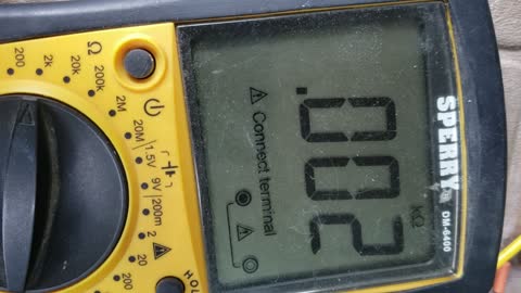

The video was testing a piece of wire to test meter function the actual test there was no change.
Jun 18, 2022 at 9:58 AM

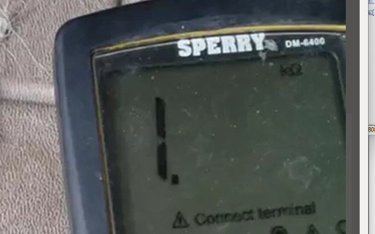

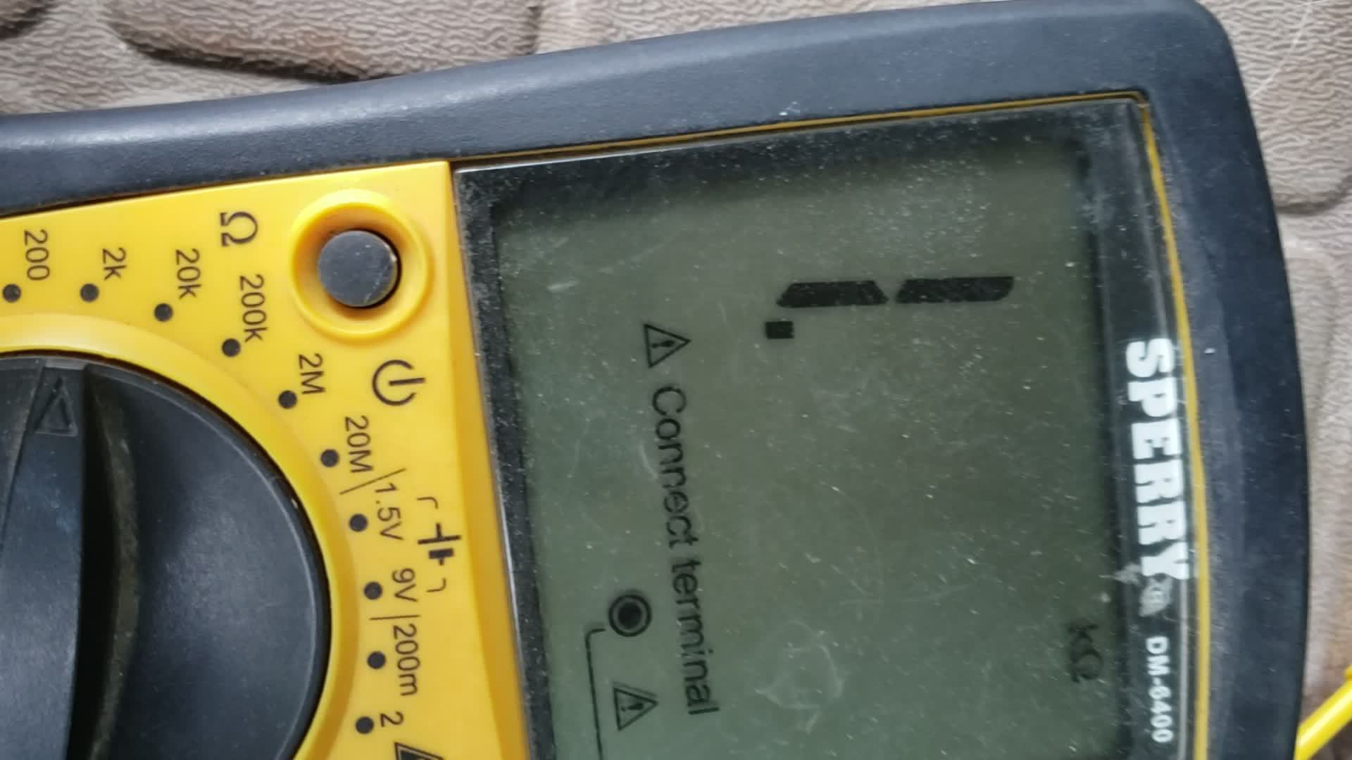

Okay. So, on number 4 when you measured voltage across the motor you had 0 volts.
Let's confirm this one more way. Measure the voltage from A on the motor to C on the module or a known good ground. If you have battery voltage when on high, then that confirms you have no ground from B on the motor back to the module.
Which means I want to clarify when you say there was no change when you checked the ohms on the actual wire.
Does that mean it was the same (no change) as the test wire? The test wire read .001 kohms. That means it was one tenth of an ohm which is perfect amount of resistance on a wire. If that is what this wire on the vehicle read then that is ok.
If your meter reads this shown below when checking this wire from the motor to the module, then that means it is an open circuit and you have a broken wire.

I checked for voltage while fan was on high between A on the motor and a good ground and there was14.45 volts.
Yes, there was no reading from the ohms test between A on the module and B on the motor connection.
Any idea as to where the broken wire might be located at?
Jun 19, 2022 at 2:48 AM
Unfortunately, that I cannot tell you. The best bet is to cut the wire at both ends and just wire it into a new one of your own.
