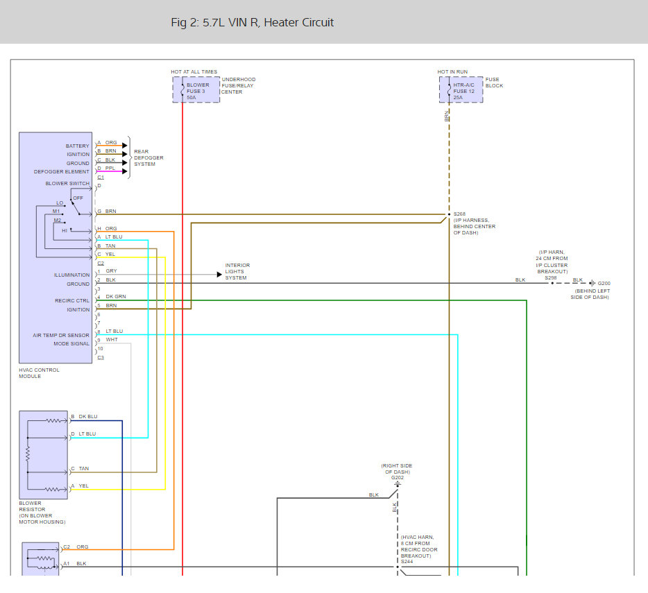

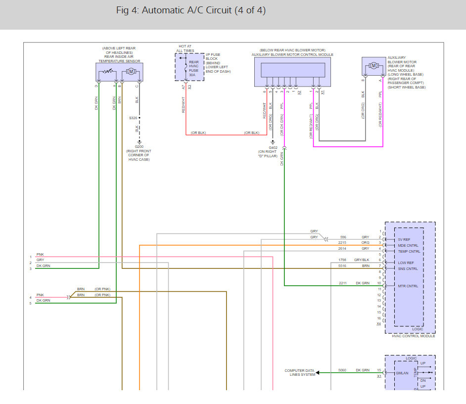

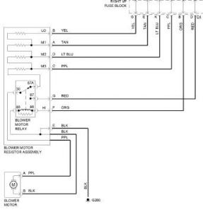

The front Blower fan will not work for air conditioning or heater. The rear blower fan works fine. The fan does not work on auto setting or when trying to increase fan speed manually. The indicator lights indicate the fan speed is increasing but it will not kick on. I could not find the location of a fuse or relay for the blower fan in the owners manual. Any ideas?
Oct 2, 2009 at 6:22 PM
  • 75,992 POSTS

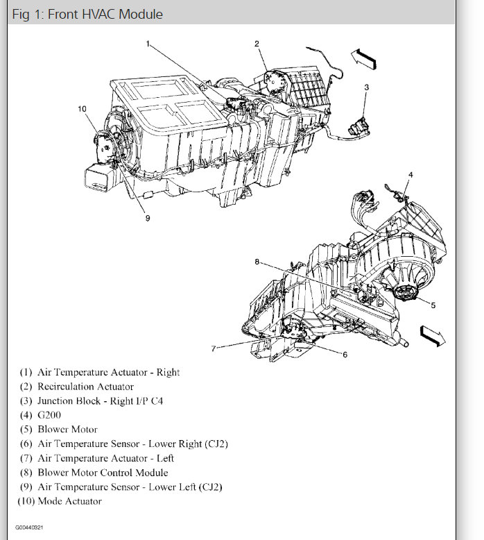

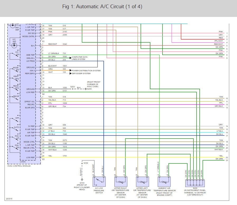

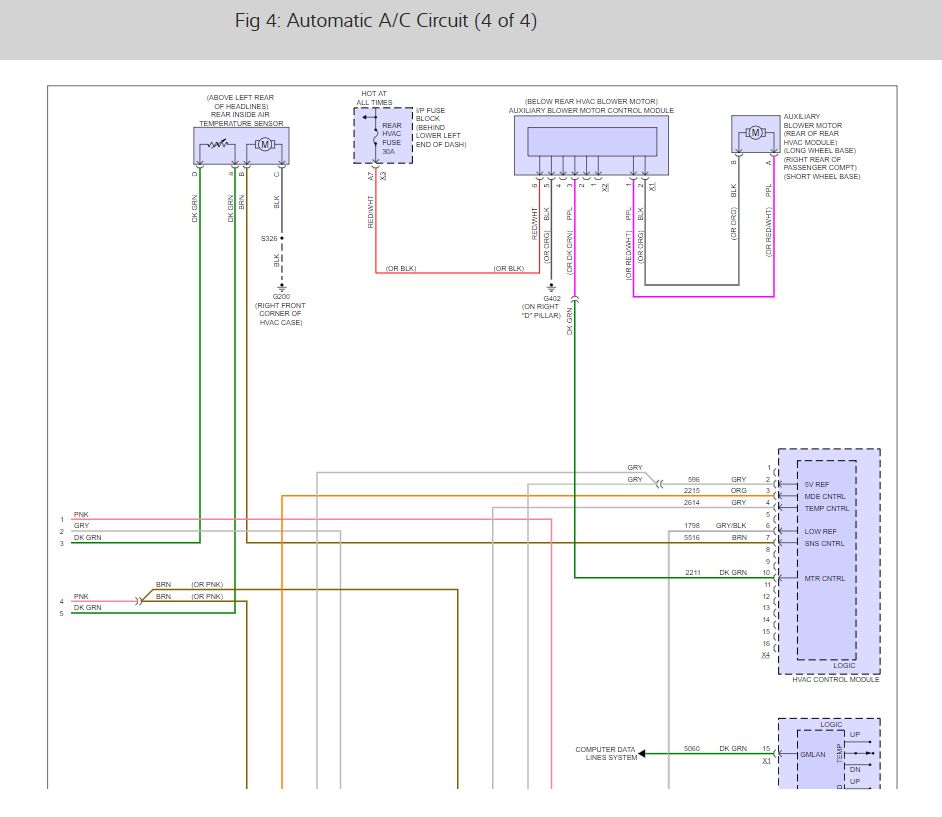

Check and test the blower motor control module in bottom center of HVAC modules. Here is a guide to help you
https://www.2carpros.com/articles/blower-fan-motor-works-on-high-speed-only

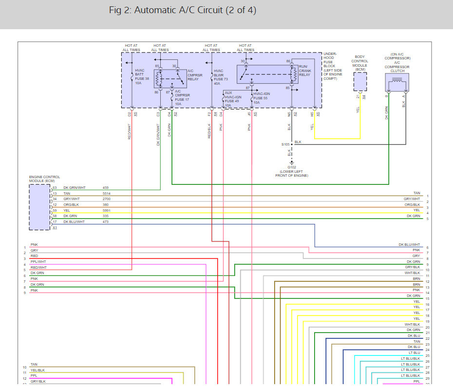

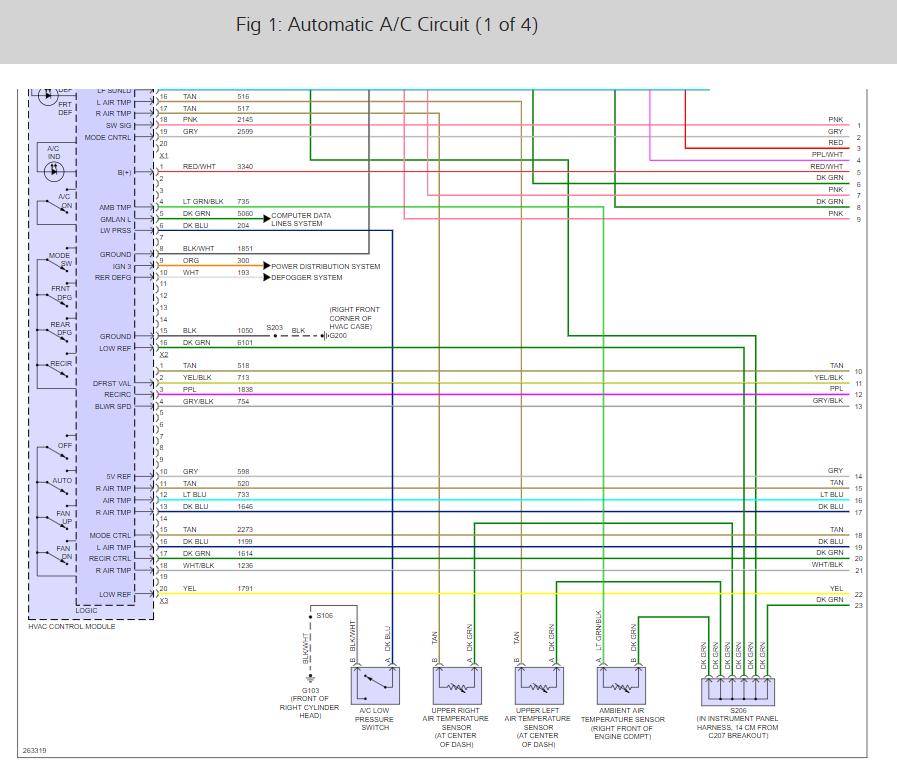

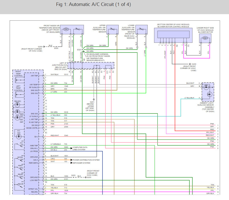

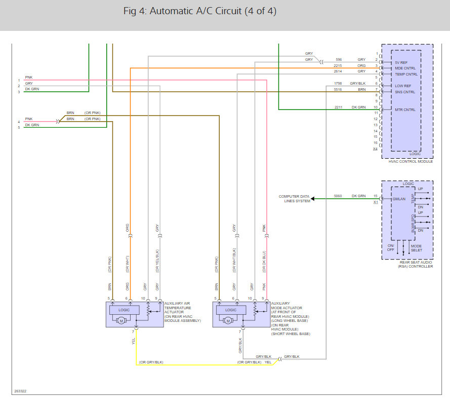

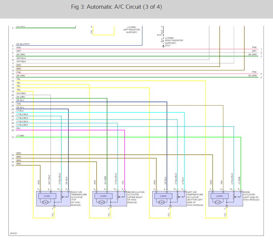

Here are the AC and heater wiring diagrams so you can see how the system works
Check out the diagrams (Below). Please let us know what you find. We are interested to see what it is.
Oct 2, 2009 at 6:30 PM
YUKON DAN

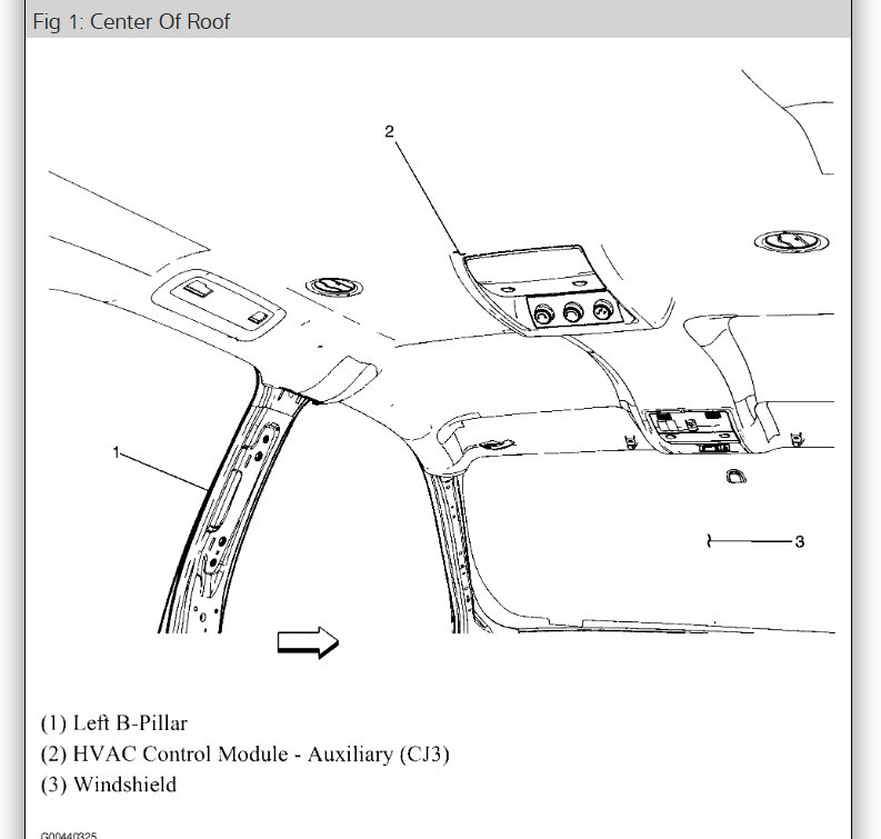

Where is the HVAC modules located? Engine compartment? Behind dash?
Oct 2, 2009 at 6:37 PM
  • 75,992 POSTS
There are two modules here are the locations below.
Oct 2, 2009 at 6:46 PM
YUKON DAN

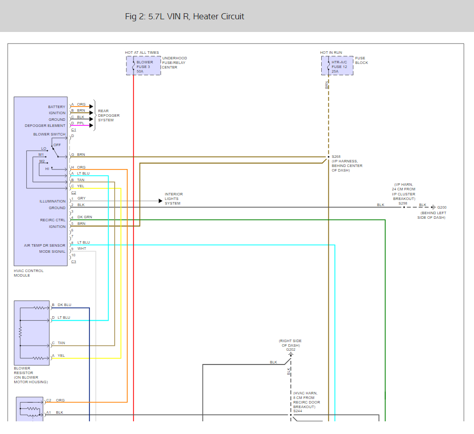

Checked module and it had 12 volts on the input but only 1.2 volts on the output to the motor. The module also became warm or hot to the touch. I purchased a new module and plugged it in but the blower still does not work. Apparently the modudle was not bad so where should I go from here?
Oct 5, 2009 at 10:48 AM
  • 75,992 POSTS
The blower motor ground need to be checked. Ust eh wiring diagrams above.
Oct 5, 2009 at 3:54 PM
YUKON DAN
It was the ground that was loose I got it fixed thank you!

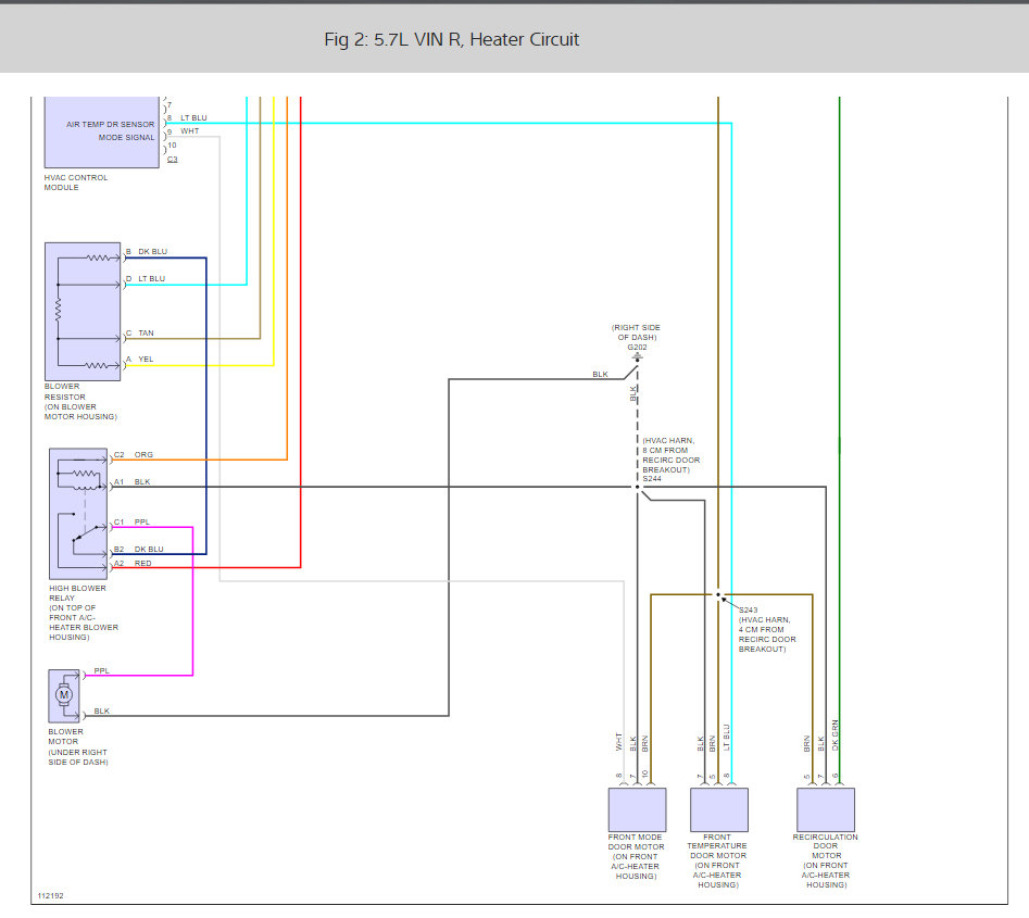

Issue: Drove the truck to destination and blower worked fine when truck was shut off. Got in it to leave and turned on heat on but no blower. Blower does not run in any of the four positions of the Control Switch. I have checked fuses but all are good. I originally suspected it was the blower motor but now am stumped!
Took the fan motor out and tested voltage. Here's what I saw which, to me, is strange.
There are four "knotches" on the rotary switch corresponding to fan speed ... right? Defined in the schematic as Lo, M1, M2 & Hi. Below is the voltage I see at each setting using a digital meter.
Off - Zero Volts
Low - 8v but climbs slowly to about 9v
M1 - 11.7v
M2 - 11.45v
Hi - Zero Volts
Note: When I turned to a lower setting from any higher setting the voltage drops dramatically and then slowly climbs back to the values from above.
I have now replaced both the Fan Motor, the High Blower Relay with no avail or change in voltages.
I removed the Blower Resistor and check for continuity across all of the various coils and the one resistor. All are good.
The only thing I have not replaced/tested is the HVAC Control Module which includes the rotary switch.

It sounds like you have lost power somewhere and it could be the controller but lets run some test to be sure.
Here are some guides to help you get the problem fixed.
and
Here are some wiring diagrams to help with the testing (Below)

Welcome to the forum, did you use a testlite to check fuse circuit? Not sure if that is readable? At the blower motor connector, purple wire is voltage and black wire is ground. You can use testlite to check for voltage.
