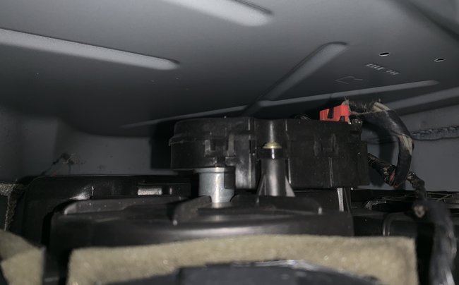

I have a problem where the A/C or heat only blows from the bottom vents in the rear and not the ceiling vents. I have changed the actuator on the front passenger side, so I am assuming that's the issue here. There appears to be two in the rear, one for the mode door and one for the blend. They are behind the blower. Any hints on how to change, and what the correct part numbers are for these units?

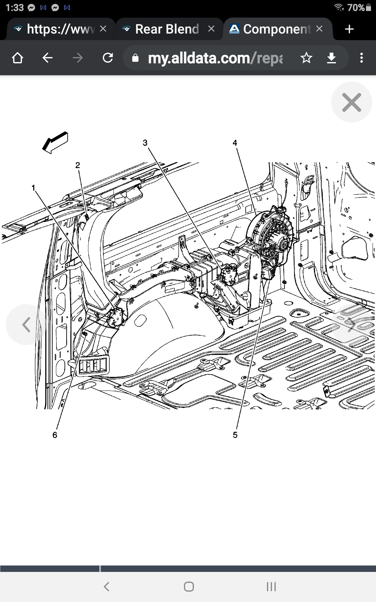

Yes there are two a mode actuator and a temperature actuator for the rear. They are easy to get at you just need to remove the right rear inside quarter panel cover. Then the entire unit is accessible. The one in the back between the rear tire and the motor is the air temperature actuator and the one toward the front of the rear wheel is the mode actuator. As for the part numbers that will be different depending on where you get your parts, ie the dealer, a parts store or online. Here is a diagram #1 is the mode amd #3 is the temperature.
Let me know if this help or if you need more info.

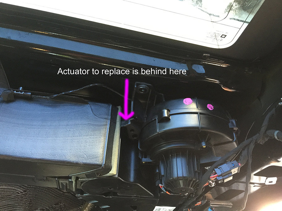

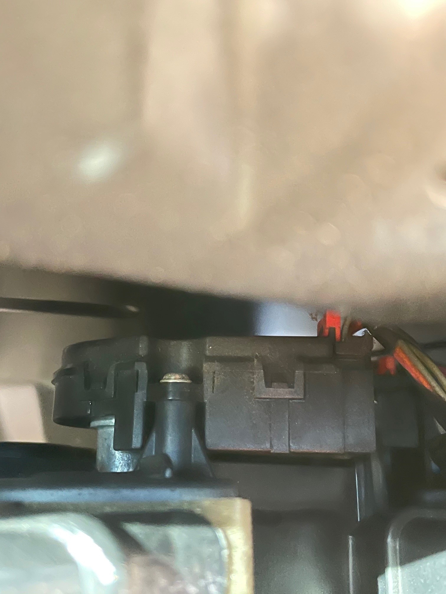

My unit is slightly different that the one pictured in your diagram. I have attached a pic of mine. The two actuators are behind the blower housing.
I read on another blog, that you have to evacuate the system, and remove everything to get to the actuators. Another blog stated to remove the two 7mm screws at the top holding the system in place, and you can tip the unit to get to them.
If I tip the unit, I think I can get to them. They seem to be held in place with one screw each. Any idea what kind of screw that is, phillips, star, etc?

I don't know it's probably Phillips or torqs though my data isn't showing it. I had two images also one for an extended rear and one for the short rear that's probably the difference. Either way your going to have to pull it away from the wall by taking out the bolts that hold the whole heater box out and pull it away. You can probably do it without disconnecting the fluid lines you just need to get it away enough that the plug can be undone.

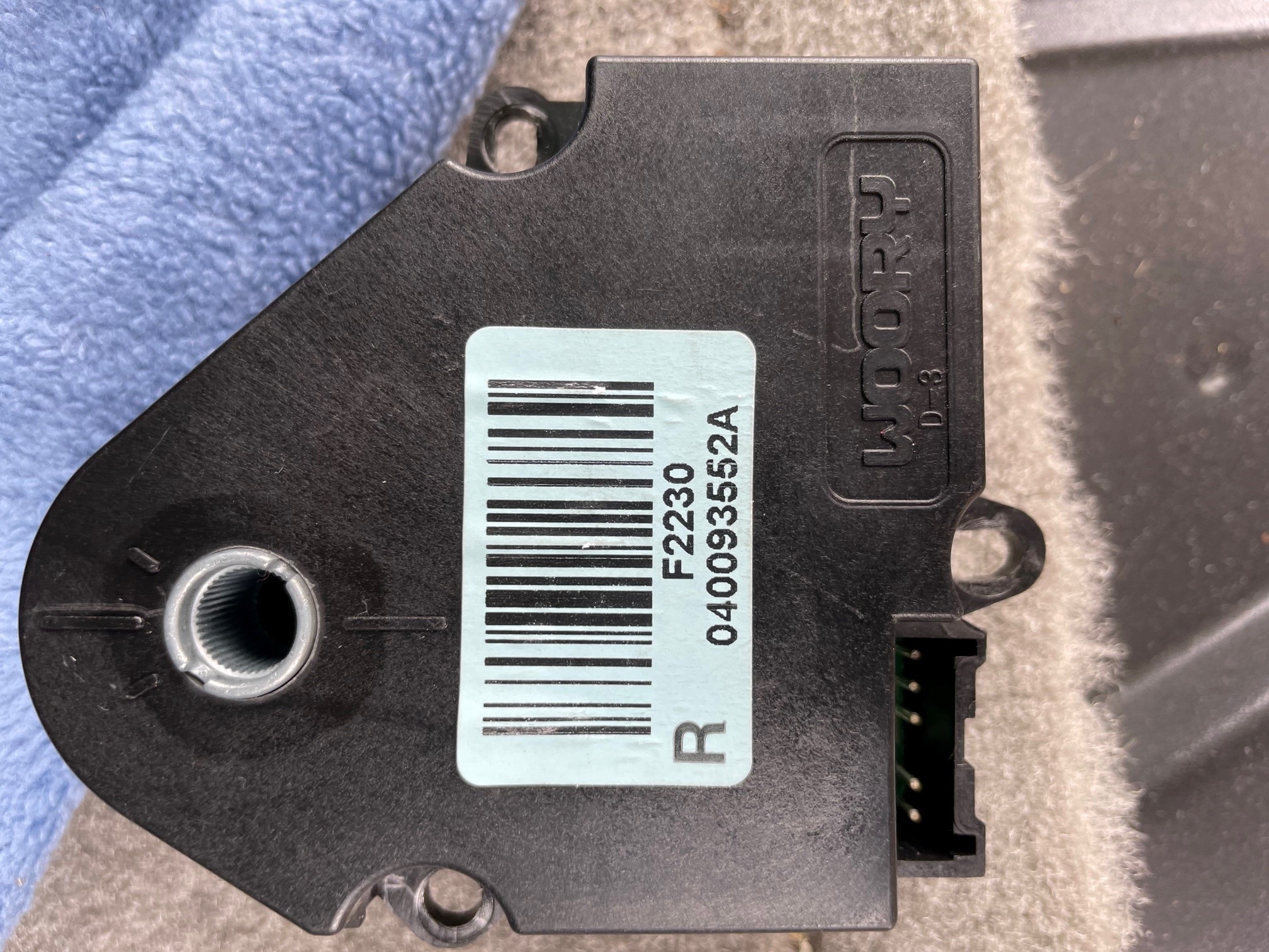

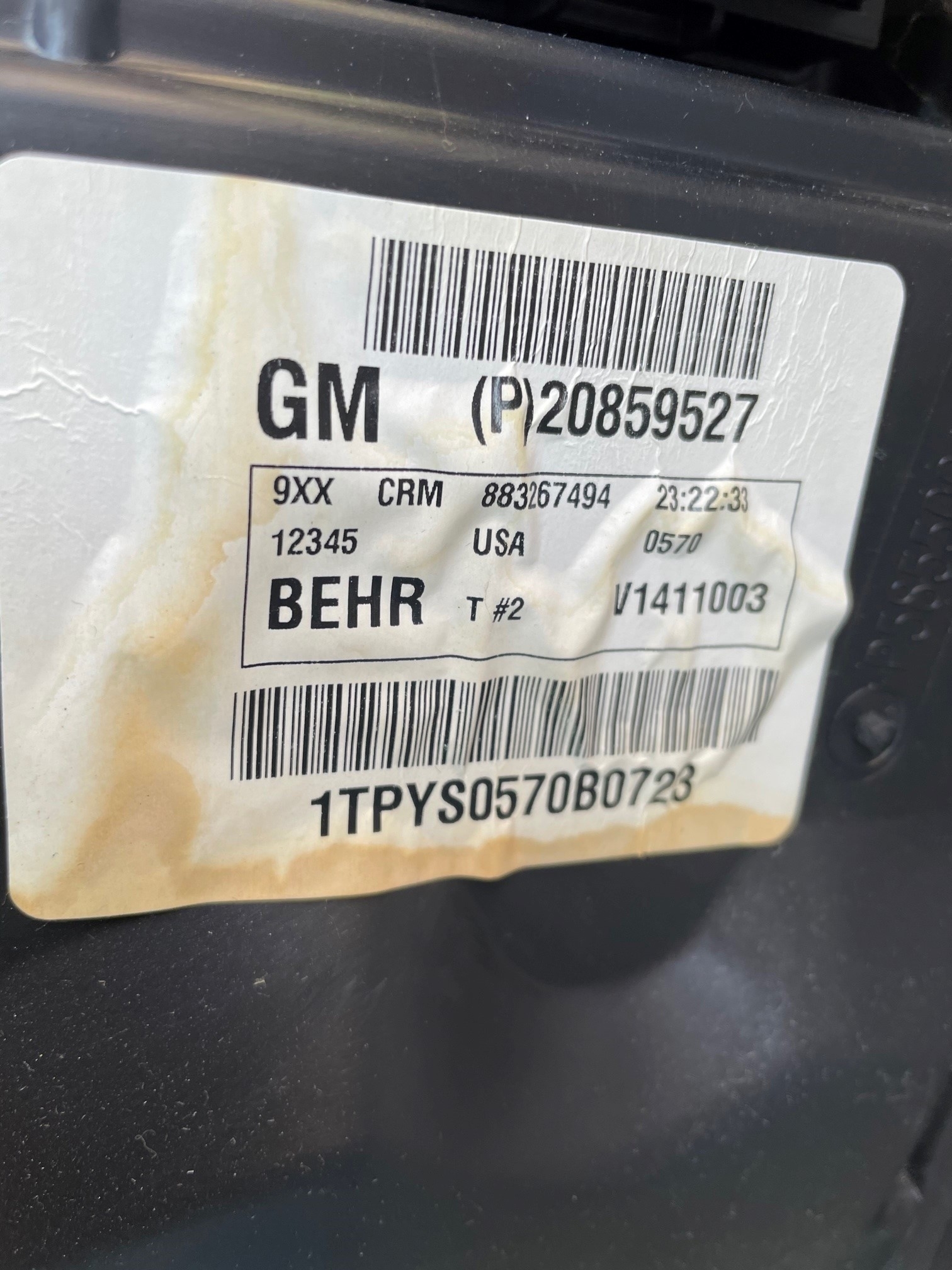

I pulled the two 7mm and got it away from the wall far enough to get the 3 screws in each out and get them removed. Not easy but doable. I am only having problems with one but replacing both since I'm in there, since it's so hard to get to. They both have the same numbers. Pic below.
