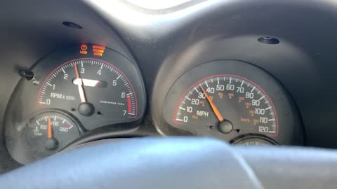

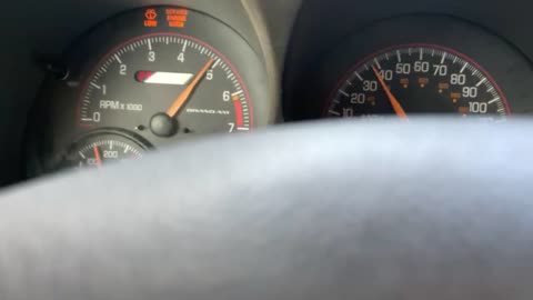

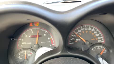

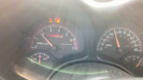

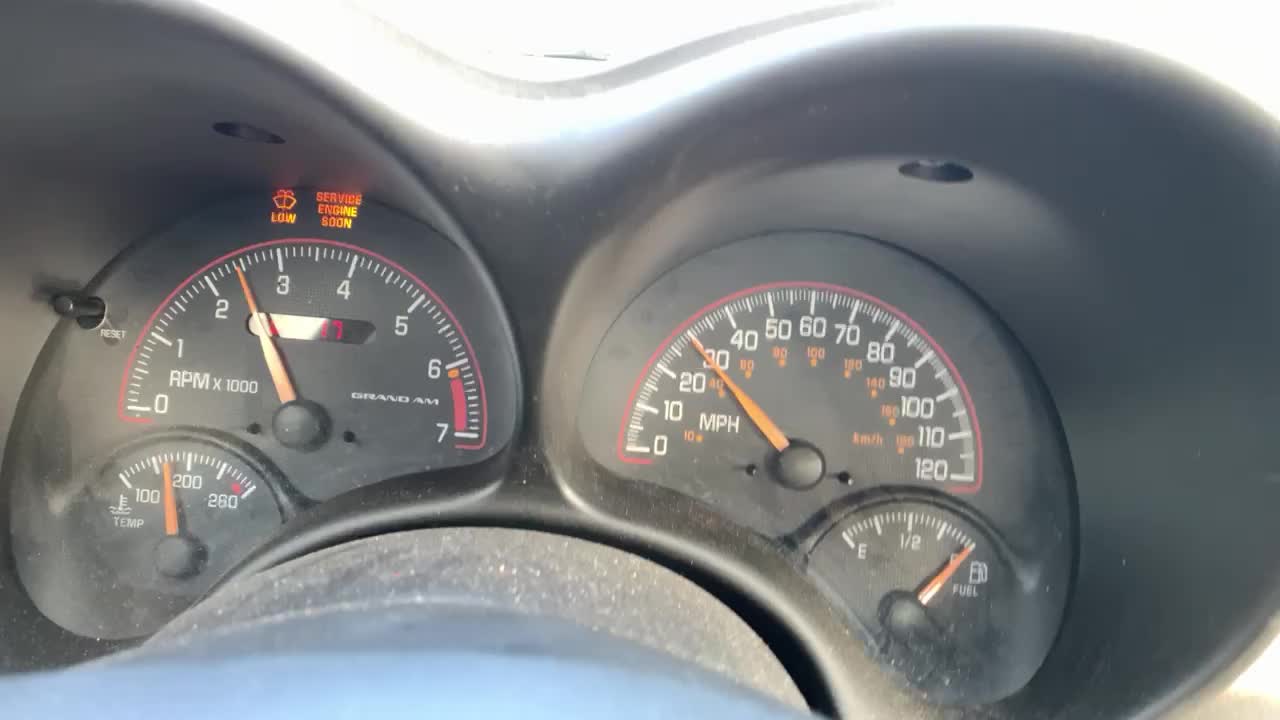

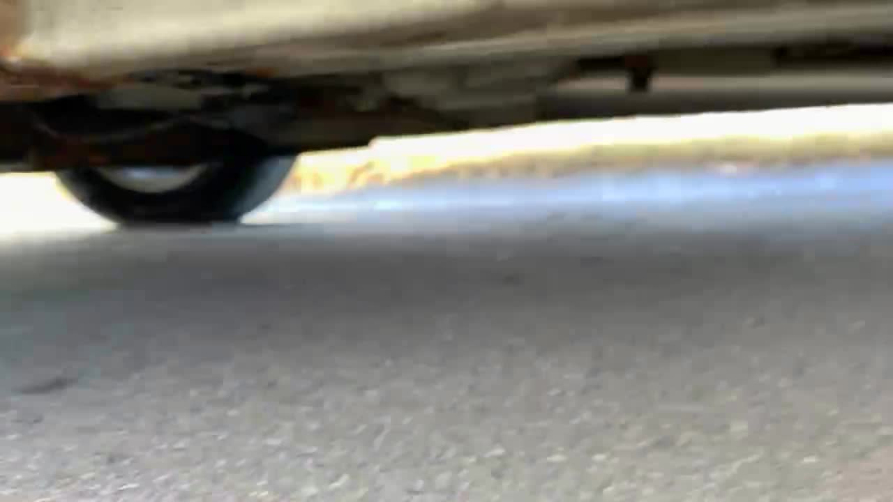

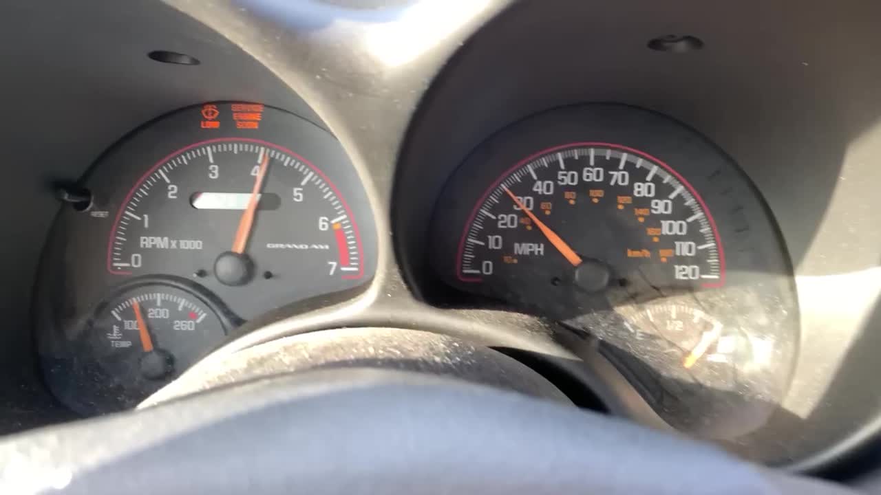

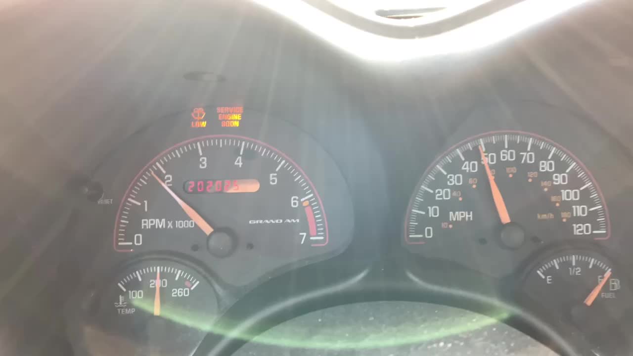

First video is cold start idle.
Second video is a quick acceleration while cold still.
Third is a quick acceleration while warm.
Fourth is normal driving.
It seems like the engine has the same problem when it’s cold now it happens when RPMs are high cold or warm, there it is though.

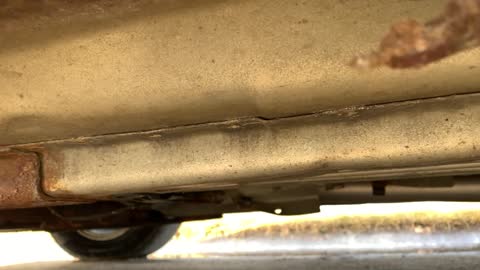

Forgot to mention the cats got stolen a long time ago and never fixed it. so, it’s basically strait piped and really loud which kind of helps when trying to hear engine noise!! I know part of the engine code is cats and I’m fixing it this summer, but it’s ran fine for a long time without cats.

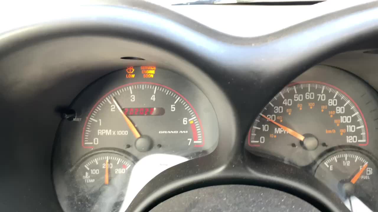

DAVIDO1001
  • 6 POSTS
I put wrong video for cold hard acceleration so here’s the right video.

I watched each of the videos. I noticed that the check engine light wouldn't flash until it was under a heavy load. When it flashes, that indicates the misfire is occurring. When it stays solid, there shouldn't be a misfire occurring.
Okay, the idea that the converters were stolen led me to ask what was done with the oxygen sensors. Also, when the light isn't flashing, do you still feel a misfire? Is the only code stored a P0304?
Let me know. Also, let me know if you feel the misfire when the check engine light is not flashing. One last question. If your scan tool has live data settings, check to see what the short-term fuel trims are and check the engine coolant temperature sensor signal as well. With the engine cold, the ECT signal should be very close to ambient temperature.
