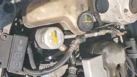

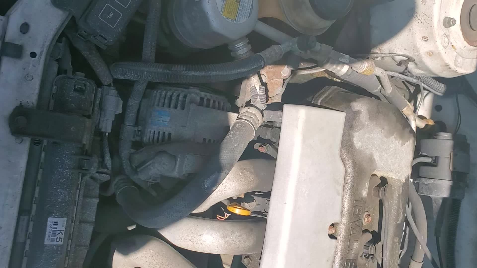

My car's front end (maybe under the hood) rattles pretty much all the time. It started a few weeks ago. It rattles idling, stopped, reversing, driving slow (when I can hear it), and all other times. The only time it doesn't rattle is when I turn the wheel to the left or right (doesn't matter). As soon as I let go of the wheel or the wheel is straight, the rattling starts again.

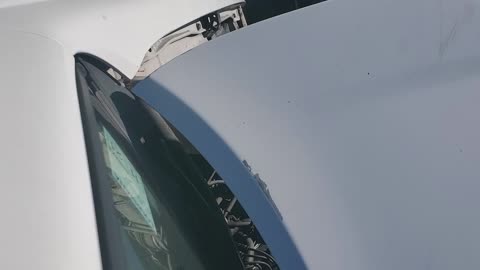

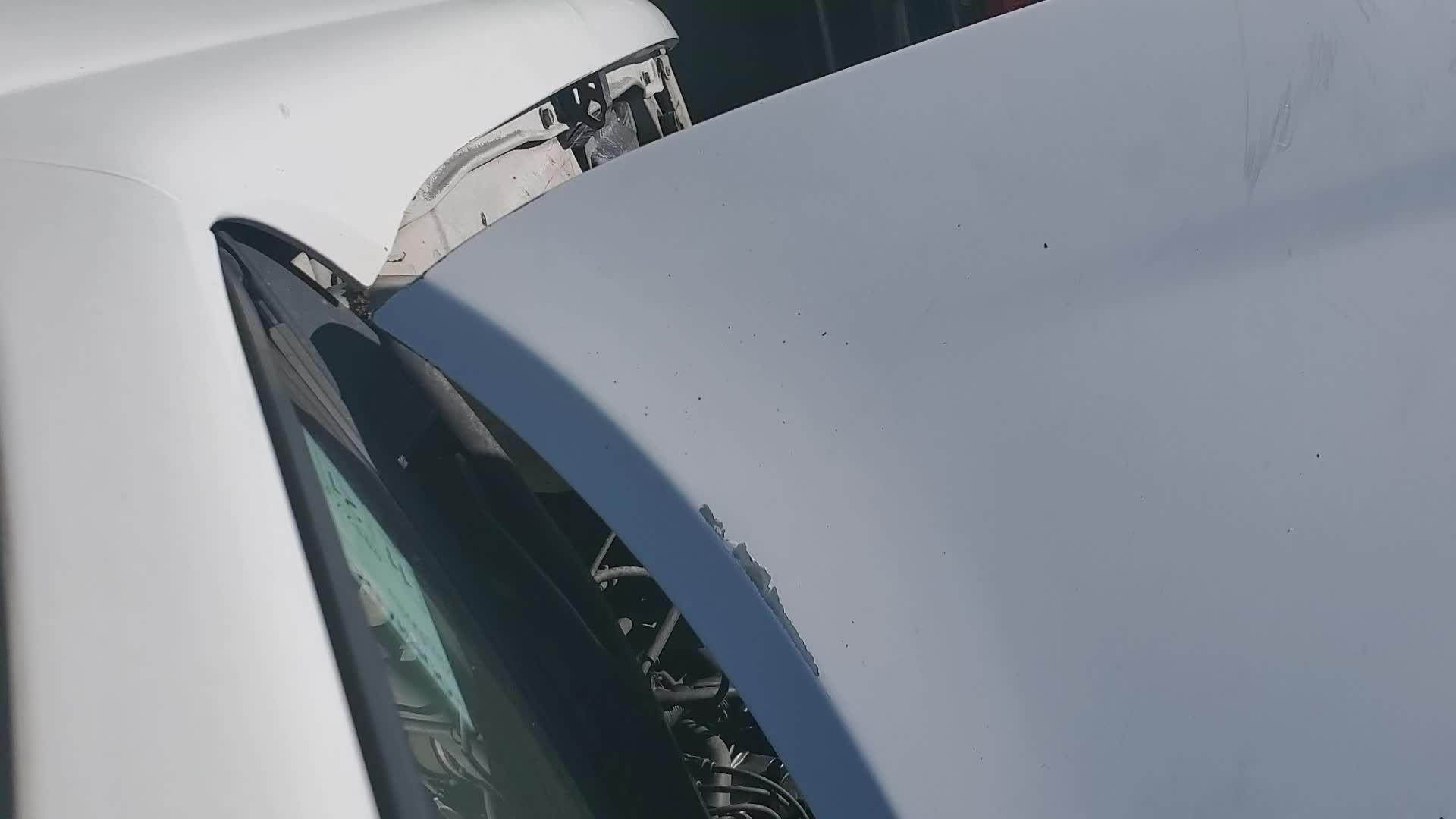

It sounds by the engine but it only stops when I turn the wheel so I don't know. Second video is when it stops when I turn the wheel.

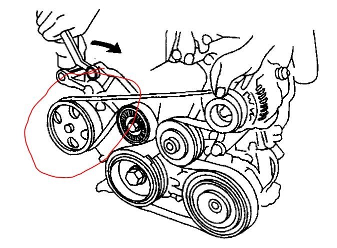

The first thing I would do is remove the belts and then start the motor and see if the noise is still there.
This could be the power steering pump making the noise. With the belt off, spin the pump and see if it makes any noise.

2. Remove the serpentine drive belt. Refer to Drive Belt Replacement in Engine.

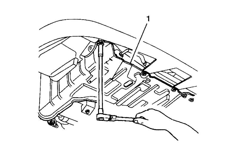

7. Remove the 6 bolts and the RH lower engine splash shield (1).

4. Install the RH lower engine splash shield (1). Secure with 6 bolts.
Tighten the 6 RH lower engine splash shield bolts to 10 Nm (89 inch lbs.).

9. Install the serpentine drive belt. Adjust the belt while installing. Refer to Drive Belt Replacement in Engine.
