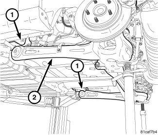

I am getting a rattling noise in my rear drivers side. The rattling will subside once I apply the brakes. I had it to my mechanic three times and all three times cannot find anything wrong with it. This last time my mechanic stated that it possibly could be the shock that is going bad. Any suggestions as to what it could be?
Dec 12, 2018 at 9:46 AM
  • 110,240 POSTS
Since it stops when you apply the brakes, either it is related to the brake itself or a worn busing in the rear axle assembly. When brakes are applied, directional pressure is placed on the bushings. If they checked the brakes, caliper, and caliper mount and everything is tight, Inspect the rear trailing arm busing. It is a metal component that attached the rear axle to the frame of the vehicle. See picture 1.

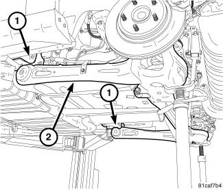

REAR AXLE TRAILING ARM BUSHING(S) - INSTALLATION
INSTALLATION

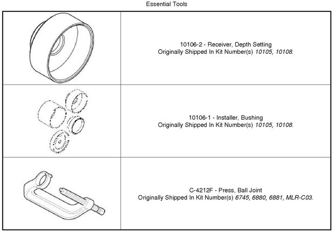

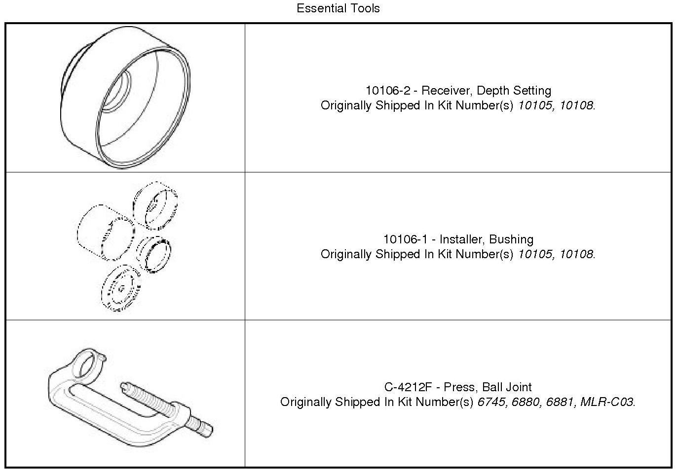

Special Tools:

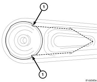

CAUTION: Bushing must be correctly positioned in axle trailing arm to insure proper operation. If bushing orientation is off by more than 10 degrees in either direction, NVH issues can occur.
1. Position NEW bushing in axle trailing arm bore from outboard side as shown. Line up notches (1) as shown to point directly toward rear of arm.

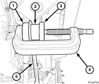

2. Assemble special tools Receiver (1) and Installer (3) on Press (4).
3. Place special tool assembly over bushing (2) and trailing arm (5) as shown. Use care not to rotate bushing when installing special tools. When properly installed, Press screw-drive will be toward outside of vehicle.
4. Using hand tools, slowly tighten Press (4) screw-drive, pressing bushing into trailing arm. Tighten Press screw-drive until integrated stop is met. Do not overtighten.

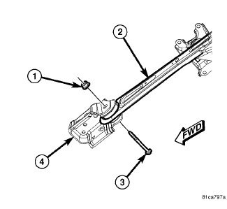

7. Reposition forward ends of axle trailing arms (2) downward into mounting brackets (1).

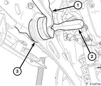

8. Due to track bar mounting, it will be easiest to locate right side pivot thru-bolt mounting hole first. Once located, insert a screwdriver or drift punch through hole in right forward mounting bracket and bushing to temporarily hold it in place.
9. On left side of vehicle, Insert thru-bolt (3) through mounting bracket (4) and bushing. Install nut (1) on end of thru-bolt. Do not tighten at this time.
10. On right side of vehicle, remove previously installer screwdriver or drift punch and Insert thru-bolt (3) through mounting bracket (4) and bushing. Install nut (1) on end of thru-bolt. Do not tighten at this time.

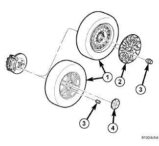

12. On each side of vehicle, install tire and wheel assembly (1) See: Wheels and Tires > Removal and Replacement > Tires And Wheels - Installation. Install and tighten wheel mounting nuts (3) to 135 Nm (100 ft. lbs.).

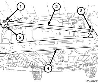

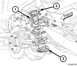

Two other things I would recommend checking are the tracking bar and coil spring itself for cracking. See picture 9 for tracking bar picture and 10 for coil spring.
_______________________________________
Check these things and let me know what you find or if you have other questions.
