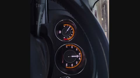

Here is the video.
Nov 28, 2023 at 5:23 PM
  • 54,840 POSTS
Thank you, the video helps. it sounds like you may have a tire coming apart internally. I would raise the front of the car and spin the front wheels to see if any irregularities are present or take it to a shop to have them check it. I would not drive the car anymore until we get this figured out.

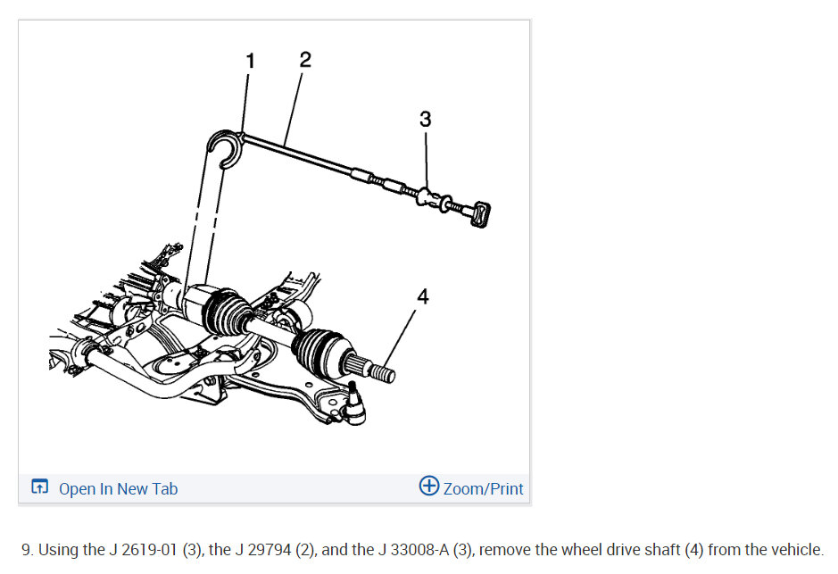

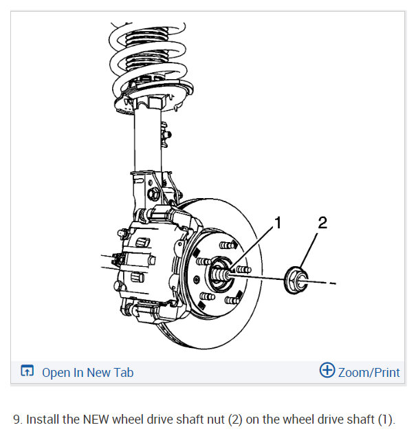

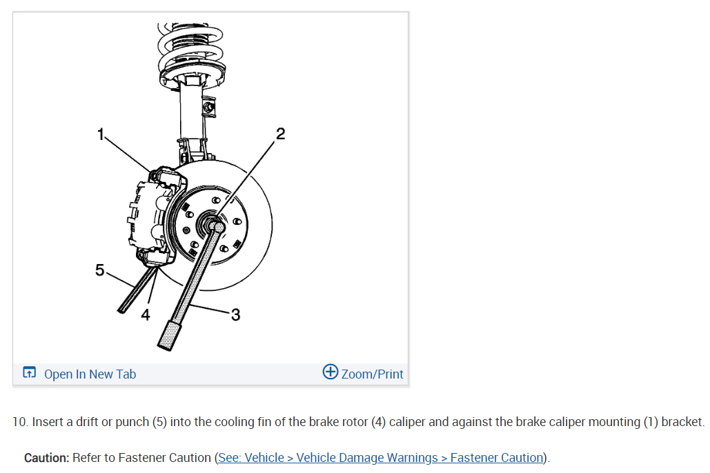

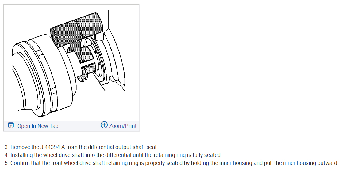

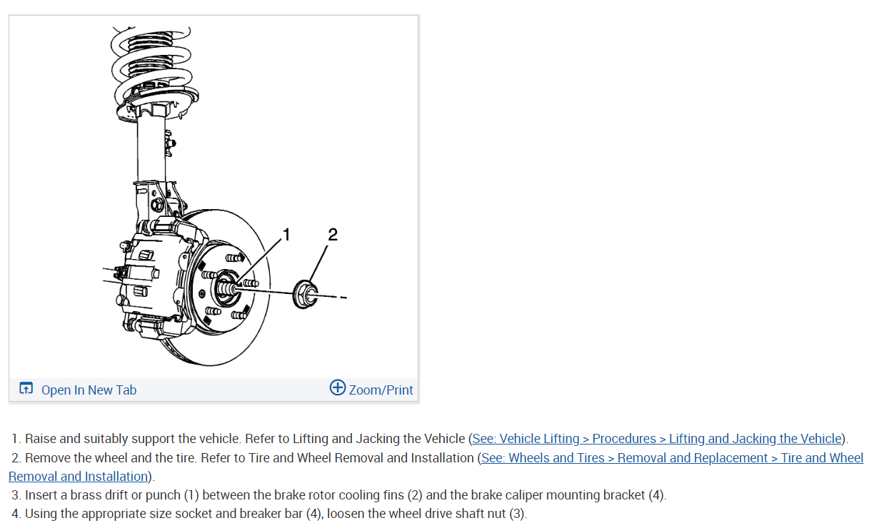

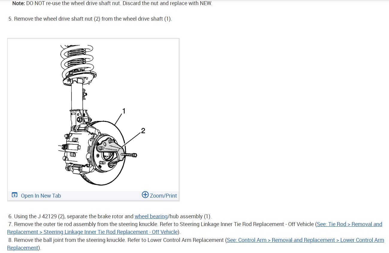

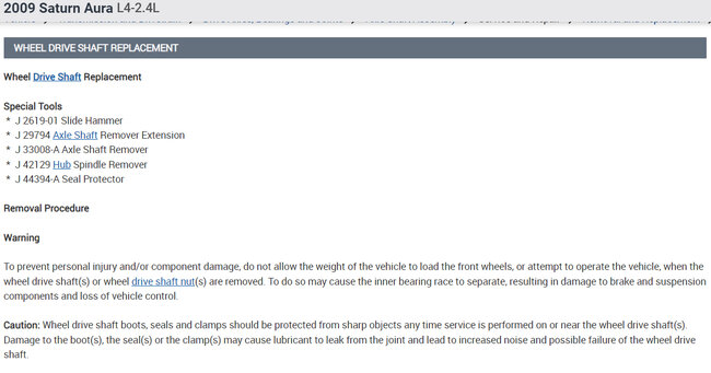

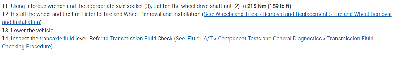

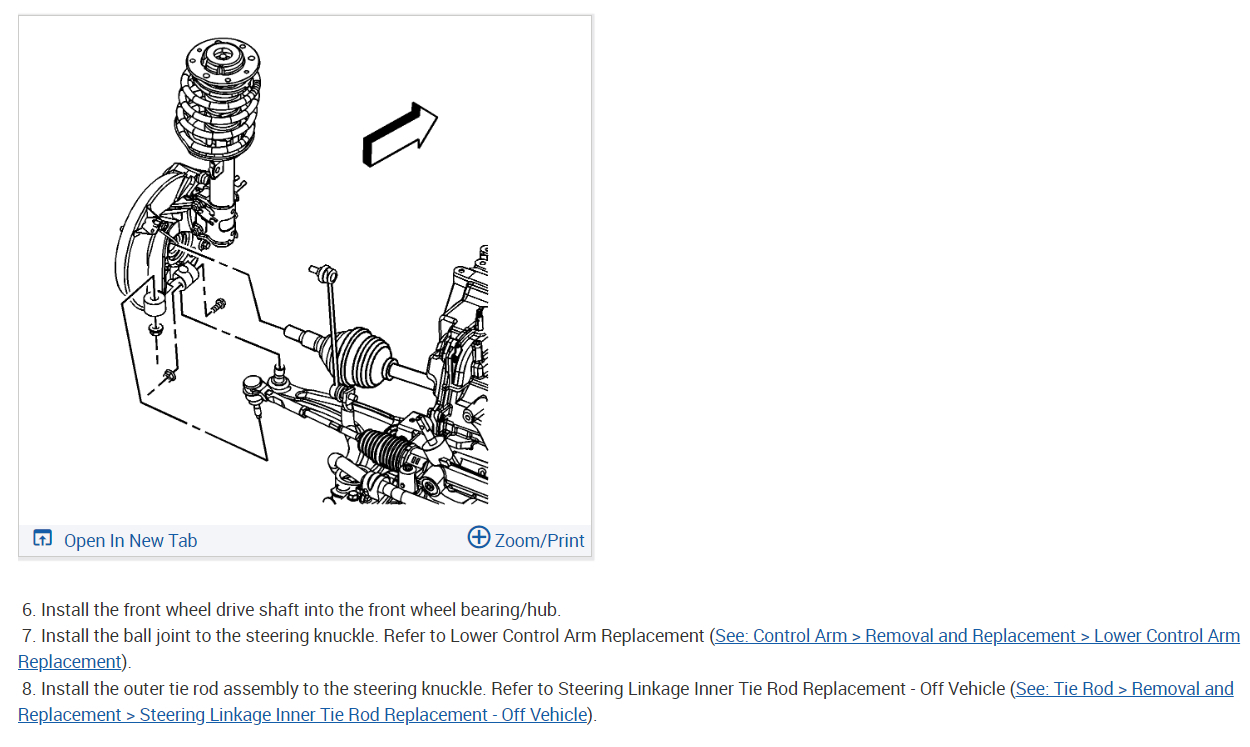

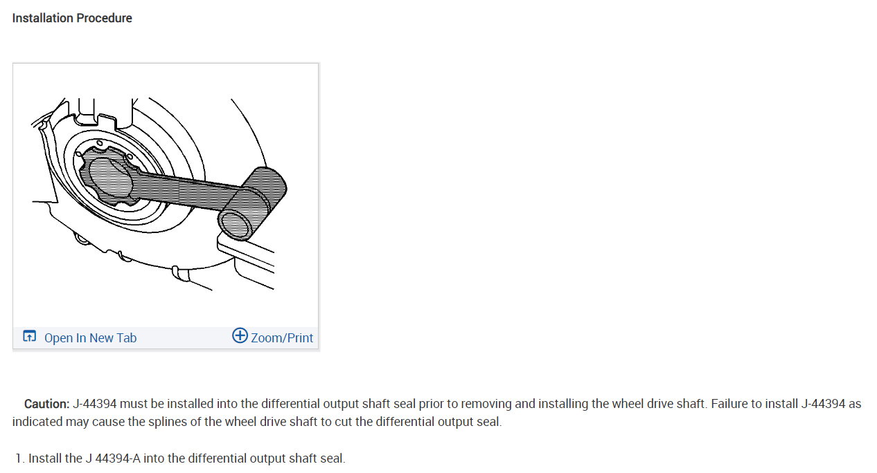

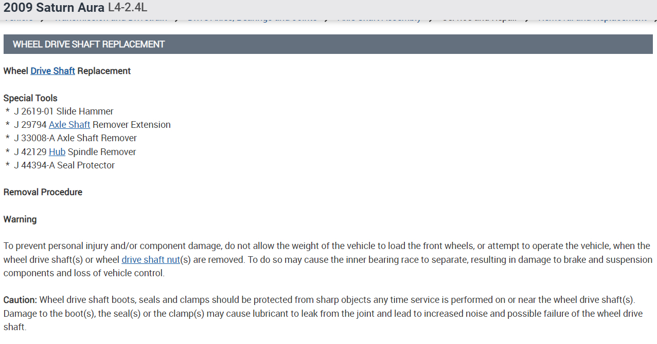

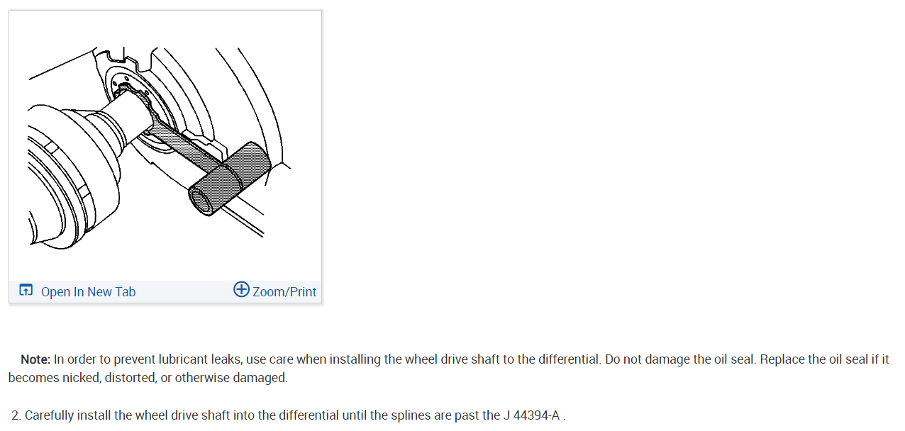

Okay, we need to put the car in the air and do an inspection. While in the air I would put the car in drive to watch of the drivetrain. It does sound like the CV axles are bad though, have they been replaced? Here are the instructions to let you know how to do the job or see what needs to be done when they are bad. Check out the images (below). Please let us know what happens.
