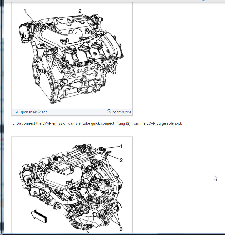

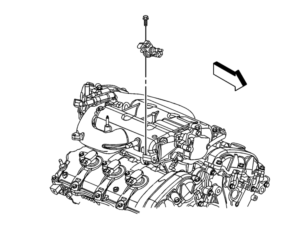

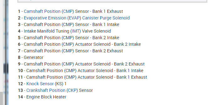

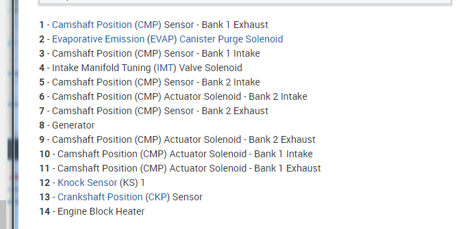

Good morning,

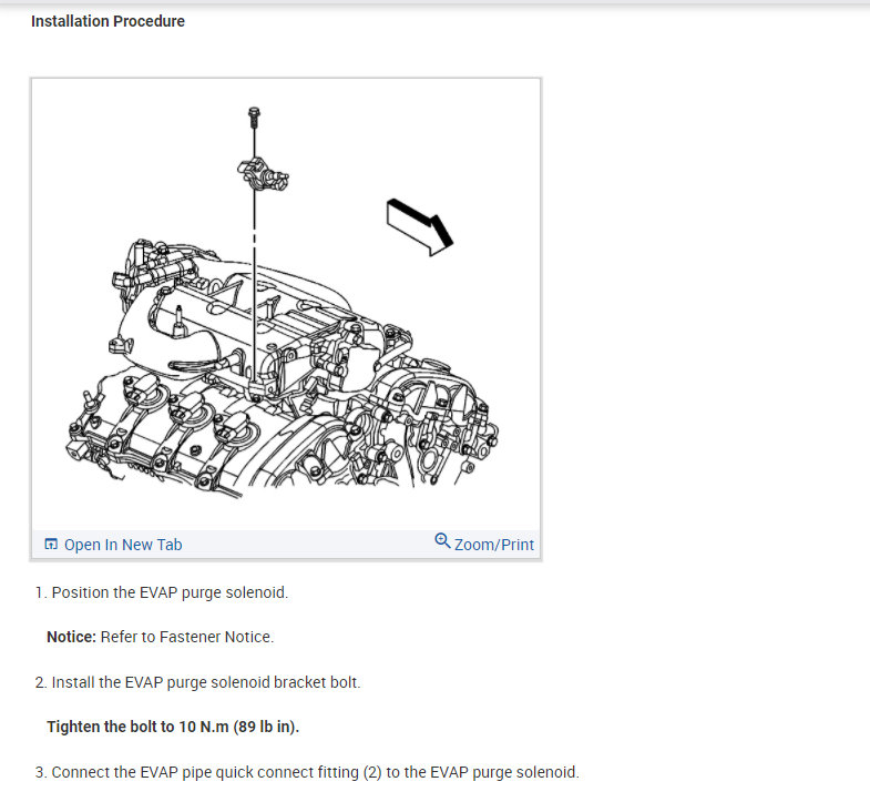

Do you have the same codes set as this question is addressing? If it is hard starting after fueling, that could be the purge valve for the system that was addressed in one of the answers.
Codes will cover fuel control failures, not mechanical.

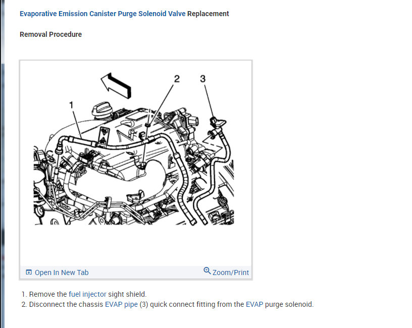

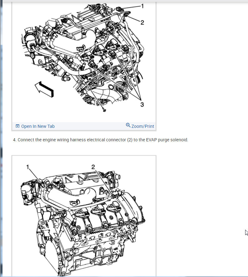

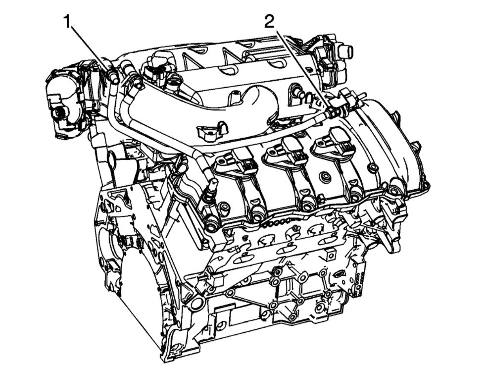

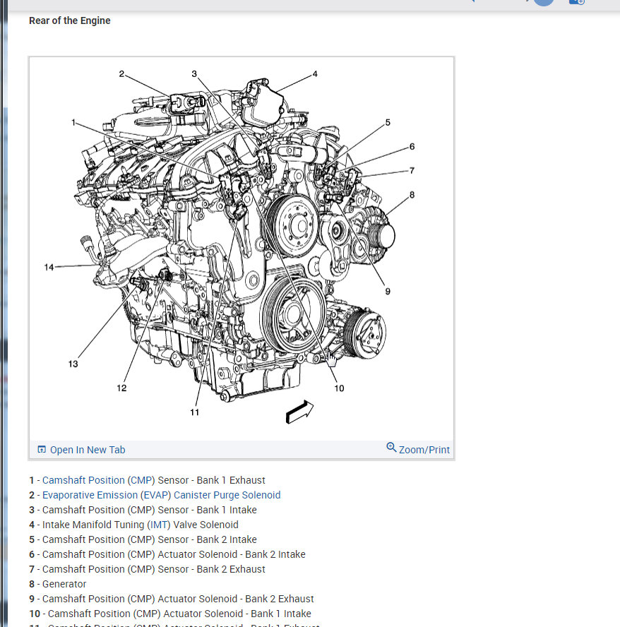

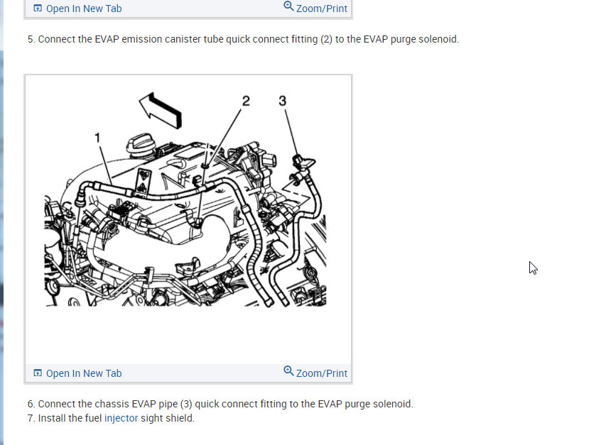

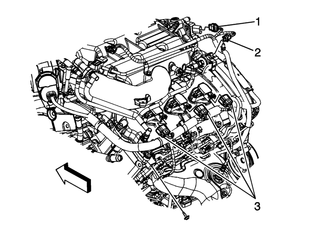

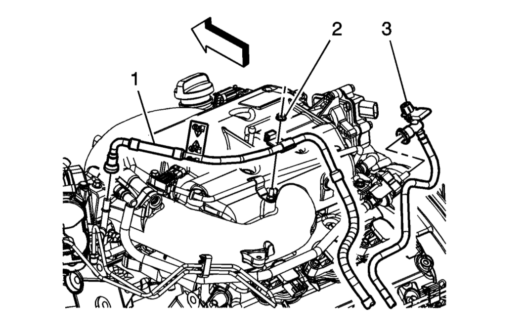

What are your symptoms? I attached the procedure for the purge valve and some pictures for you to view.
Evaporative Emission Canister Purge Solenoid Valve Replacement
Removal Procedure

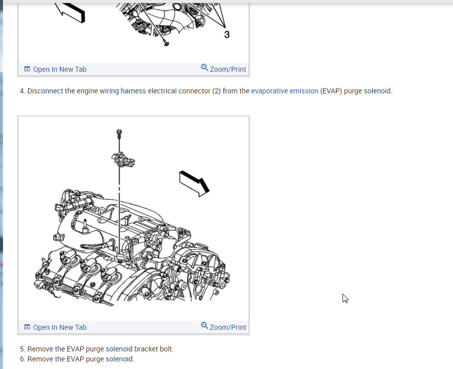

1. Remove the fuel injector sight shield.
2. Disconnect the chassis EVAP pipe (3) quick connect fitting from the EVAP purge solenoid.
3. Disconnect the EVAP emission canister tube quick connect fitting (2) from the EVAP purge solenoid.
4. Disconnect the engine wiring harness electrical connector (2) from the evaporative emission (EVAP) purge solenoid.
5. Remove the EVAP purge solenoid bracket bolt.
6. Remove the EVAP purge solenoid.
Nov 25, 2020 at 8:24 AM

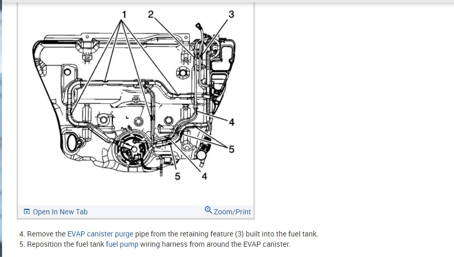

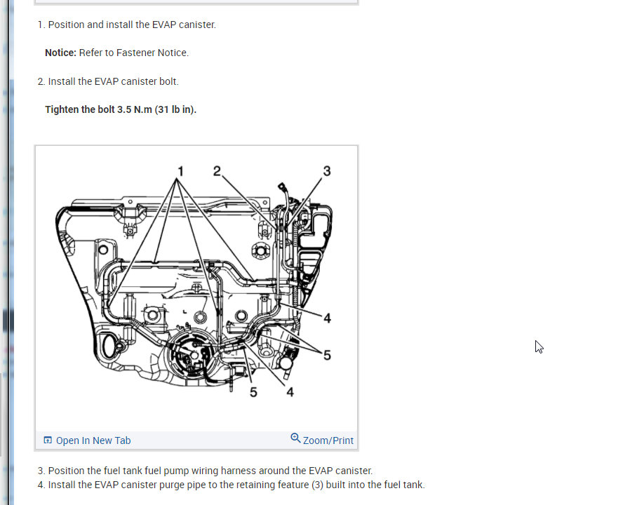

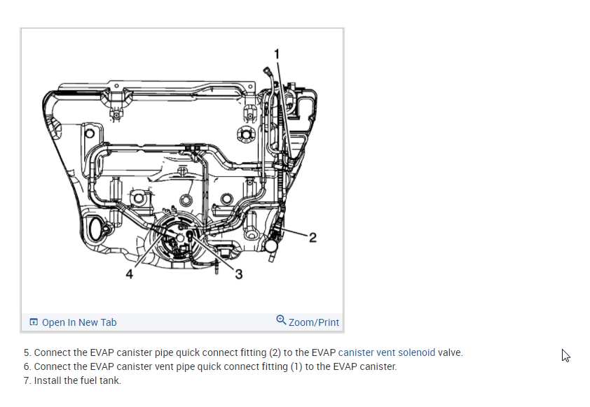

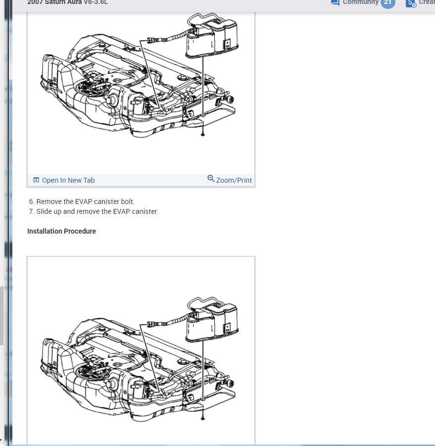

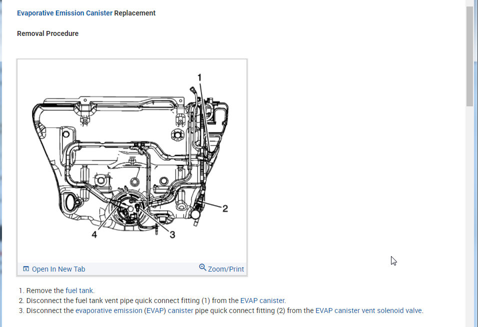

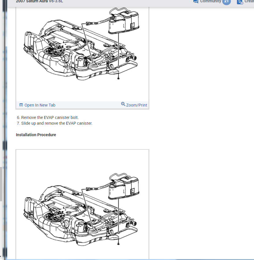

This is a pretty common thing when the EVAP (emissions) system has raw fuel in it. This system is only supposed to pull the vapor out of the tank and use it in the engine so that it is not released to the atmosphere. However, when this system gets raw fuel in it, the charcoal in the charcoal canister will breakdown and will clog the purge solenoid. This will cause it to stick open and allow too much vapor into the engine causing a hard start after filling the tank because it is pushing more vapor into this system.
I am attaching the process to replace both the purge valve and the canister as I suspect both are failed at this point. This is for the vehicle listed on this post. If you have a different vehicle then let's get a new post started and we can get the process for your specific vehicle.
