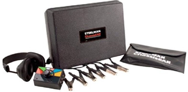

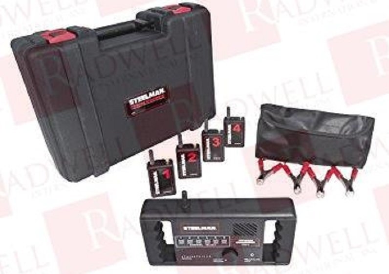

Also, this is a perfect application for a tool called the "Chassis Ear". It's a set of six microphones, a switch box, and headphones. You clip the microphones to suspect parts, then go on a test drive while listening in the headphones and switching between them. I found the original kit on eBay for only $99.00. They normally cost around $200.00 from the guys who drive the tool trucks to the repair shops each week. This set has wired microphones, so you must be careful where you string the wires. A newer model has four wireless microphones, but it costs more.
Be aware a lot of mechanics have never heard of this tool or even seen it. Suspension and alignment specialists use them quite often when looking for the source of rattles and other noises.
If you need to get a specialist involved, the best place to go is to a tire and alignment shop. People at the dealership are used to working on relatively new cars that haven't had time to develop noises yet. The people at alignment shops are experts at finding the causes of noises, vibrations, and bad tire wear.

That Chassis Ear sounds like this is what my Infinity dealer should have used! I will ask around and see if anyone locally has one and can hook it up to our car or get one off Ebay. Thanks for the reply.

Consider asking at some local auto parts stores that rent or borrow tools. In my city, they make you buy the tool, then you get a full refund when you return it. If you choose to keep a tool, you still return it, then they order or give you a brand new one.
You may not find this tool for loan because, so few people know about it or ask for it.
As the suspension and alignment specialist at the Chrysler dealership I used to work at, we had this tool supplied to us by Chrysler. I was one out of only two people who ever used it. I used it perhaps once a year, but it sure solved some elusive problems.

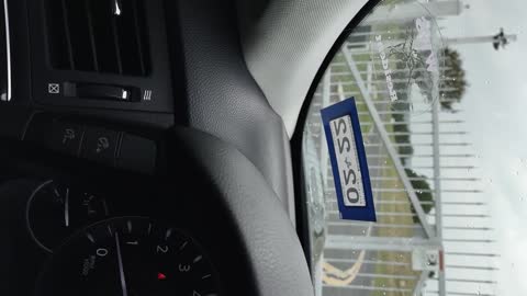

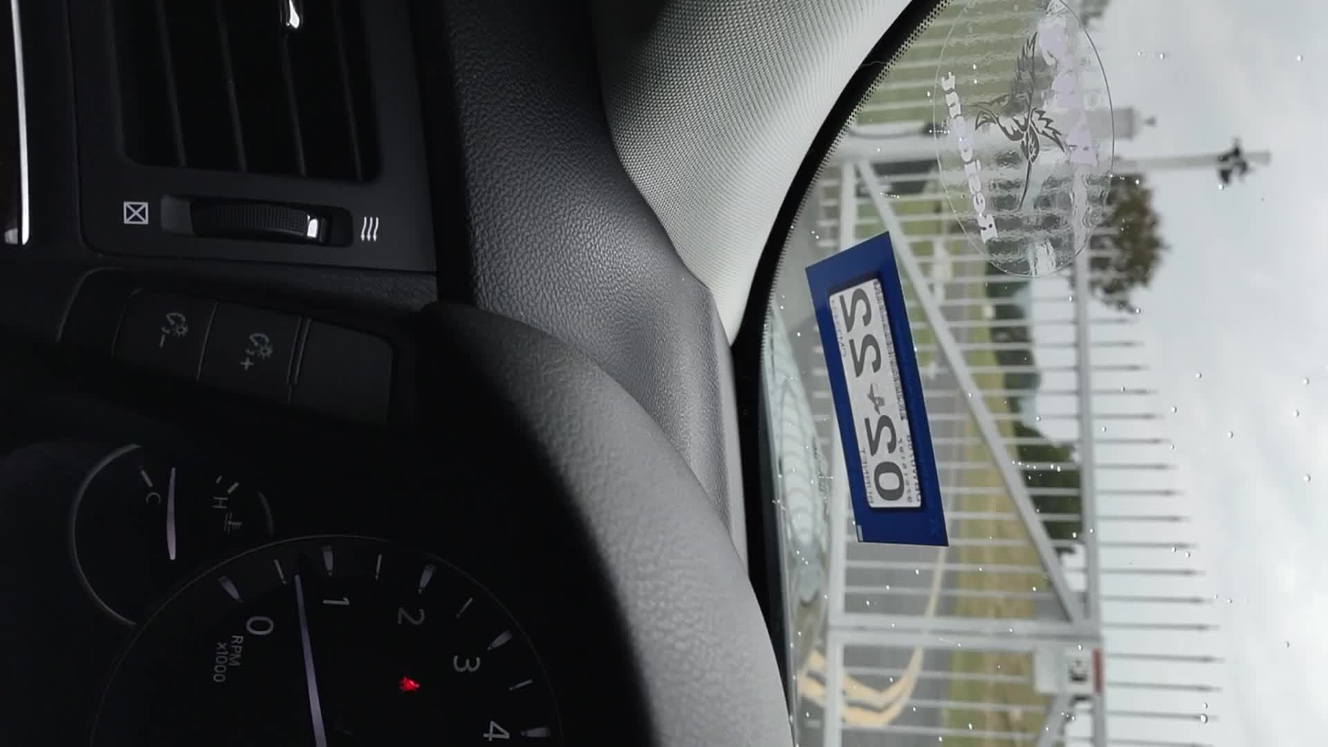

Well, I did this video today, if you listen carefully in the background you can hear the rattle.

It almost sounds like a wheel bearing. It sounds like a rotational noise.
Try this, drive on that same road, and try to swerve back and forth (do it in a safe manner), see if the noise gets higher as you are loading one side to another. This can tell us is the noise is from a bearing. As one side have more loading it should make louder noise.

I did the driving test and nothing changed in the level or frequency of the noise and I drove it hard.

Got it. That rules that out. At this stage this will require that 'chassis ear' that we talked about earlier.
The noise sounds like a rotational sound and not a rattle. Which will require the vehicle to be driven for the diagnostics.
