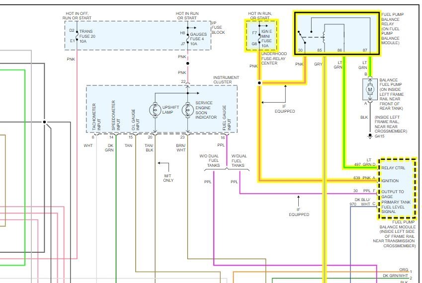

Do you have a balance pump on the frame rail? It shows a relay and a control for this. I attached a diagram for that system.

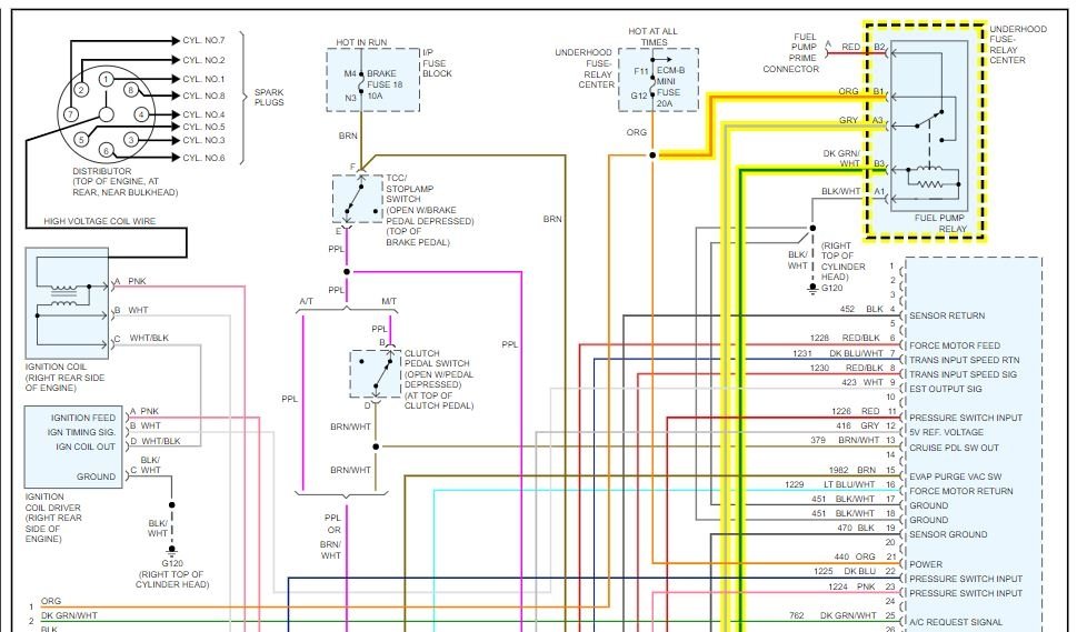

I also attached the fuel pump relay diagram. The ECM provides power to the control side for 2 seconds with the key on. Power will be provided full while cranking. Did you check it while cranking?

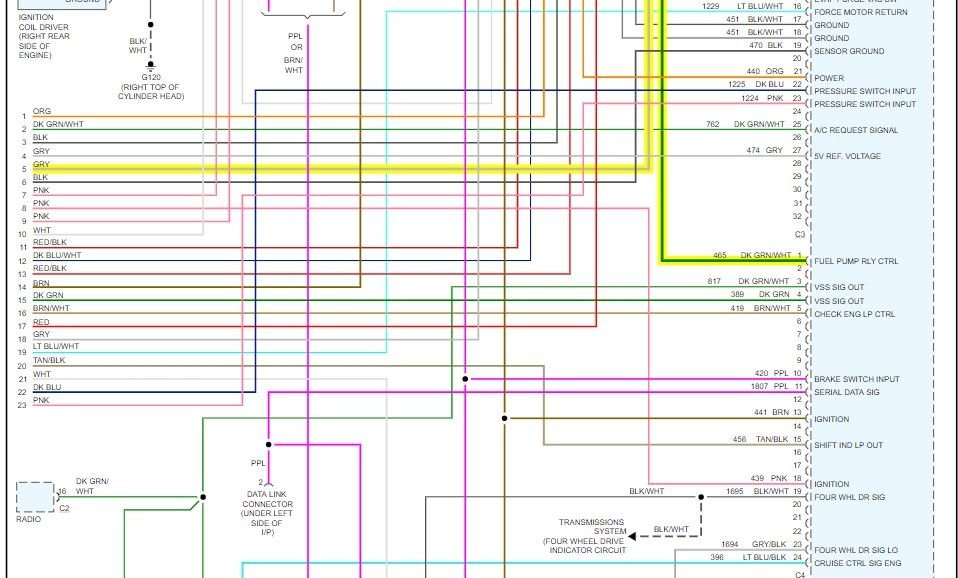

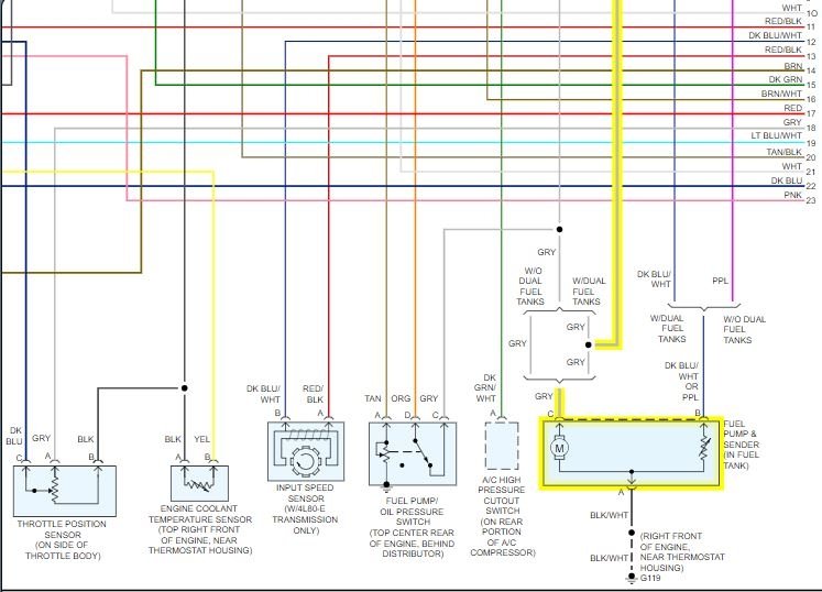

Let me go look under the vehicle as to whether or not I can find the balance pump. My vehicle has a single 40gal gas tank so I don’t believe it does. I noticed in one of the diagrams the grey wire you had highlighted was traveling the path that went through dual fuel tanks, would this affect the other diagrams you posted?
When I turn the key 87a fuel pump prime (labeled B2 in the fuel pump relay diagram) receives the 12v signal for 2 seconds then cuts out like normal. With the key turned but not cranking 85 on the control side (labeled B3 in the fuel pump relay diagram) doesn’t show any voltage nor any voltage while cranking.

Okay, B3 comes from the ECM. It should send a signal for 2 seconds with key on and full voltage while cranking and running. Once it sees an RPM signal from the ignition system, it will send a signal.

In 4 other videos I have watched of people diagnosing fuel pump issues for this year 5.7L engine, B3 should show 12v with the key in the on position. B2 the pump prime which is normally connected to the fuel pump when the relay is not engaged will receive 12v signal for 2 seconds when you bump the key forward. The purpose being to “prime the fuel lines” before starting the vehicle.
B3 control side signal from the PCM is supposed to show a phantom 12v signal with the key bumped on. I say phantom voltage because the voltage a “bias voltage” induced from the resistor in the PCM, if you tried to test it with a signal light it won’t light up. This also makes sense from a logical stand point as you wouldn’t want the pump running non stop with the key turned and the vehicle not running. Then while cranking like you mentioned earlier it should be receiving the actual 12v signal which would engage control side the relay connecting B1(load side power) to A3 (fuel pump).
So to reiterate again B3 doesn’t show voltage with key on or cranking, would this be indicative of a failure of the PCM or is there any other reason why the PCM would not send out the signal? From what I can tell oil cutoff switch is after the relay so if it failed I wouldn’t receive power at the pump when jumping the relay. Some people have mentioned the crankshaft position sensor however from what you mentioned should I should check the ignition signal to the PCM?
