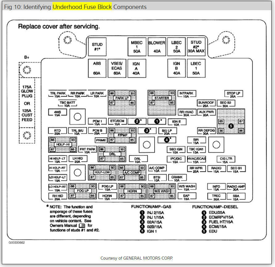

I think it could be a fuel pump relay though this guide can help the location is int he diagrams below.

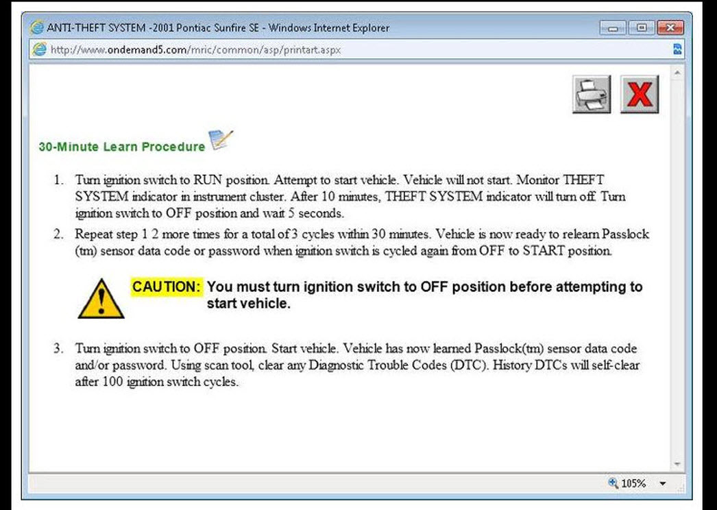

Anytime the battery is disconnected the security system has to be reset. See picture.
