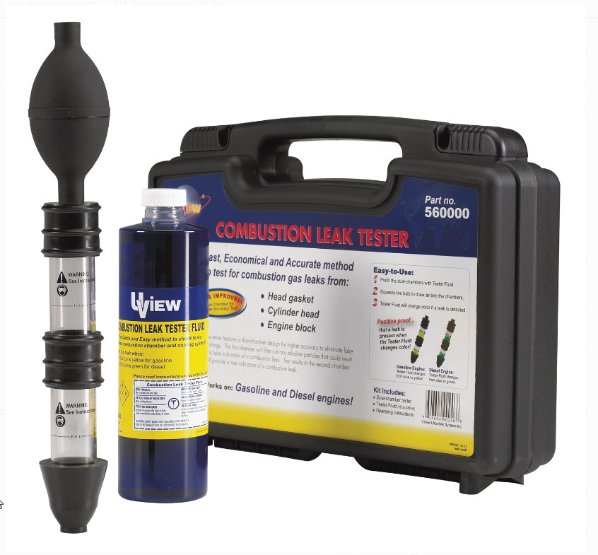

Smoke will come out most likely at first start up and then after it warms up. It is hard to say for sure because it all depends on the leak. Again, you will not be able to visually see a bad head gasket. There are a lot of ways to check for a head gasket that don't require you to remove the head. The most common is a blue fluid that you use to tell if there are combustion gases in the coolant. I attached a picture of one of these kits. They are available at many large parts stores.

Sorry Tony. I don't think we are on the same page. This tool will only find head gasket issues on the inside of the engine. It will not help with external leaks. You put this on the radiator and allow it to pull in the fumes and if the fluid turns yellow then you have hydrocarbons in the coolant which means your head gasket has failed.
If you have an external leak, the best way to find it is to put a pump on the radiator and pressurize the cooling system to about 15 PSI and then look for where it is coming out. Let me know how you make out. Thanks
