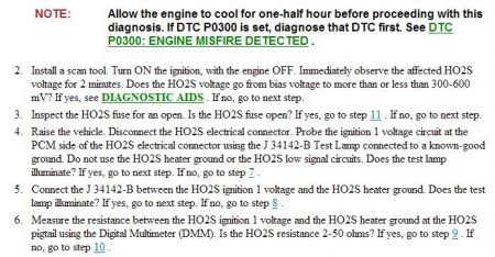

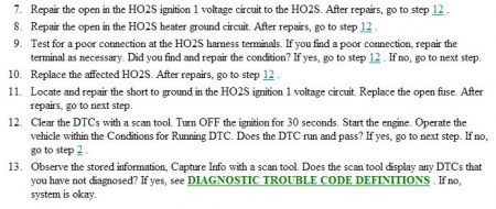

I don't believe this is an issue with the injectors.. P0141 is heated oxygen sensor circuit malfunction You stated you arleady checked the supply voltages to the sensor? If not, do the following.
https://images.2carpros.com/forum/automotive_pictures/261618_Noname_33.jpg
https://images.2carpros.com/forum/automotive_pictures/261618_Noname2_10.jpg
