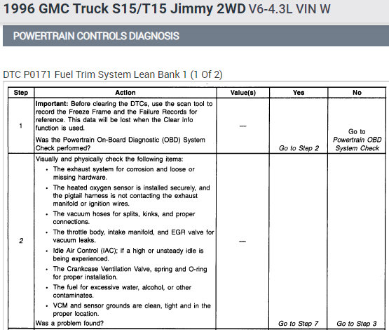

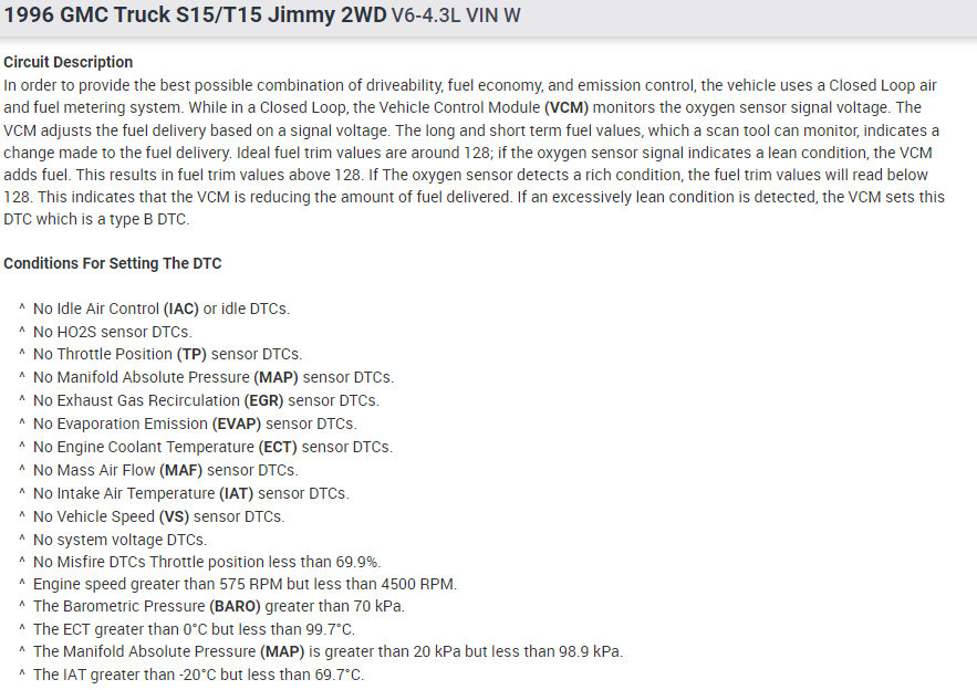

Please tell me what these codes stand for and the diagnosis.
Apr 15, 2010 at 4:08 AM
SQM
Experienced Mechanic
6,383 POSTS

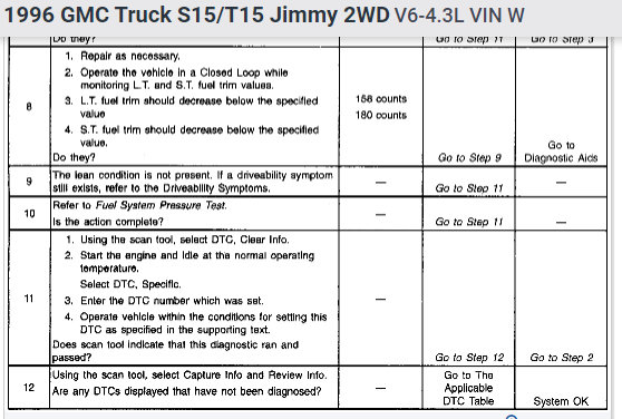

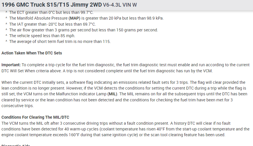

Here are the codes:
P0171 Fuel Trim System Lean Bank 1
P0174 Fuel Trim System Lean Bank 2
https://www.2carpros.com/articles/check-engine-light-clear-codes

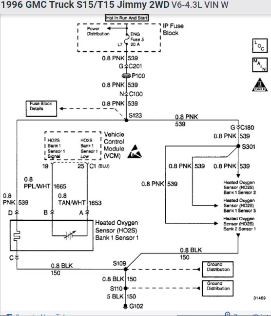

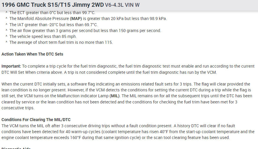

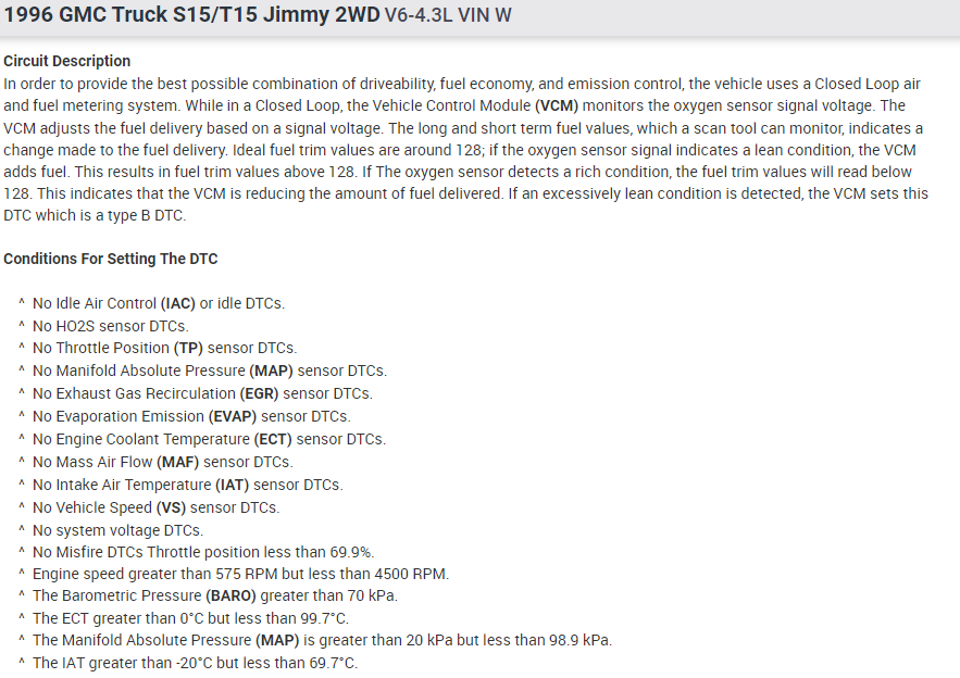

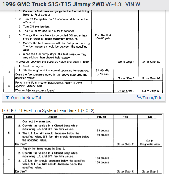

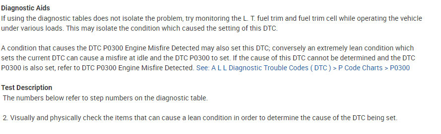

See attached for the diagnostics.
