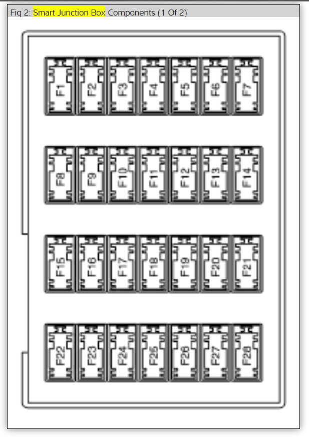

First I would do a load test on the battery which can be done following this guide which uses no tools.
and if bad
https://www.2carpros.com/articles/how-to-replace-a-car-battery

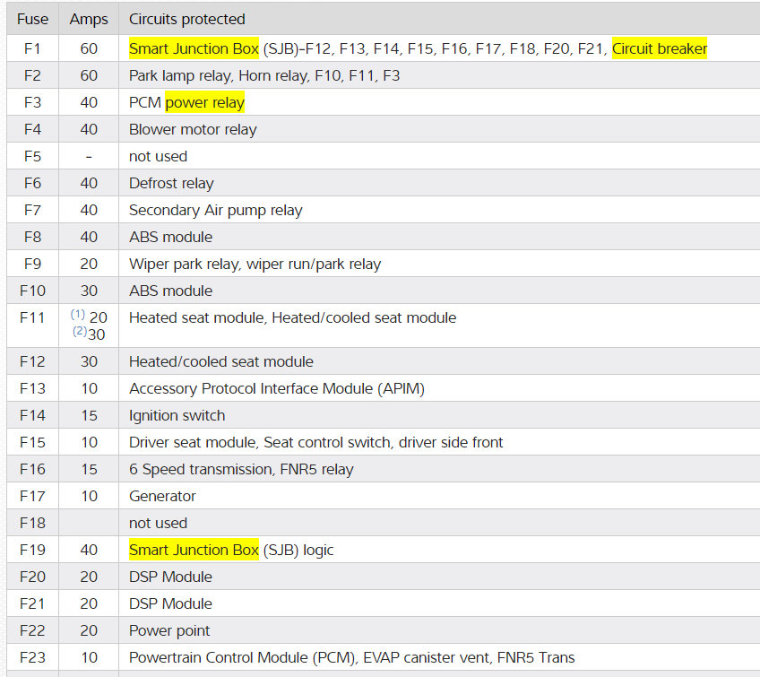

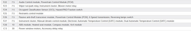

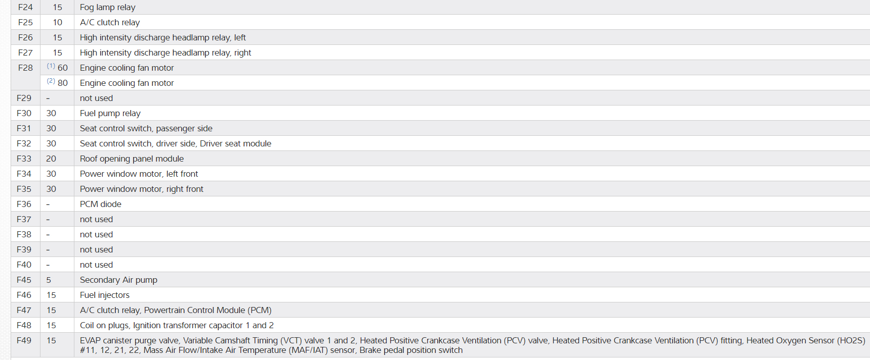

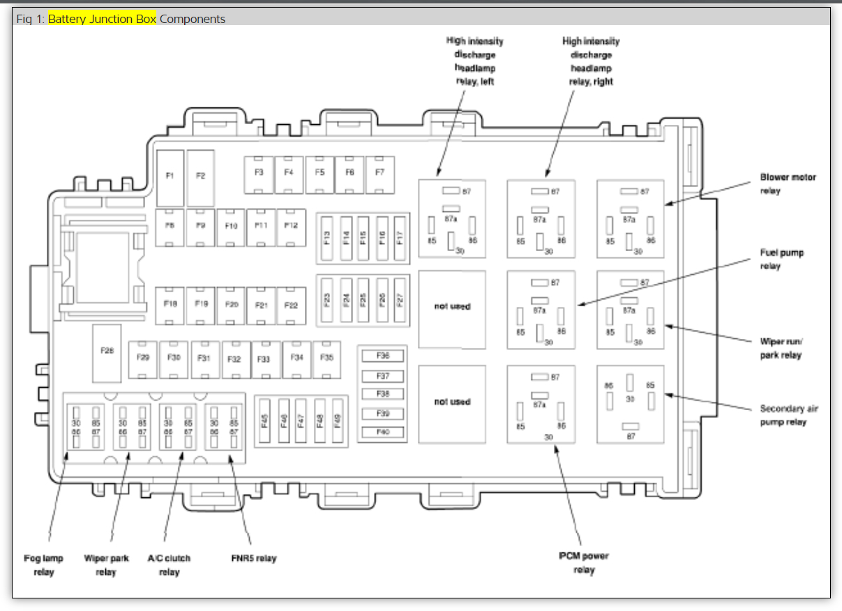

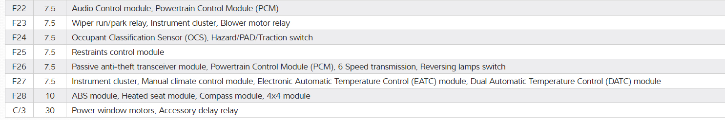

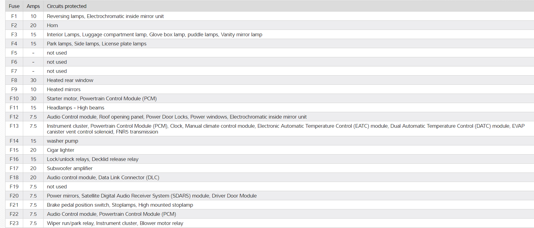

Here is a guide on how to check the fuses as well:

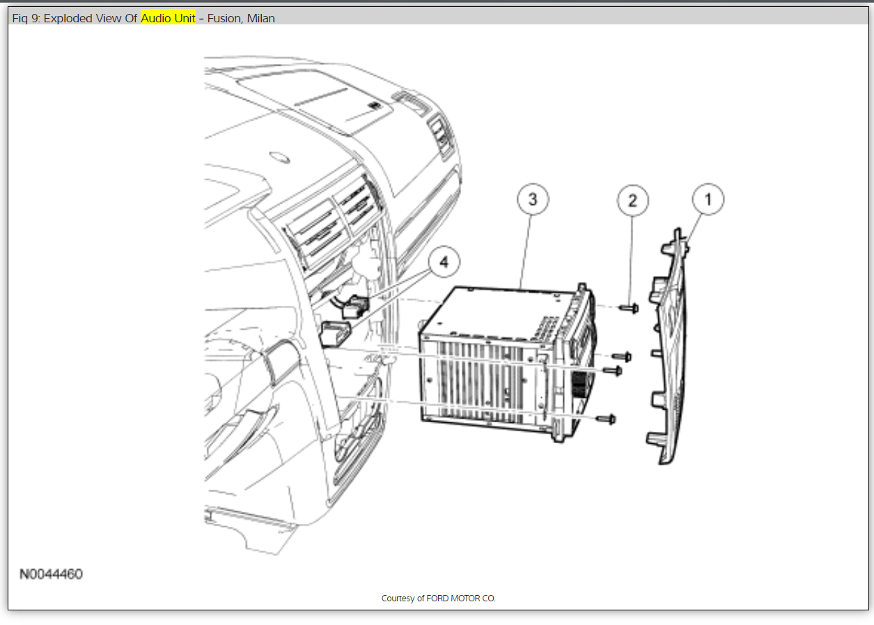

Then you will need to remove the radio/CD changer and remove the penny from the unit. Below is a guide to help you get the job done and some fuse box diagrams.
