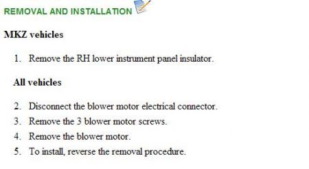

The instructions look rather basic, there are no pics so i hope this is ok for you,
https://www.2carpros.com/forum/automotive_pictures/61395_1_73.jpg

So, no pics at all? I am kind of a novice when it comes to working on my car, but I will have to see what I can do.

Sorry, but there were no pics associated with the blower motor removal, but I think that you should have no problem doing this, I am looking for alt pics of the heater section that shows the motor access.
