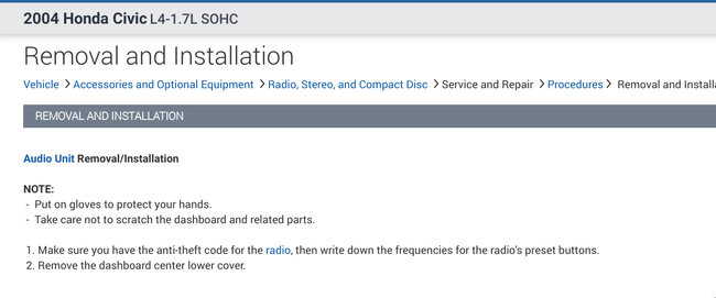

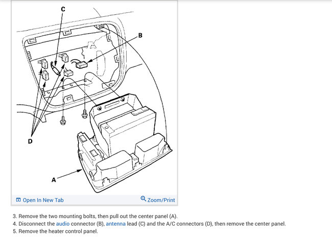

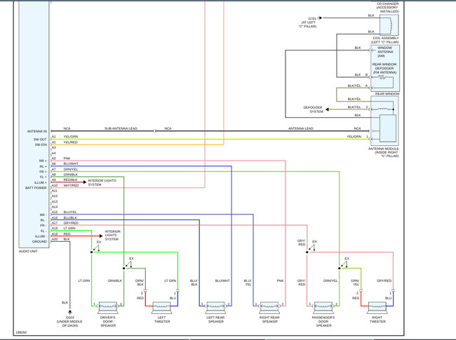

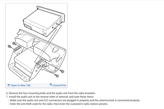

Will replacing the stock head unit with an aftermarket Head Unit trigger the Security Anti Theft in the car listed above (EX model)?
Mar 6, 2020 at 1:51 PM
SCGRANTURISMO
  • 4,897 POSTS
No, it will not. In the diagrams down below I have included the instructions for the removal of the stereo in your vehicle. I have also included the stereo wiring diagram for you. Please go through this guide and get back to us with how everything turns out.
Thanks,
Alex

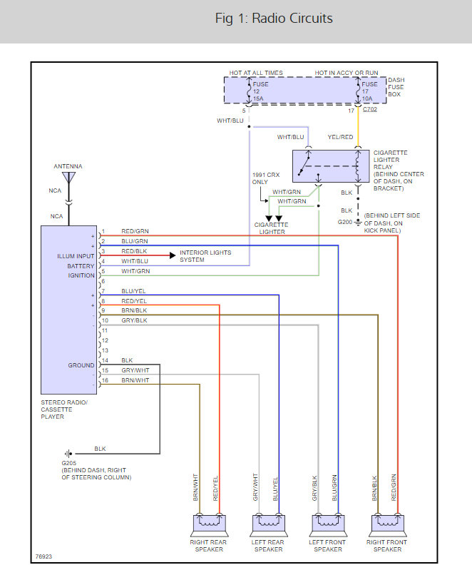

Ok i have a radio i'm trying t install on my 1991 Honda Civic DX hatchback, and i need some help trying to get it to work. The radio lights up, but i get no sound and the face of the radio shows nothing. Does anyone have a proper wiring diagram for my car to ensure that i have the harness for the aftermarket radio wired to the car properly. Oh and i'm a automotive student in college.
Oct 28, 2020 at 4:20 AM (Merged)
KHLOW2008
  • 41,814 POSTS
Here is the radio wiring diagram you needed in the diagrams below. Check out the diagrams (Below). Please let us know if you need anything else to get the problem fixed.

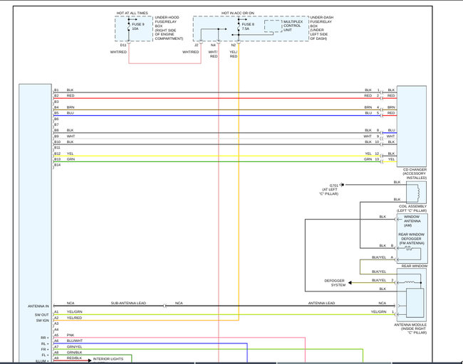

I have a 2008 Honda Civic coupe. I need help with finding my radio diagram it’s non navigation and non premium audio sound. I can’t find anything.
