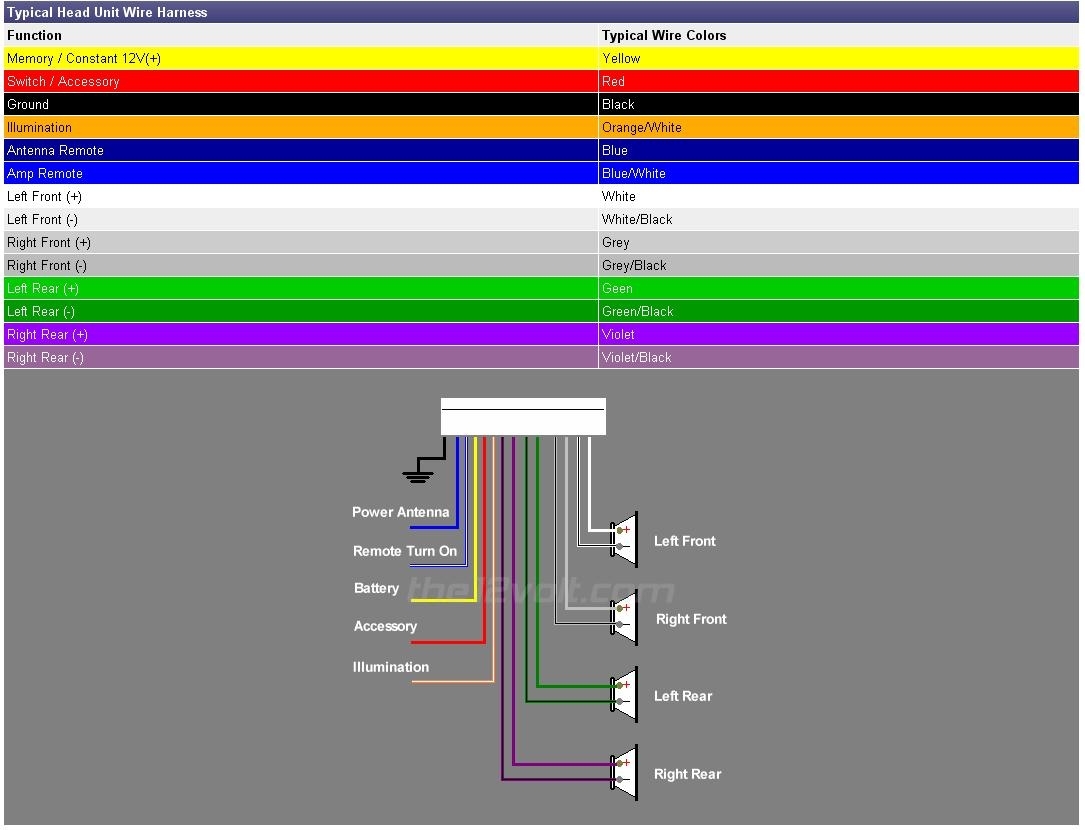

Can I get a radio color code for install?
2004 GMC CANYON
186,870 MILES • 6.0L • 6 CYL • 4WD • AUTOMATIC
FUMBLES1
I need a wire diagram to install aftermarket radio.
Sep 27, 2022 at 1:21 AM
MIKE H R
  • 3,094 POSTS
Here is a diagram of the wiring you asked for, I hope that helps you install the aftermarket radio. You can always get in touch with us if you need anything else, we are here to help.
