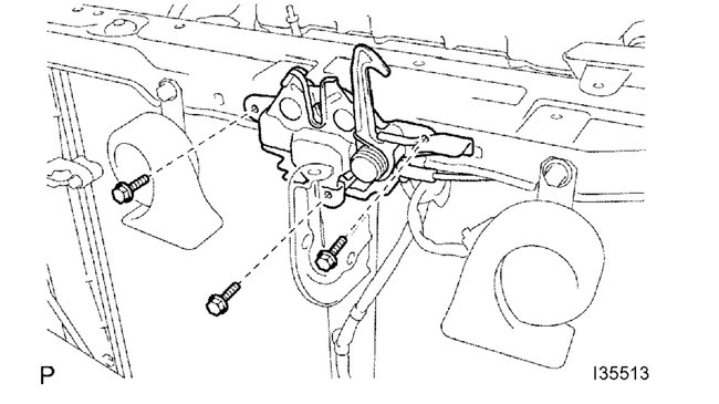

Yes, replace both hoses and the thermostat as well.
NO.2 RADIATOR ASSEMBLY
REPLACEMENT
1. DRAIN COOLANT
2. DISCONNECT RADIATOR HOSE INLET
3. DISCONNECT RADIATOR HOSE OUTLET
4. DISCONNECT OIL COOLER INLET HOSE NO.1
5. DISCONNECT OIL COOLER OUTLET HOSE NO.1
6. REMOVE FRONT BUMPER COVER
7. REMOVE AIR CLEANER CAP SUB-ASSEMBLY
8. REMOVE AIR CLEANER FILTER ELEMENT SUB-ASSEMBLY
9. REMOVE AIR CLEANER INLET NO.2
10. REMOVE AIR CLEANER CASE
11. REMOVE AIR CLEANER BRACKET
12. REMOVE AIR CLEANER INLET NO.1

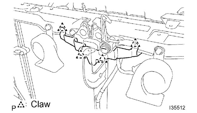

13. REMOVE HOOD LOCK RELEASE LEVER PROTECTOR
a. Release the 4 claws and remove the hood lock release lever protector.
14. REMOVE HOOD LOCK ASSEMBLY
a. Remove the 3 bolts and separate hood lock.

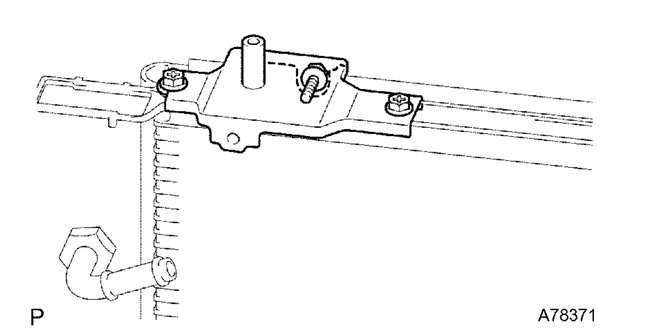

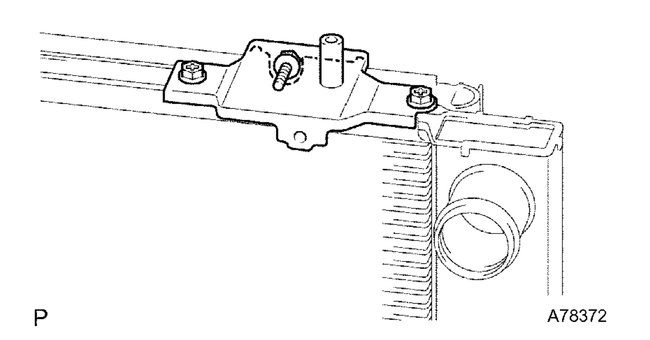

15. REMOVE RADIATOR SUPPORT SUB-ASSEMBLY UPPER
a. Disconnect the horn connectors.
b. Remove the 5 bolts and the radiator upper support.

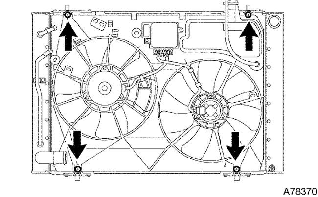

16. REMOVE FAN SHROUD
a. Disconnect the engine coolant reservoir hose.
b. Disconnect the fan motor connector.
c. Remove the 4 bolts and the fan shroud.

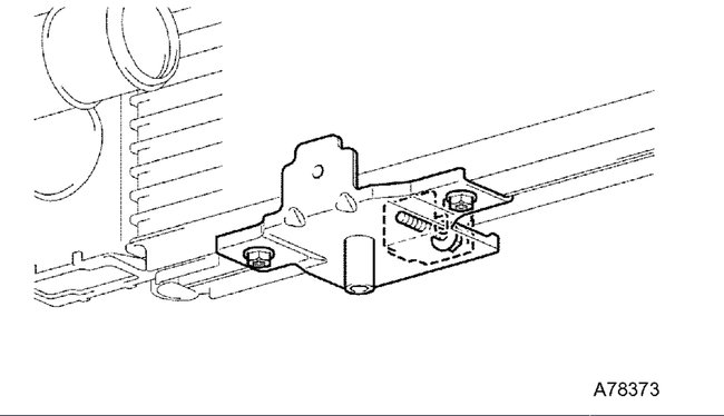

17. REMOVE RADIATOR SUPPORT SUB-ASSEMBLY UPPER LH
a. Remove the 3 bolts and the radiator support upper LH.
18. REMOVE RADIATOR SUPPORT SUB-ASSEMBLY UPPER RH
a. Remove the 3 bolts and the radiator support upper RH.
19. REMOVE RADIATOR SUPPORT SUB-ASSEMBLY LOWER RH
a. Remove the 3 bolts and the radiator support lower LH.
20. REMOVE RADIATOR SUPPORT SUB-ASSEMBLY LOWER RH
a. Remove the 3 bolts and the radiator support lower RH.
21. REMOVE NO.2 RADIATOR ASSEMBLY
22. INSTALL NO.2 RADIATOR ASSEMBLY

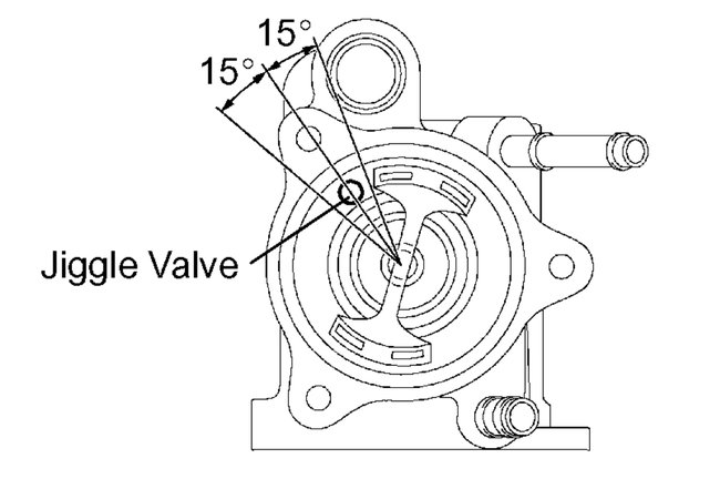

Thermostat
THERMOSTAT
REPLACEMENT
1. DRAIN COOLANT
2. REMOVE BATTERY
3. REMOVE AIR CLEANER CAP SUB-ASSEMBLY
4. REMOVE AIR CLEANER FILTER ELEMENT SUB-ASSEMBLY
5. REMOVE AIR CLEANER INLET NO.2
6. REMOVE AIR CLEANER CASE
7. REMOVE AIR CLEANER BRACKET
8. REMOVE AIR CLEANER INLET NO.1
9. REMOVE STARTER ASSEMBLY
10. DISCONNECT RADIATOR HOSE OUTLET

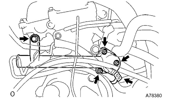

11. REMOVE WATER INLET
a. Disconnect the wire harness clamp.
b. Remove the bolts, the 3 nuts and the water inlet.
12. REMOVE THERMOSTAT

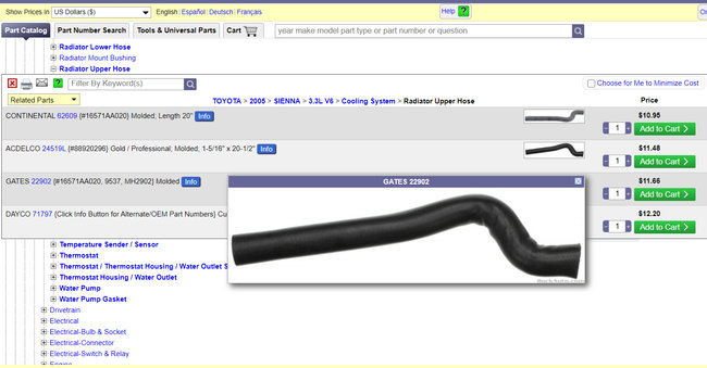

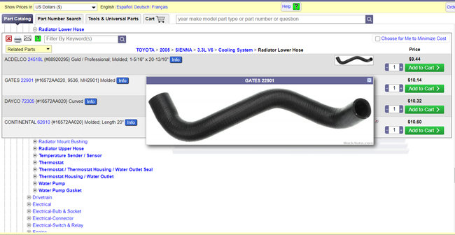

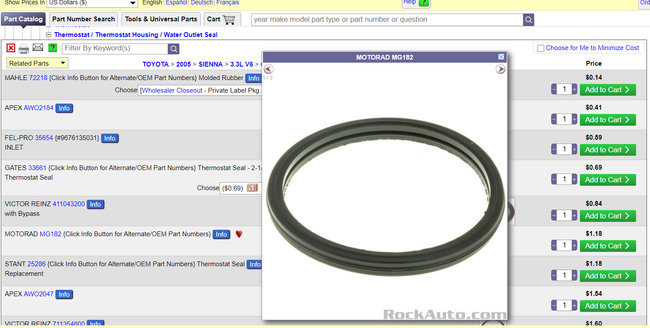

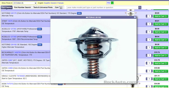

If I order from rockauto, what brand or description of thermostat, gasket and hoses should I get?
Mar 18, 2021 at 10:22 AM
Okay, I attached the parts below for you to order.
Mar 18, 2021 at 12:37 PM

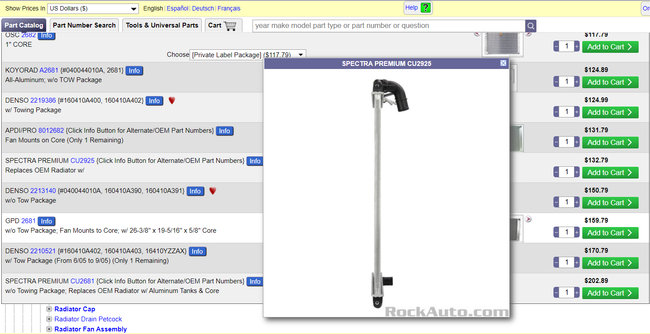

what is the spectra premium CU2925?
Mar 18, 2021 at 4:41 PM
That is the brand and part number for the radiator itself.

I already had purchased a radiator, will these hoses fit my radiator?
Mar 20, 2021 at 10:12 AM
Okay, you asked about the parts and I attached them. Assuming you have the correct radiator, yes, they will fit. Match them up to the old ones.
