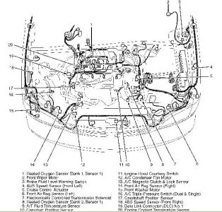

I had my computer read the code for the check engine light and it was p0125.
By researching this it seem to be a coolant temperature sensor. Where is that located under the hood? I would like to install it myself.
Feb 26, 2009 at 9:38 PM
BLUELIGHTNIN6
  • CAR REPAIR CONTRIBUTOR
  • 16,542 POSTS
Your engine coolant temperature sensor is located on the right side of the engine, pictured below.
https://images.2carpros.com/forum/automotive_pictures/261618_Noname_269.jpg
