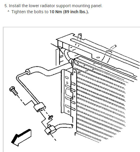

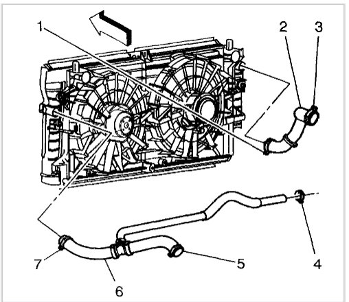

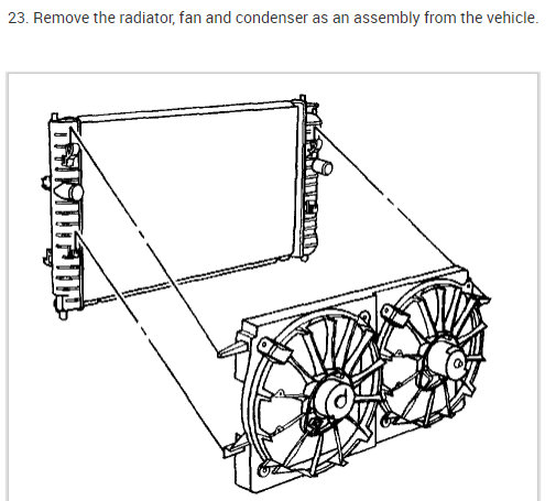

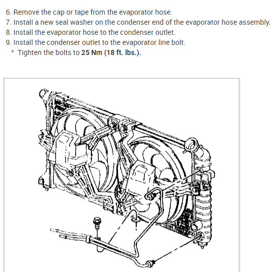

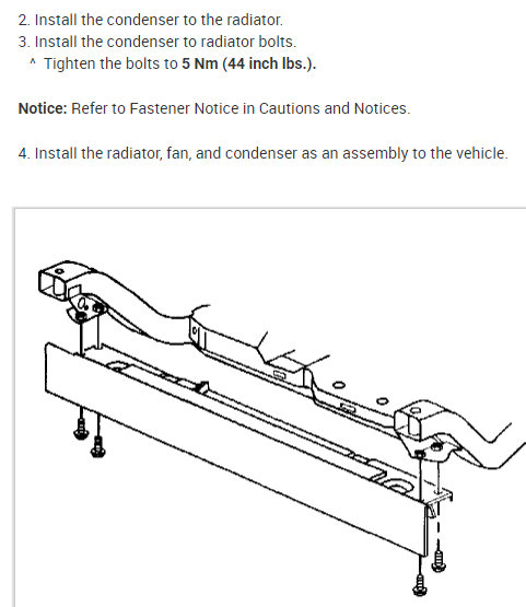

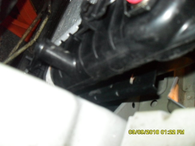

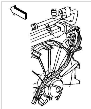

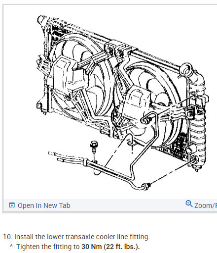

I am trying to replace the radiator in my car and it has already taken me much longer than I planned, and my college final exam is tomorrow morning and the one the following day. So I am desperately trying to finish this job this evening.
I removed the battery, and all plastic coverings that would prevent access. I have successfully drained all coolant out of the radiator (the petcock would not come out so i had to remove the hoses) then I removed the lines that went in to the radiator.

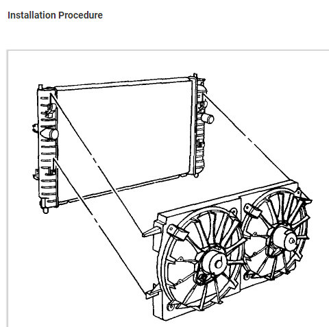

Next was the fans then radiator. My problem is that I am having difficulty getting my A/C condenser and radiator to get close enough to attach the bolts that go into the condenser that connects to the radiator a long with the plastic front cover.

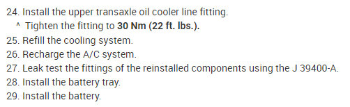

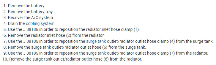

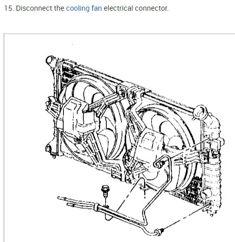

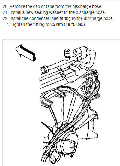

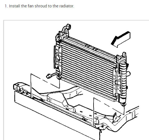

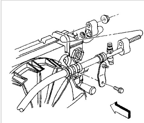

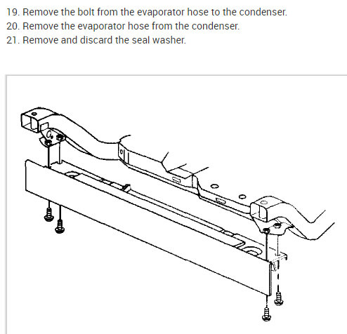

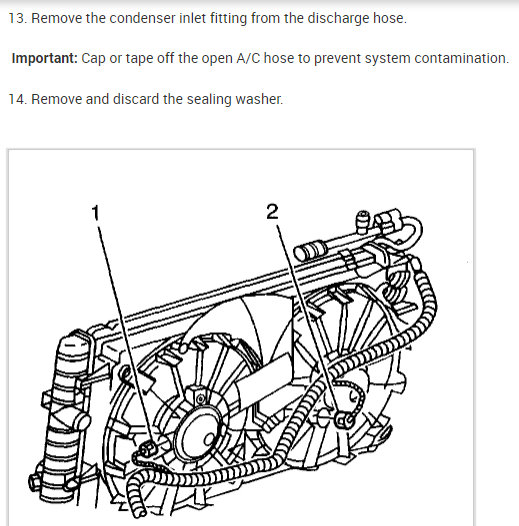

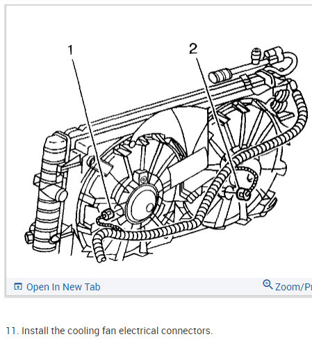

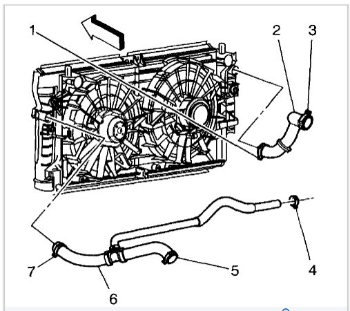

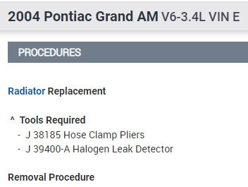

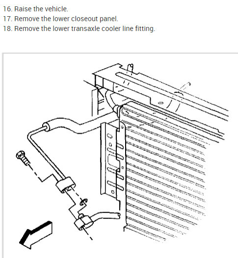

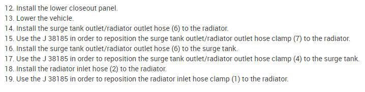

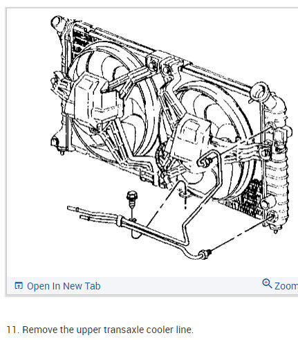

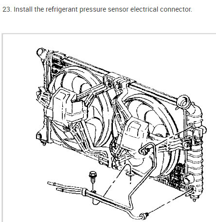

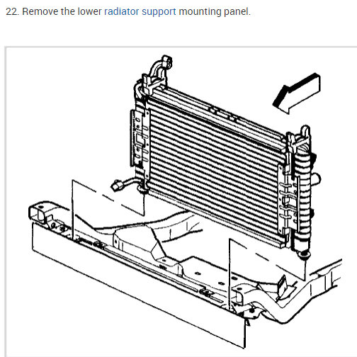

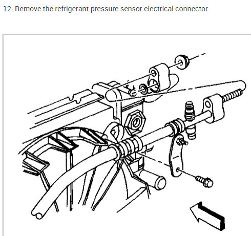

Here is the radiator replacement information you requested. Here is a tutorial showing how to replace a radiator.
https://www.2carpros.com/articles/how-to-replace-a-car-radiator
After the repair you will also have to recharge the ac system since you had to disconnect the lines to replace the radiator. Here is a tutorial showing how to recharge the system.
I've attached picture steps below on how to remove and replace the radiator on your Grand Am. Hope this helps and thanks for using 2CarPros.
