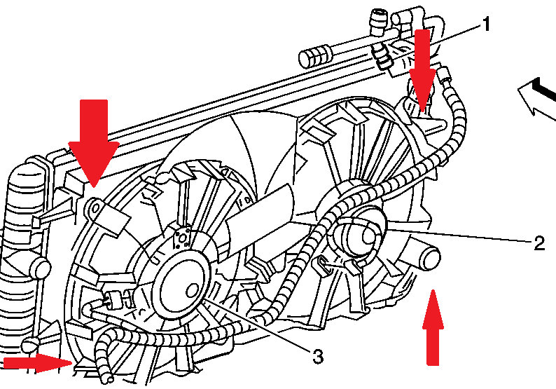

I am replacing my radiator. how do I take the fans off the radiator to drop it from the bottom? It is holding up my progress of getting it done.

there should be 4 10mm bolts at each red arrow, you maybe have to take one fan out at a time, and may try taking them out of the top first, I know they seem like they don't want to come out that way, but try moving the Pass side one out first, then the right one. unplug them of course also.

Take picture of them for me if you'd like, may help...
