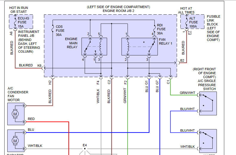

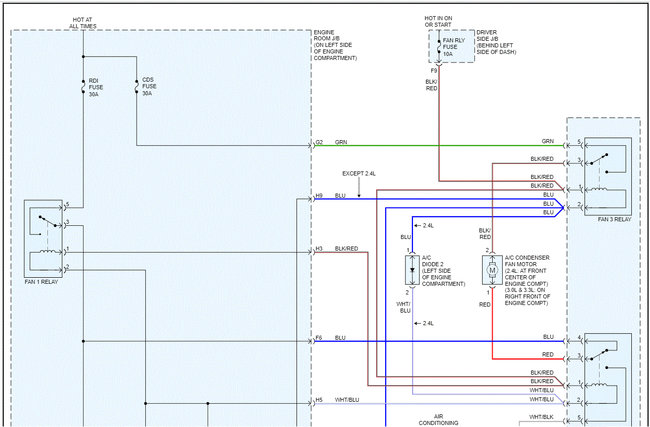

Good morning, the vehicle radiator fan stop functioning. I have tested the fan it is okay, I thought the problem was the thermostat initially, I have replaced it but there's no effect. I have tested the fuse and relay, they are okay.
What could be the fault?
Please help me with the complete circuit diagram or wire diagram.
Sep 28, 2020 at 11:49 AM
  • 110,244 POSTS

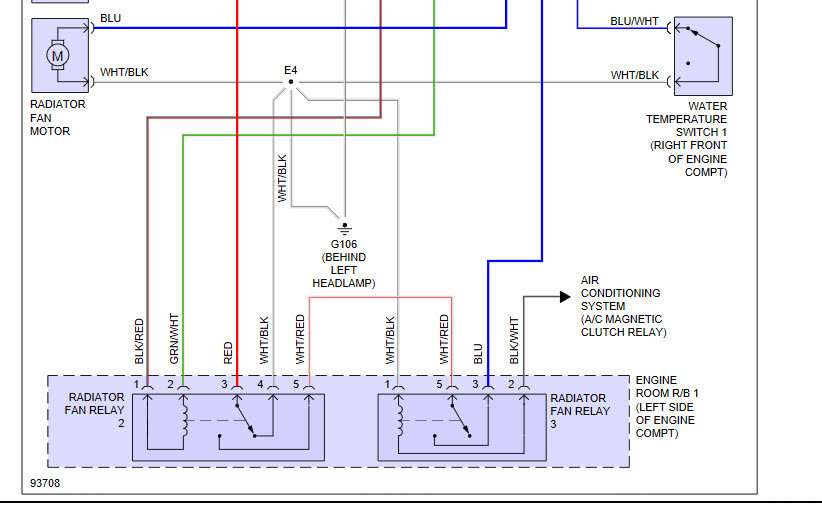

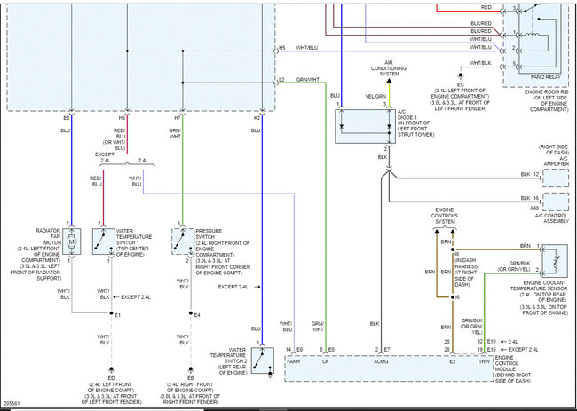

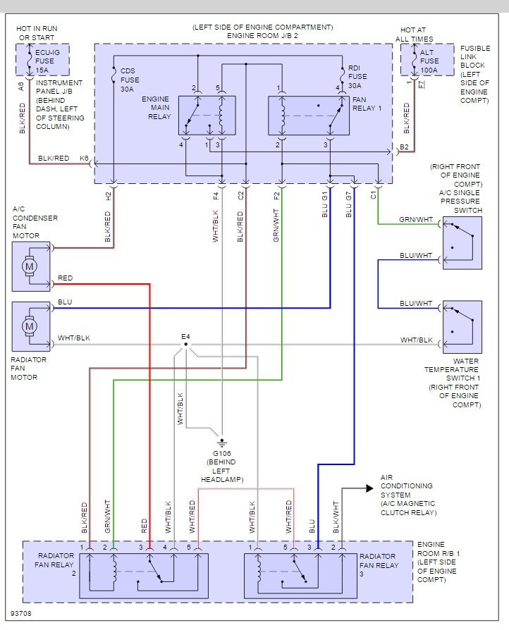

There are three different fan relays. I attached the schematic you requested. Take a look through it and let me know if you have questions. Note: I had to cut the pic in half to make it readable. I did, however, overlap it so you can easily follow it.

Thank you very much.

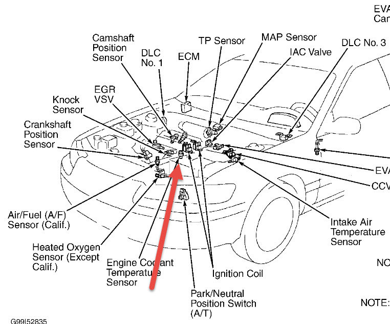

changed the thermostat and radiator when this problem surfaced. car still overheats and fans do not come on when temp goes above normal
Jan 25, 2021 at 4:39 AM (Merged)
HMAC300
  • 48,601 POSTS
check your coolant temp sensor may be bad then check fuse and relays under hood. see pics

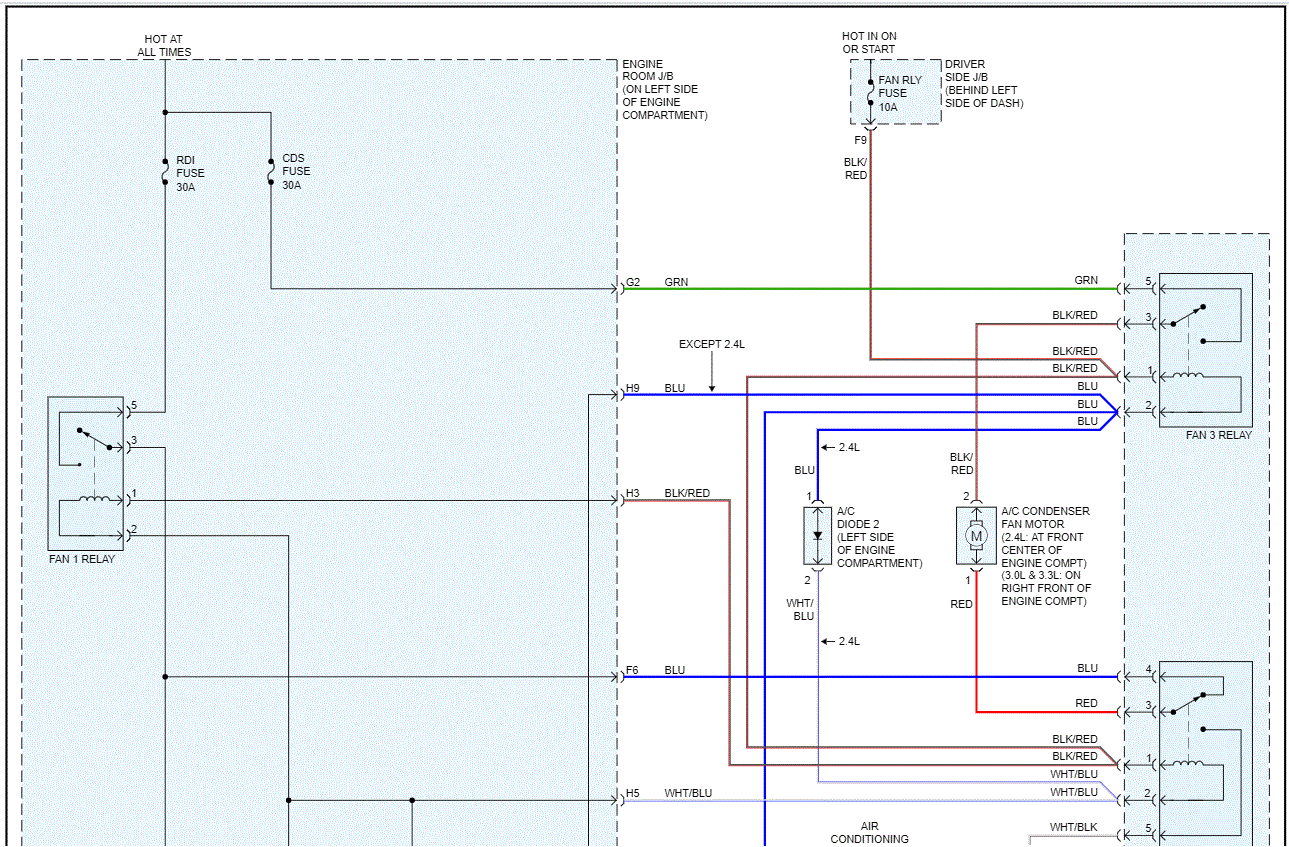

Okay, than it is probably the relay, here is a wiring diagram and guide to help you test the system to figure out what is wrong.
and
Please run some tests and get back to us so we can continue helping you.
