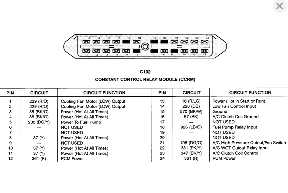

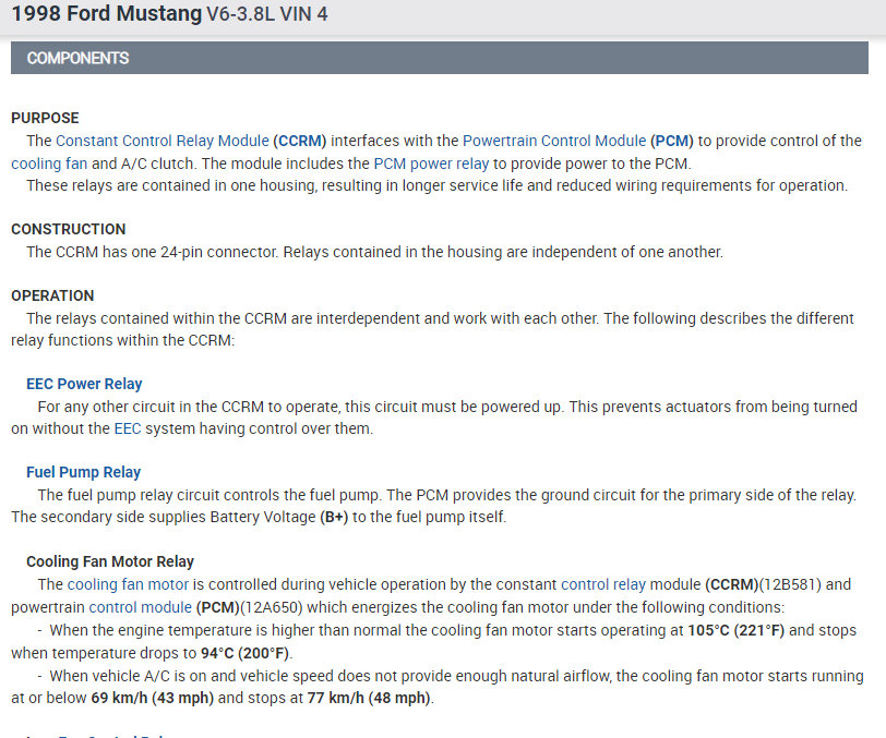

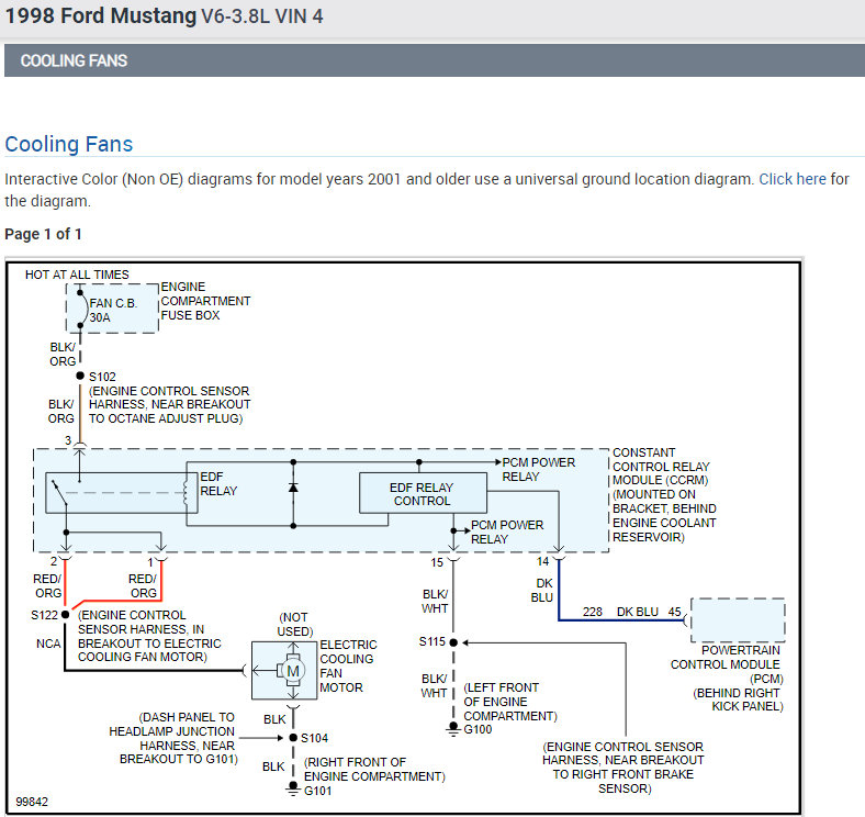

It is always a good idea to check the relay and wiring before replacing the fan. Many times the issue is not the fan but a relay or bad wiring.

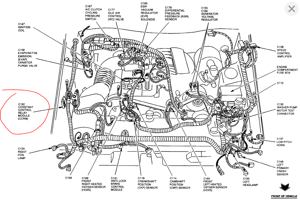

This vehicle has what ford calls constant control relay module (CCRM).
That relay is located under the hood on the passenger side inner fender (see diagram below).
Visually check the CCRM for any burn pins or corrosion.
The relay can be tested.
This is a helpful article of how to test relay:

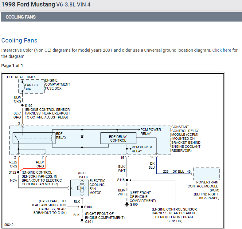

You also want to check the wiring and make sure you are getting power to the fan.
You might find this article helpful:
