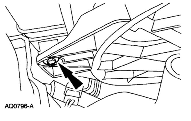

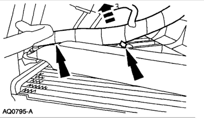

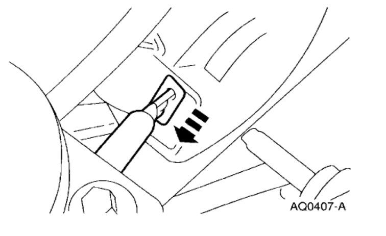

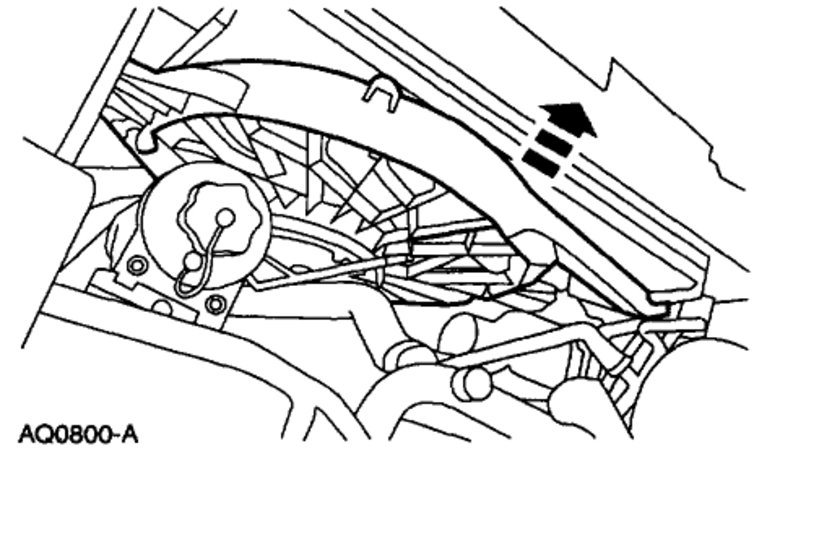

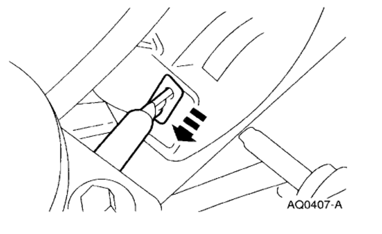

It does sound like you have a radiator fan that is not working. While the air conditioner is on lets use a test light to probe the wires of the fan to see if it is getting power. Here is a guide to help you get the job done.
and if it is getting power and not working the fan motor has gone bad and needs replacement.
Here is a guide that will give you an idea of what you are in for when doing the job.
https://www.2carpros.com/articles/replace-electric-fan-motor
Please let us know what happens and upload pictures or videos of the problem.
