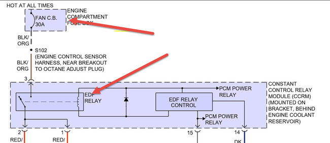

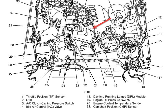

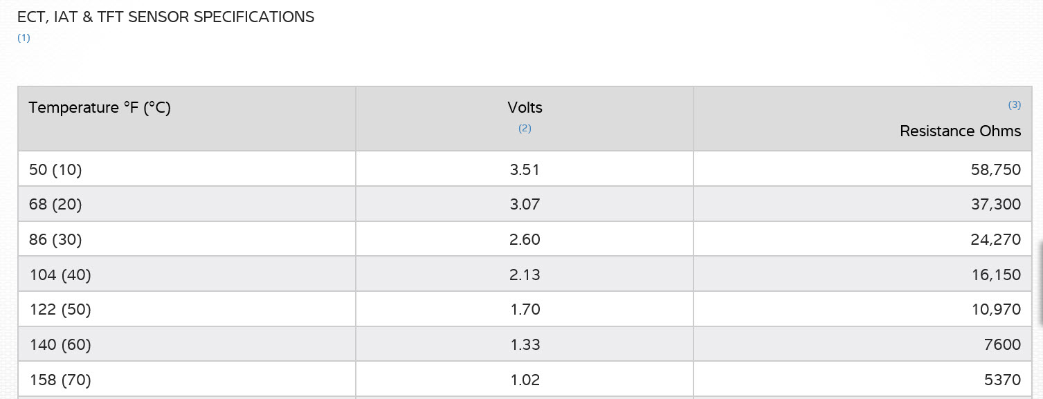

The radiator cooling fan stopped working and caused my car to overheat the other day leaving me stranded two hours from home.I was wondering what a good estimate to get it fixed is at the average shop.
Apr 12, 2016 at 6:46 AM
HMAC300
  • 48,601 POSTS

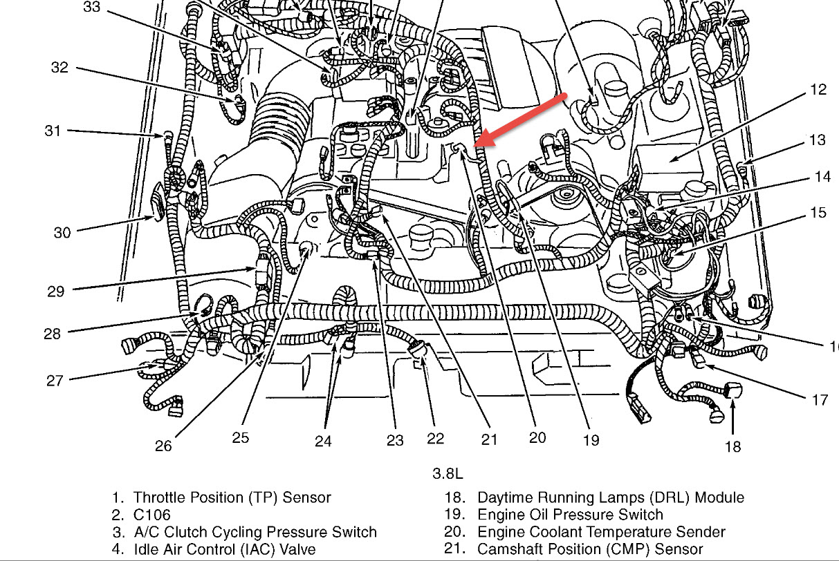

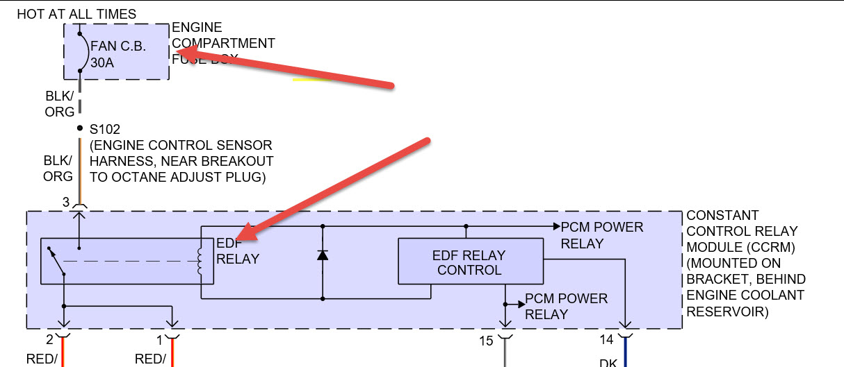

check locally as prices vary all over there is a few things you can do as well though check items in pic you may not be able toremove the relay however so it will need to be scanned if not. then check engine coolant temp switch for resistance see pics
