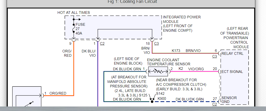

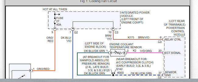

My temperature gauge is always under the half way mark but comes very close to half! I change my thermostat four times, also the hoses also changed, the relay that lays on the bumper. my cooling fans do not come on when i turn on my A/C. so i checked the blades they move fine. i also did a wire to the battery and only one fan came on. i have two fans. my belt is fine, my water pump is good. i lose antifreeze only when the engine is hot, but again it doesn't overheat. any advice will help.

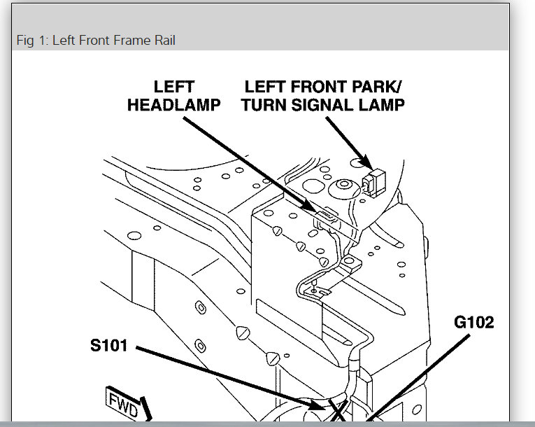

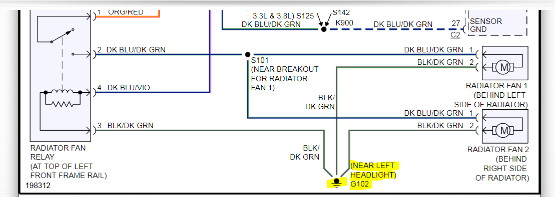

Your engine cooling fans not coming on could be a problem with Ground #102, which is near the left headlight. Please check this ground and make sure that it is clean, tight, corrosion free, and making good metal to metal contact. I have included a wiring diagram for your vehicle's engine cooling fans as well as a diagram for where Ground #102 is located at on your car. Please go through these guides and get back to us with what you are able to find out.

SO LOST
Hi im sorry i didnt mention f
The fan on the drivers aide doesn't come on with a strait wire the passenger fan does come on! I also got bump into on the driver side bumper thats when i had troubles with my engine heating up would the ground wire 1o2 also be for the drivers fan? Sorry im just learning this stuff single mom and cant afford to keep bying parts that aint broke thank you for the advice

SCGRANTURISMO
  • 4,897 POSTS
Hello again,
Ground #102 is a bolt that will have ground wires with ring connectors(called this because they are round and ring shaped)bolted to the body. This ground location is curiously on the drivers side front by the headlight. Very easy to inspect. A wire brush and a very little elbow grease should get the job done.

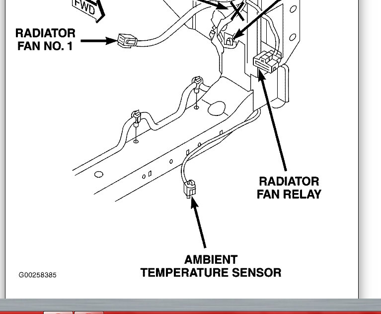

Our van just started overheating this week where do you recommend I start trouble shooting. the fan or is there a sensor in line that I will need to look at, if so where is it? Since there are two fans which one goes out first usually?

OBXAUTOMEDIC
  • 3,711 POSTS
[quote:0aacde6b3f="Kevin M"]Engine Cooling problem
2005 Chrysler Town and Country 6 cyl Two Wheel Drive Automatic 74,000 miles
Our van just started overheating this week where do you recommend I start trouble shooting. the fan or is there a sensor in line that I will need to look at, if so where is it? Since there are two fans which one goes out first usually?[/quote:0aacde6b3f]
Coolant Level....
Since there are 2 fans one should come on when you turn the A/C on.
I would start the vehicle let it run till Normal Opperating Temp. Keep eye on temp and watch to see if the fan or fans come on. If not there is a fan relay under the vehicle on the drivers side on the inside frame rail....
