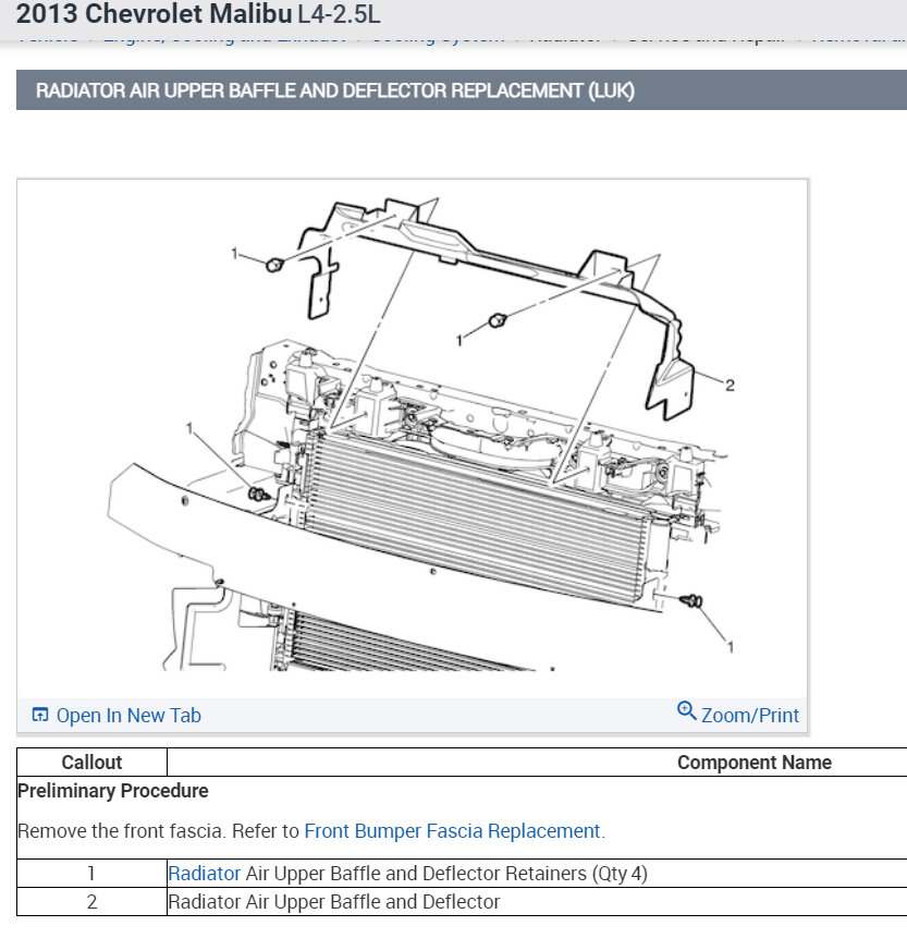

The radiator leaks coolant when I drive?
2013 CHEVROLET MALIBU
800,000 MILES • 2.5L • 4 CYL • AUTOMATIC
ANGELICA GONZALES

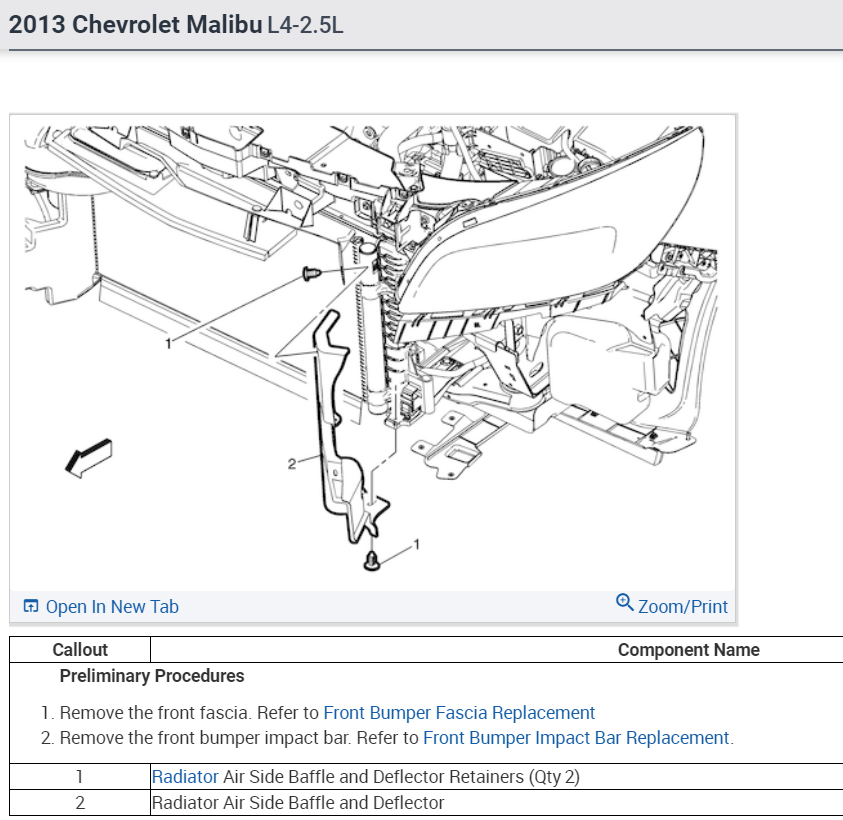

I took it for a ride to see where it was leaking from. It looks like the leaks are coming from the driver side top of radiator.
Aug 6, 2023 at 5:57 PM
  • 54,832 POSTS

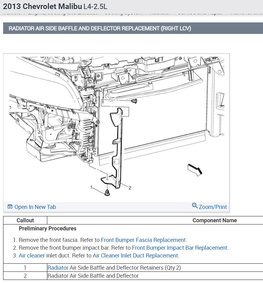

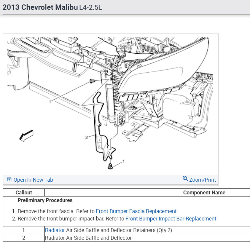

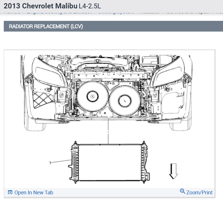

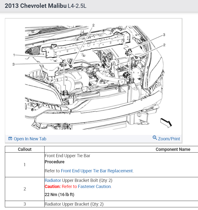

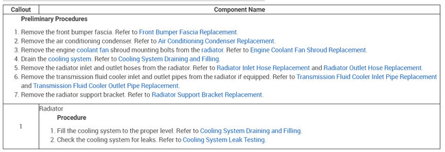

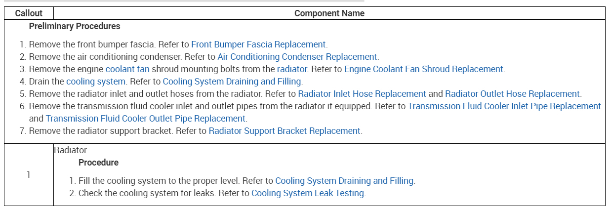

Yes, it is common for the radiator to leak at the plastic tanks, this means it is time for a new radiator. Here is a generic guide to help you step by step with instructions in the diagrams below to show you how on your car. Here is the part for $76.00.
https://amzn.to/3s7YbYr
Please go over this guide:
https://www.2carpros.com/articles/how-to-replace-a-car-radiator
Replacing the radiator in this car takes longer than some cars:
Radiator, R&R-- 3.8 hrs@ shop rate. This is because most of the front body/bumpers must be removed first. Check out the images (below). Please let us know if you need anything else to get the problem fixed.
