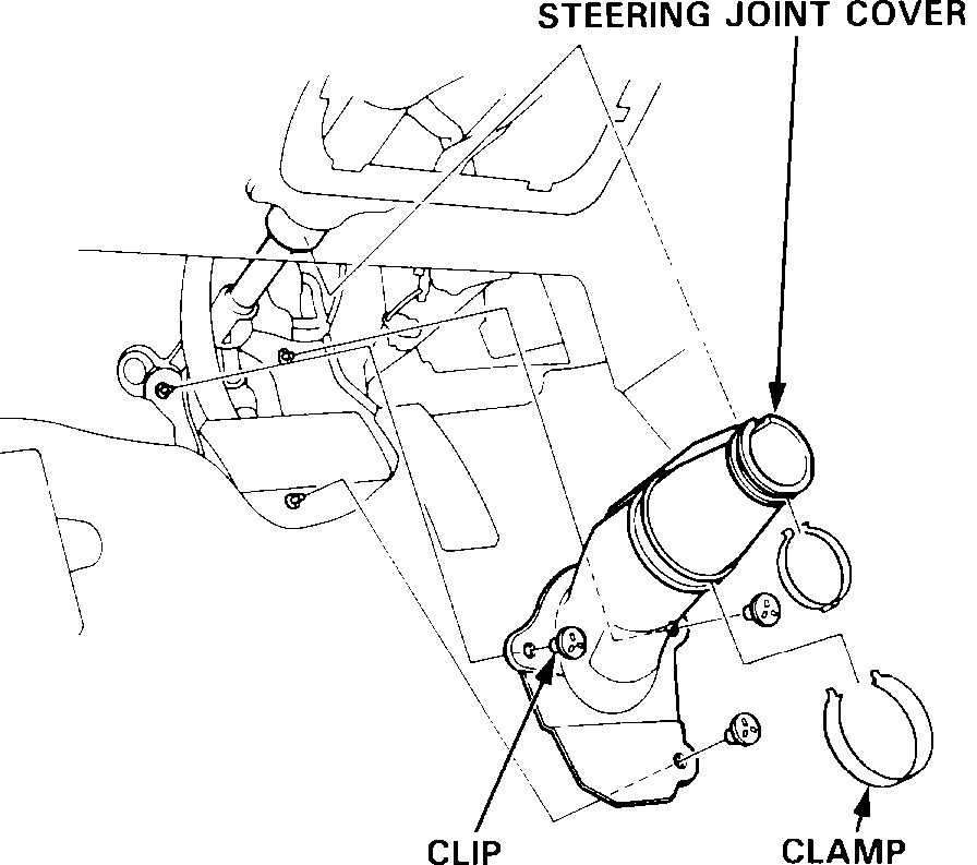

Steering Joint Cover Removal
pic 1

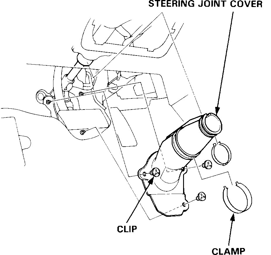

4. Remove the steering joint cover.

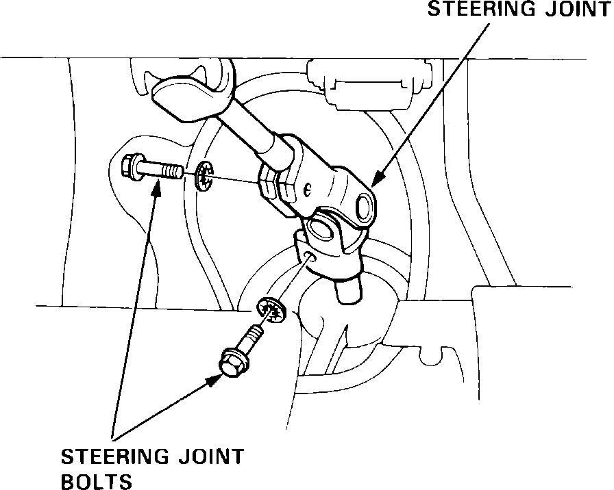

Steering Joint Removal
pic 2

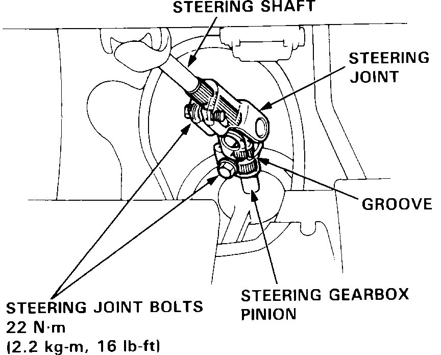

5. Remove the steering joint bolts, and move the joint toward the column.
NOTE: Lock the steering shaft with ignition key to keep the steering shaft in position.

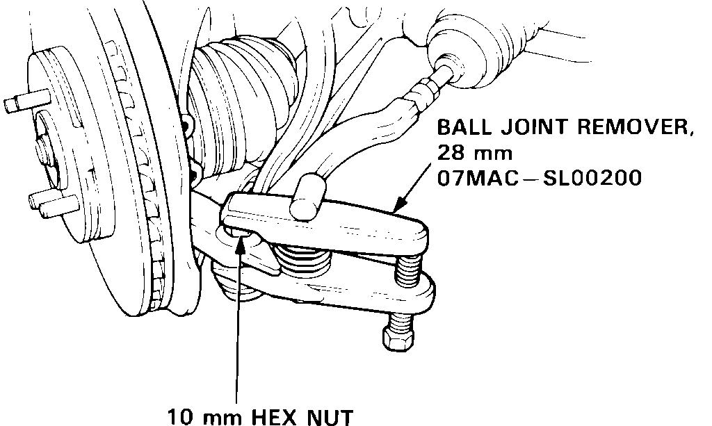

7. Remove the cotter pin from the castle nut and remove the nut.
8. Install the 12 mm hex nut on the ball joint. Be sure that the 12 mm hex nut is flush with the ball joint pin end, or the threaded section of the ball joint pin might be damaged by the ball joint remover.
NOTE: Remove the ball joint using the Ball Joint Remover, 28 mm (07MAC-SL00200l or equivalent.
Removing Tie Rod
pic 3
9. Separate the tie-rod ball joint and knuckle using the special tool.
CAUTION: Avoid damaging the ball joint boot.

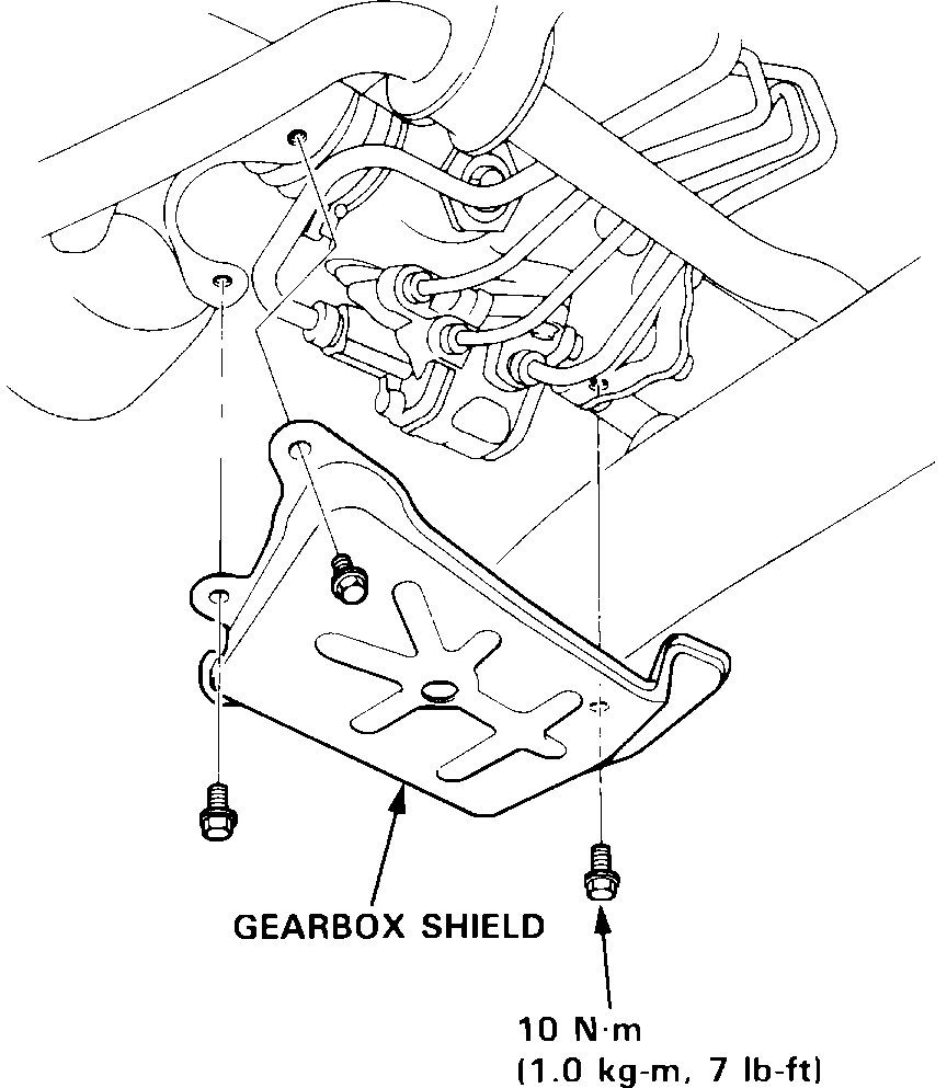

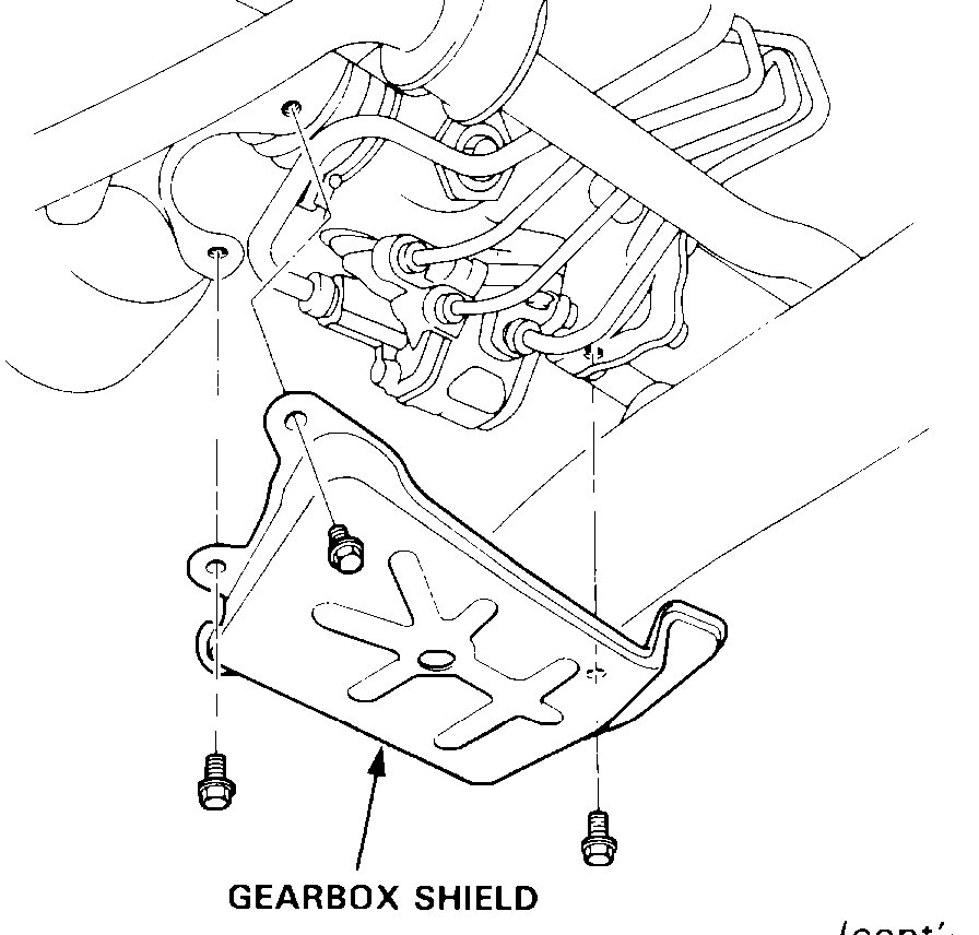

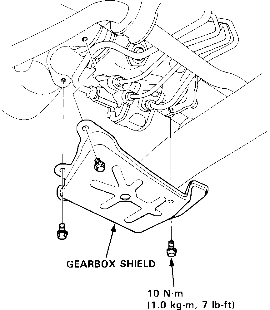

Gearbox Shield Removal
pic 4
10.Remove the gearbox shield.

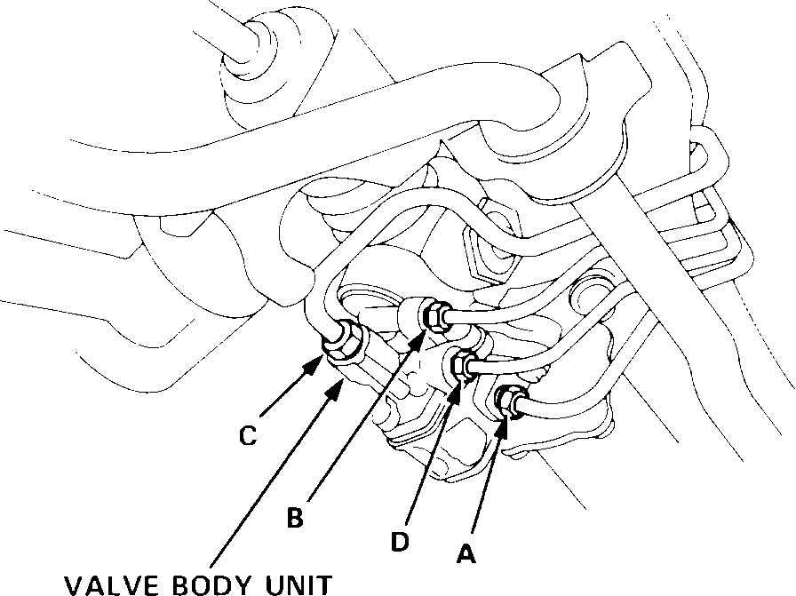

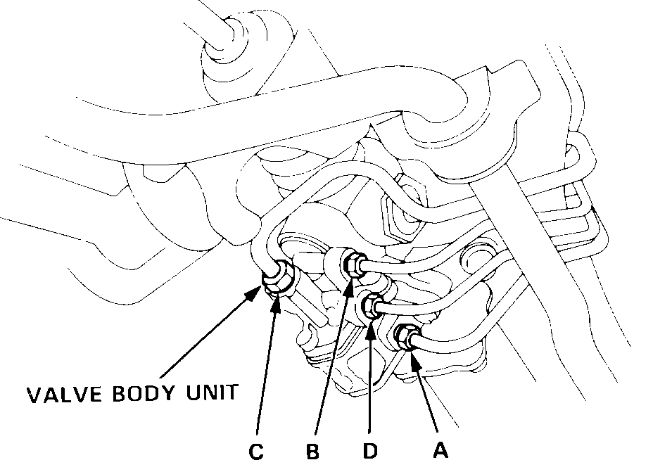

11.Using solvent and a brush, wash any oil and dirt off the valve body unit, its lines, and that end of the gearbox, blow them dry with compressed air.

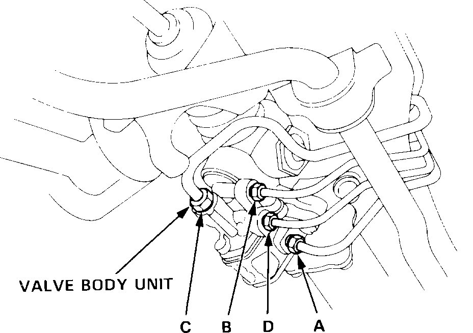

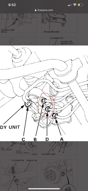

Removing Lines From Valve Body
pic 5
12.Using flare nut wrenches, disconnect the four lines from the control unit.
A: From pump: 14 mm wrench
B: To oil cooler: 12 mm wrench
C: To reservoir: 17 mm wrench
D: To power steering speed sensor: 12 mm wrench

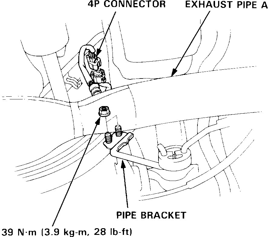

13.Disconnect the 4P connector from the heated oxygen sensor. (EX, SE only)

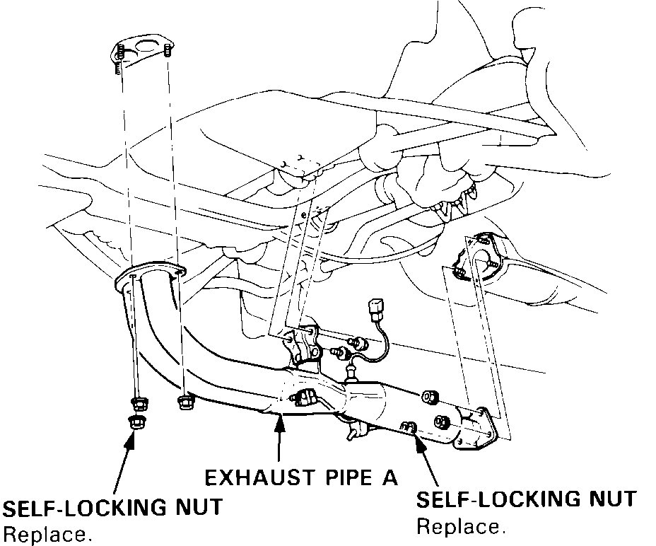

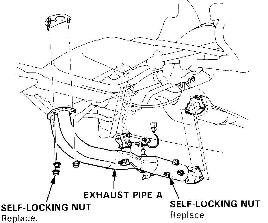

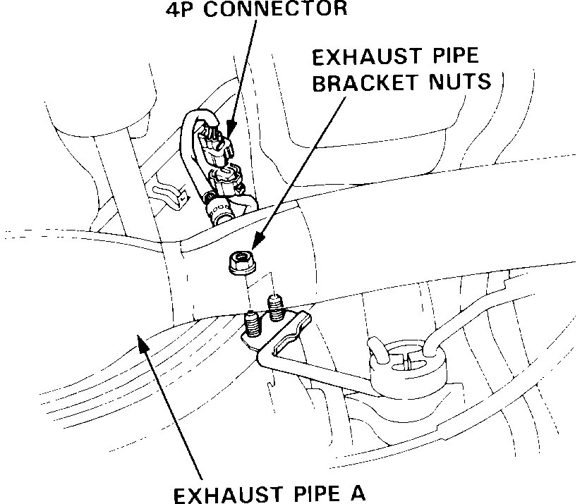

Exhaust Pipe "A" Bracket Removal
pic 6
14.Remove the exhaust pipe A bracket nuts.
15.Remove the self-locking nuts that connect the exhaust pipe A to the three way catalytic converter, and the exhaust pipe A to the exhaust manifold.
Exhaust Pipe "A" Removal
pic 7
16.Remove the exhaust pipe A.
CAUTION: Replace the exhaust gasket and self-locking nuts when you reinstall the pipe.

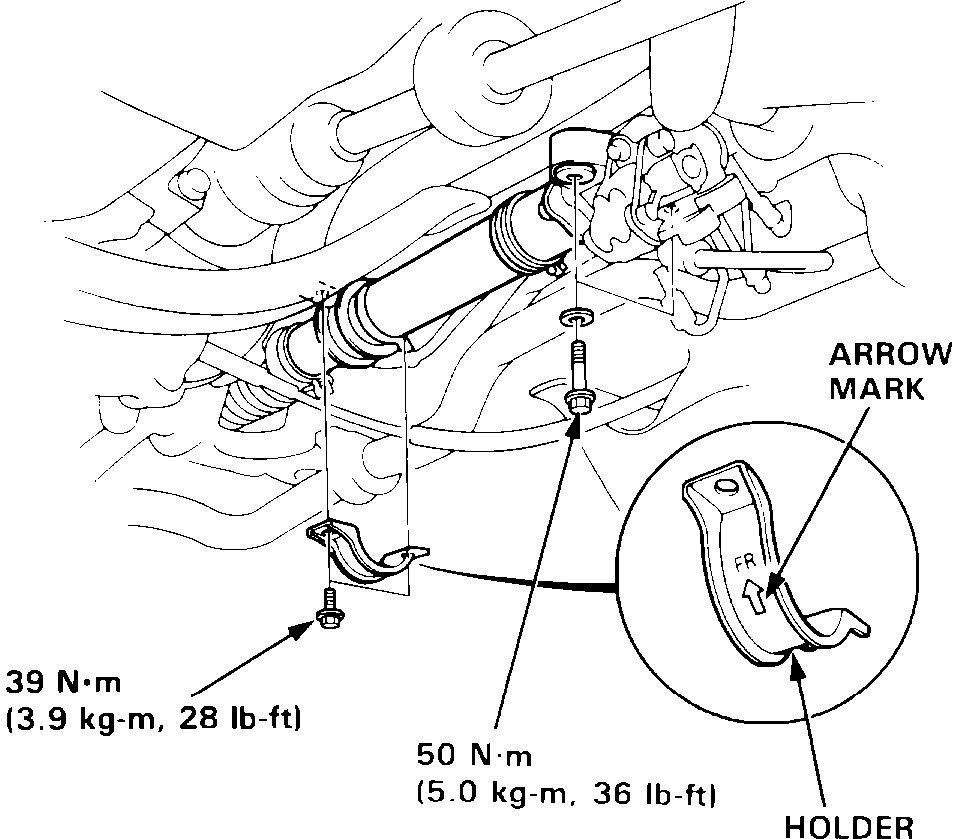

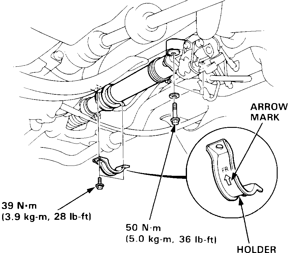

Gear Box Mounting Bolts Removal
pic 8

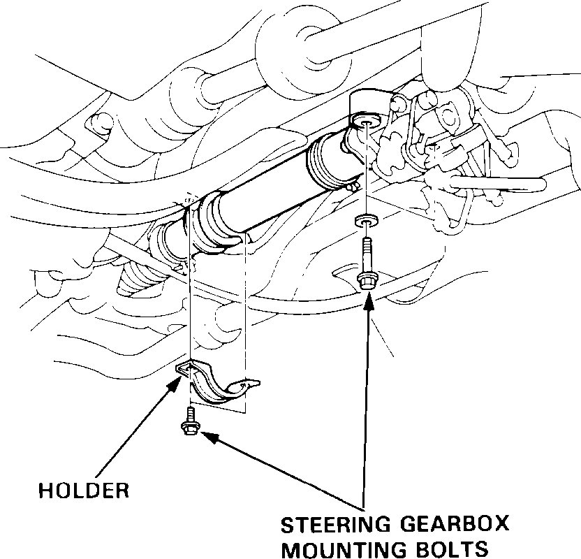

17.Remove the steering gearbox mounting bolts and holder.
18.Remove the left tie-rod end, then slide the tie rod all the way to the right side.

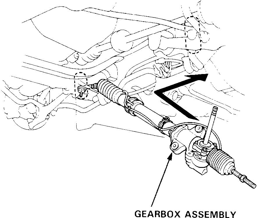

Gear Box Removal
pic 9
19.Slide the gearbox right so that the left tie rod clears the bottom of the rear beam, then remove the gearbox assembly.
CAUTION: Be careful not to bend or damage the four power steering lines when removing the gearbox assembly.

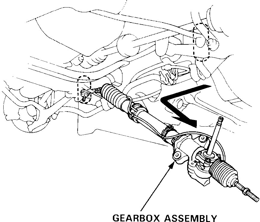

1. Slide the rack all the way to the right.
2. Pass the right side of the steering gearbox assembly above and through the right side of the rear beam.
3. Raise the left side of the steering gearbox assembly above and through the left side of the rear beam.

Installing Steering Rack Clamps
pic 11
5. Install the holder with arrow mark facing forward and tighten the gearbox mounting bolts.
Connecting Pipes And Fittings
pic 12
6. Connect the four lines to the valve body unit, using flare nut wrenches.
A: From pump: 14mm wrench 38 N-m, 3.8 kg-m, 28 lb-ft
B: To oil cooler: 12mm wrench 13 Nm, 1.3 kg-m, 9 lb-ft
C: To reservoir: 17mm wrench 29 Nm, 2.9 kg-m, 21 lb-ft
D: To power steering speed sensor: 12mm wrench 13 Nm 1.3 kg-m, 9 lb-ft

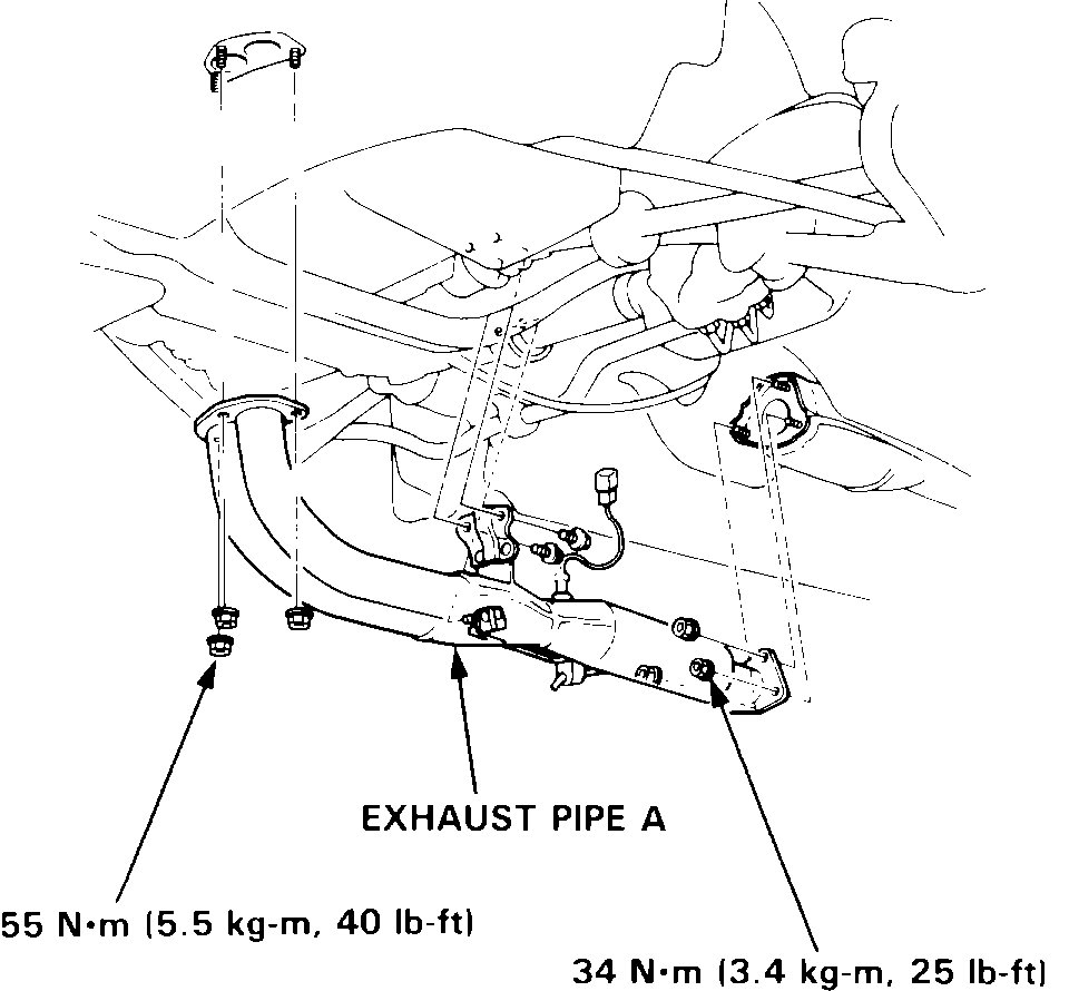

Installing Exhaust "A" Pipe
pic 13
7. Install the exhaust pipe A with a new gasket, then tighten the new self-locking nuts and bolts.

8. Install the pipe bracket.
9. Connect the 4P connector to the heated oxygen sensor. (EX, SE only)

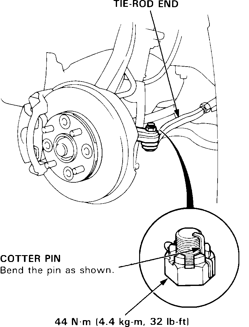

Connect Tie Rod Ends
pic 15
10.Reconnect the tie-rod ends to the steering knuckles, tighten the castle nut to the specified torque, and install new cotter pins.

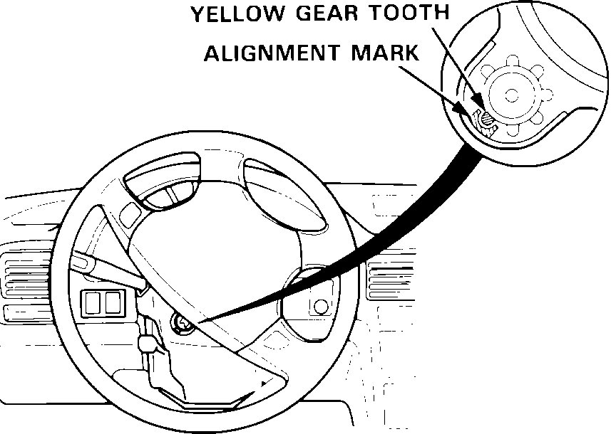

Checking Cable Reel Centering
pic 16
11.Center the steering rack with its strokes.
12.Make sure that the cable reel of the airbag system is centered as follows:
^ Turn the steering wheel left approx. 150 degrees, and check that the cable reel is in position with the indicator.
^ If the cable reel is centered, the yellow gear tooth lines up with the alignment mark on the cover.
^ Return the steering wheel right approx. 150 degrees to position the steering wheel to the straight ahead position.
Steering Joint Installation
pic 17
13.Slip the lower end of the steering joint onto the pinion shaft (line up the bolt hole with the groove around the shaft) and loosely install the lower bolt.
NOTE:
^ Connect the steering shaft and pinion with the cable reel and steering rack centered.
^ Be sure that the lower steering Joint bolt is securely in the groove on the steering gearbox pinion.

15.Install the steering joint cover with the clamps and clips.

Gearbox Shield Installation
pic 19
17.Check the gearbox for leaks, then reinstall the gearbox shield.

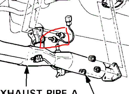

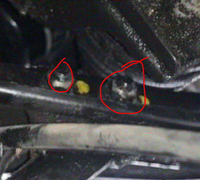

I got the 3 nuts loosened on the down pipe from exhaust manifold and I used pb blaster, a ratchet with extension and a jack handle for leverage. In picture 7, there is a bracket that has 4 nuts that hold the exhaust, 2 that go to the block and 2 that go to the exhaust from bracket. I was able to get the 2 12 mm that go to bracket off and one of the 14 mm nuts that go to the engine (the left side one) off, but the inner one is still on there pretty dang tight and I can’t get a good grip on it nor do I have enough room to get socket w extension and use jack handle for leverage. Would I be able to separate the exhaust from the lower part of that’s bracket (the 2 12 mm bolts) without having to remove the top 2 14 mm bolts going to the block?

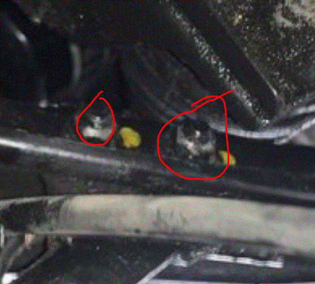

Apr 5, 2020 at 2:10 PM
  • 110,251 POSTS
I attached a picture and circled 2 bolts. First, is this the part you are referring to? If it is, as long as you remove the two I circled, the exhaust will come off. The upper bolts simply mount the bracket to the vehicle.

Yes, those are the ones. Great, thank you. For some reason that last one in the block was being a pain but I am glad to know I can remove the exhaust without having to take the last one out from the block. I will provide updates for when I fully remove the exhaust from manifold and brackets, will have to wait to finish because it has been raining but the rack has been completely separated from brackets and disconnected from lines so it should just drop down when exhaust is disconnected. Thank you for all your help. :)

I disconnected the exhaust flange from the manifold but was not able to fully drop it down due to it getting stuck on lower portion of car but it still went down and I was able to disconnect the exhaust from the bracket coming from engine block. This car doesn’t have a resonator but has a pipe instead so I wasn’t able to disconnect the rear portion of the exhaust flange that would typically be able to be disconnected. I proceeded to wiggle the rack and try to get it to drop down while being careful with the lines. I kept messing with the rack and was able to move it to the right a good amount but couldn’t quite get it to drop straight down and pull it out from the driver side after getting it to clear the inner tie rod portion. This rack also seems to have been installed at an angle to the area around the shaft where the shaft connects to the steering wheel was at an angle and not centered as it should have been. After 2 hours of trying to get the rack to lower I realized that I did not remove the exhaust hanger from bracket which I believe is what was stopping me from getting rack to lower on side connecting to wheel. Do you know what size the bolts are for hanger bracket ? I sprayed some pb blaster on it for now and will clean it off tomorrow to try and remove it which hopefully will give me the angle needed. If that doesn’t do the trick I believe I will have to cut the exhaust.
Apr 6, 2020 at 12:30 PM
  • 110,251 POSTS
Hangers are usually either 1/2" 3/4" or 14 or 15mm.

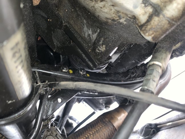

I can’t seem to find a socket and ratchet or wrench to fit on the buts for exhaust hanger bracket, very difficult angle. Any tips?

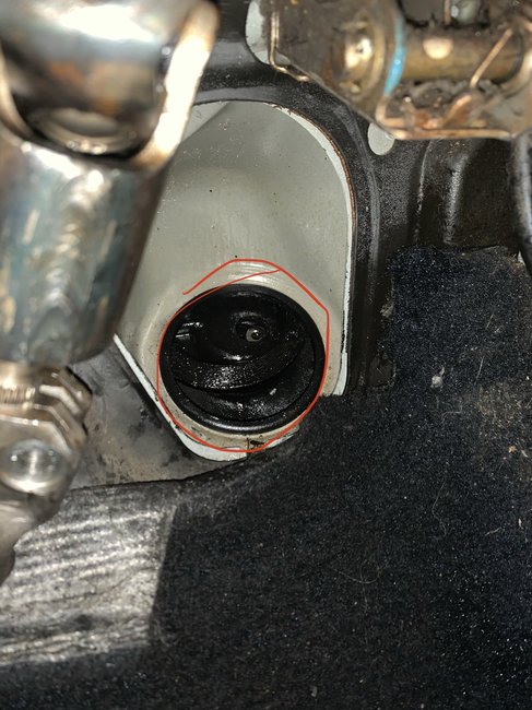

Also, what is this part? I’ve seen other videos of rack removal but haven’t seen this one and it was crooked and not centered before I got to the rack.

Are these the bolts? See pic 1. They look like they are either a 14mm or 15mm. As far as getting them, the left one doesn't look too bad, but the right will require a box end wrench because there isn't enough room for a ratchet.
As far as the second pic, what is that attached to or mounted to? I can't determine location.

Yes, those are the bolts, thank you, I will try to get the bottom w box wrench and the top one should be easier but it is a bit tight. The second picture is right below the steering wheel where the shaft would connect to the steering wheel. I see the boot that goes on shaft connecting to the steering wheel, rack is almost out but that area I circled confused me a bit because the shaft from rack runs through there and it is causing me to have to pull the rack out at a weird angle and it is crooked so I am not sure if I need to replace it when the rack is out or simply readjust it?

I would think you would be fine if you can just straighten it. It looks like it is just a rubber boot that the shaft goes through.

You are correct, it is a rubber boot for shaft to go through. I have gotten the driver side of the rack dropped as far as it will go for now. I have yet to get the bracket for the exhaust off. but think that will allow the rack to drop straight down for the shaft to clear.

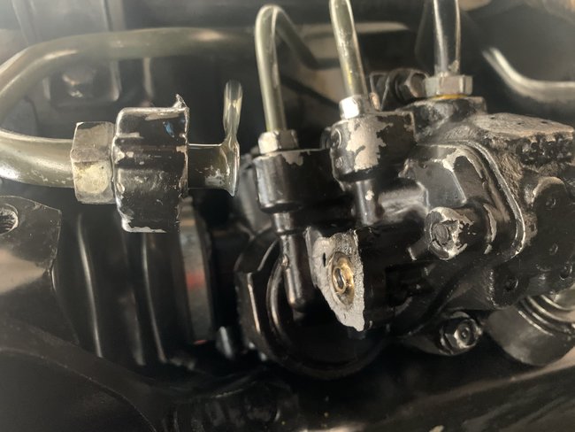

Everything was going smooth and I was ready to finish installing lines. I installed them smooth but was tightening them to get them all the way seated in. I must have tightened the 17 mm line too much and a piece of the gearbox broke off, luckily I got the broken piece off and that line was fine but then I realized this rack was going to need to come out and I was going to have to install a new one. Again. There was one bolt that was semi stripped so I knew it was gonna be tough to get out but I tried and in the process bent the other line. Both of the 12mm lines will need to be replaced I believe. Lines B and D. Is there a diagram and where can I find new lines? Can I cut them and put new fitting and use those with new rack? I don’t know what to do.
Apr 13, 2020 at 1:29 PM
JORDAN013
  • 55 POSTS
Broken piece.
Apr 13, 2020 at 1:31 PM
  • 110,251 POSTS
OMG! That is terrible! I feel really bad for you. However, don't think you are the only one this has happened to. It can happen to anyone.
Listen, I'm not sure what parts you are referring to. The steel lines should be okay. Is that what you are referring to, the steel lines?

Yes, the one that goes to power steering speed sensor and the one that goes to oil cooler I believe, but I don’t know how I would get them out and where I can purchase them?

Planning to cut off the damaged parts of the 2 lines tomorrow and get rack removed then I am thinking of either using a compression union to join the line to another section of line same diameter and same end connector for when I install the new rack. Option 2 would be if I have enough length on the pipe, I could get a flare kit to flare the end and put new adapter on it which would allow me to thread into new rack and pinion. What do you think of these options? Would they work? Since these lines go to the cooler and power steering speed sensor, would the unions be able to handle the pressure?
Apr 13, 2020 at 4:19 PM
  • 110,251 POSTS
Anytime you add a union, there is a chance it will leak. In theory, it should be able to handle the pressure. Well it is another question.
If the pipe is long enough and you can flare it, that is what I would do. Double check if a double flare is needed. I suspect it is due to the amount of pressure it will have.
Let me know if I can help.
Apr 14, 2020 at 2:34 AM
JORDAN013
  • 55 POSTS
Sounds good, I will try to work With the pipe. Do you know where I can find the end connectors that go into the rack And what is the diameter of the connector and that goes into the rack?
Apr 14, 2020 at 2:43 AM
  • 110,251 POSTS
Honestly, I don't know the specifics on it. However, if you remove the old one, a part store or even a hardware store may be able to help.
Apr 14, 2020 at 3:11 AM
JORDAN013
  • 55 POSTS
Thank you, so far I removed the exhaust and bracket and disconnected the other 2 lines that are good. Started to cut bent line but cutter broke so I need to return it and get another one. I think I should have enough meat on the lines to make these work after flaring; need to talk to seller to see if I can get a replacement rack.
Apr 14, 2020 at 4:24 AM
JORDAN013
  • 55 POSTS
Looks like once I get the fitting on the lines I can get them to reach the rack but would I need to bend the area where it curves a bit to get it straighter for the fitting or?
Apr 14, 2020 at 10:18 AM
  • 110,251 POSTS
Yes, don't be afraid to manipulate the steel line. Just make sure if you bend it, it won't hit something that can cause damage or make a noise that will drive you crazy. LOL
Let me know how you make out. Also, the new rack should be replaced because I feel there was an imperfection in the casting or it was damaged when you received it. I never saw that happen before.
Let me know how things are going or if you need anything.
Apr 14, 2020 at 11:03 AM
