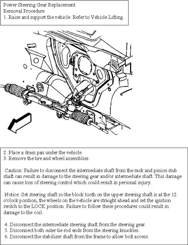

Hello, I'm looking for a walkthrough to remove and install a rack and pinion.
Dec 30, 2019 at 11:21 AM
CARADIODOC
  • 34,381 POSTS

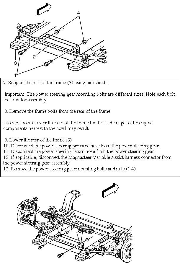

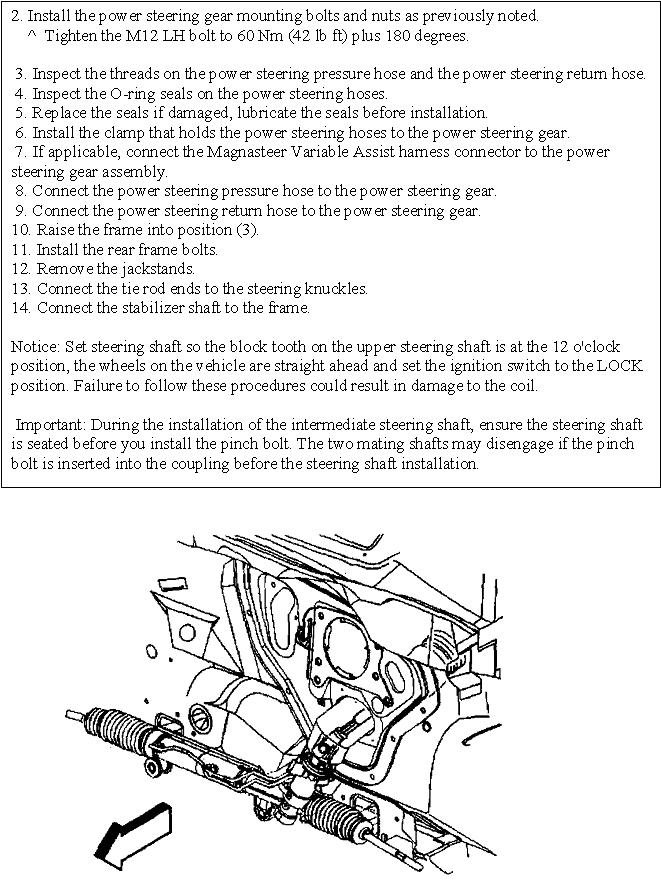

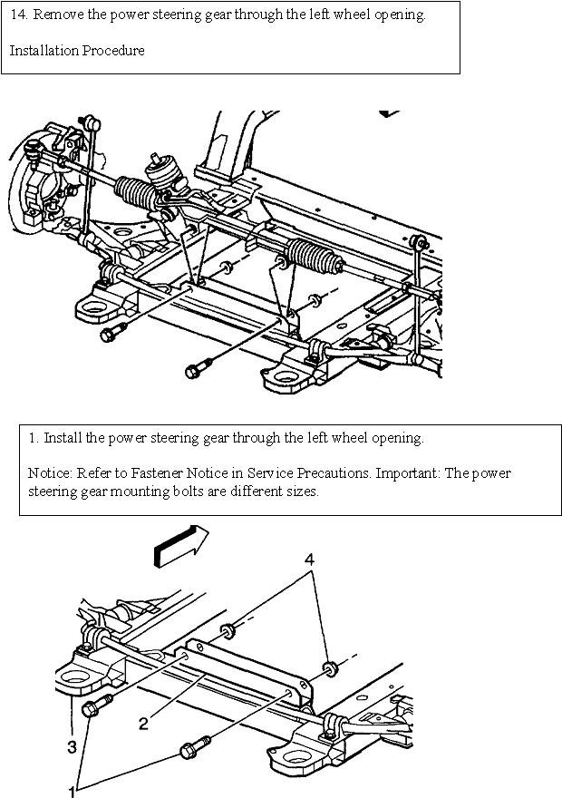

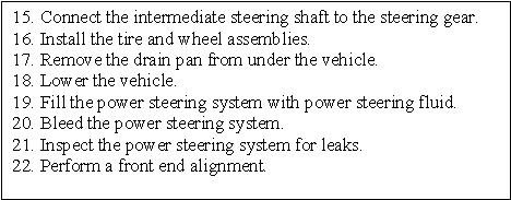

The service manual procedure is shown in the five drawings, but there's two warnings they didn't mention. The first one applies to all cars and trucks with air bags. They all use a "clock spring" under the steering wheel. That's a wound-up ribbon cable in a plastic housing. It can be wound up and unwound a total of just slightly more than the range of the steering system from full-left to full-right. It is imperative that you start with the steering system centered, then use some mechanical means to lock the steering wheel there. Be sure the new steering gear is centered when you connect the input shaft, then you can unlock the steering wheel. If you allow the steering wheel to rotate one or more turns either way in relation to the new steering gear, the ribbon cable is going to break. Either it will wind up too tight and snap off on one end as soon as you turn fully one way, or it is going to unwind too far and fold over on itself. That will happen multiple times, then it will break days or weeks later.
The second warning has to do only with GM front-wheel-drive cars. To my knowledge, this doesn't apply to any other car brand. To remove the steering gear, the procedure includes lowering the engine cross member. That is welded in place on Fords. Chrysler uses special bolts that force the cross member to go back to its original orientation upon reinstallation. GM doesn't do anything to insure that cross member goes back to its proper position, and if it is off-center by as little as 1/16", it will create the most miserable car to drive. You have to mark the location of the cross member in some way to insure it goes back together exactly the same way.
