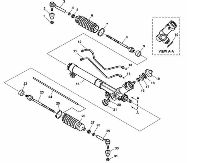

2002 Gran Prix I R and R the rack.Now I can't run or route the hose from the pump to the rack.And I can't connect the intermidate shaft to the rack.All fittings are not lining up,they just keep spinning.I need diagrams.
Nov 14, 2018 at 5:54 PM (Merged)
JDL
  • 16,098 POSTS

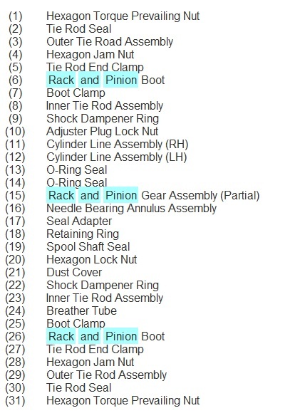

I can't see much from here, exploded view below, hope it helps.
JDL
  • 16,098 POSTS
If you saying the threaded fittings don't match, maybe you got the wrong rack, or your trying to thread the supply into the return or vise-versa.
MICHAELJTOMCHUCK
Diagram didn't help,I was hoping for your experence,Again that hose has too many bends and angles.Thank-you I took the rack out and tried the fitting and it worked.Right rack right fitting.I think that the rack is too high making it impossible to properly line up the hose to the rack.
