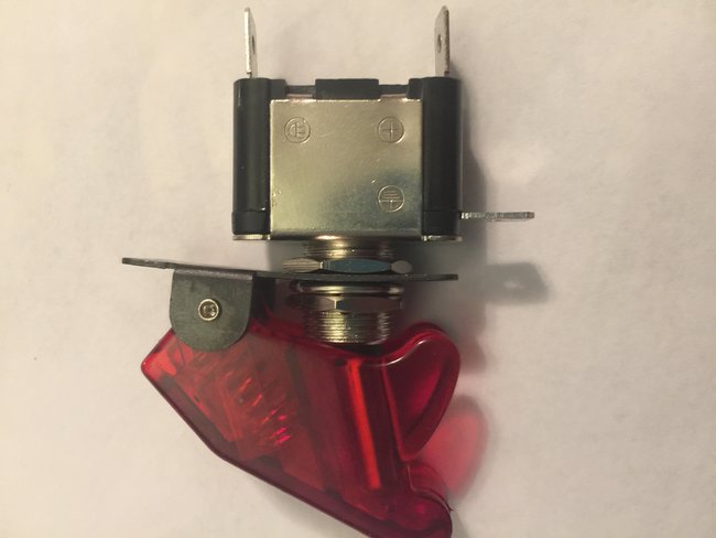

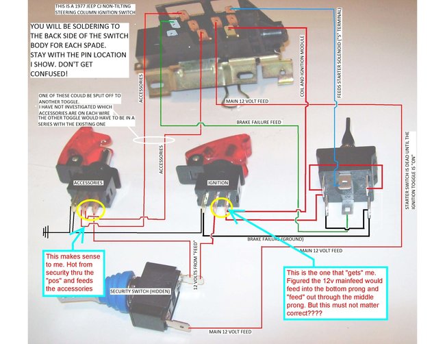

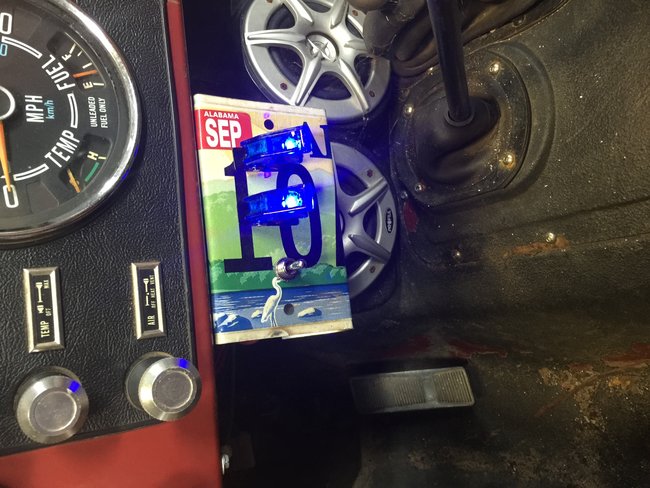

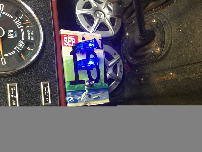

Required no tweaking. Made the pin adjustments as we discussed and SMOOTH sailing from there.
Just took my time checking, re-checking & triple checking all of the connections.
Plugged her in and she fired right up!!!

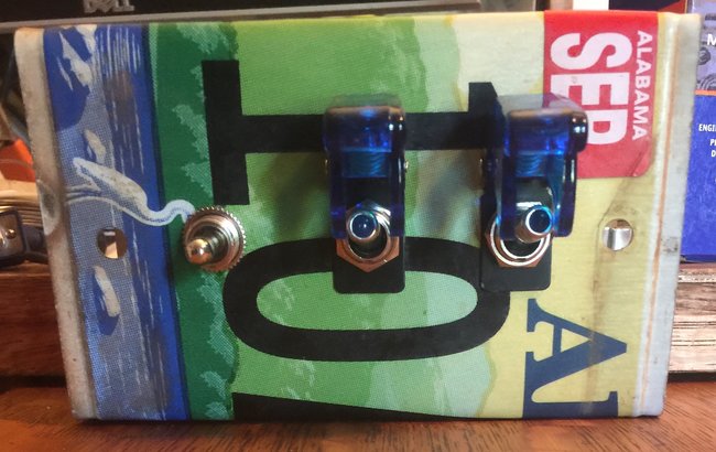

Thinking I need to label these safety toggles. Maybe "MASTER ARM" and "EJECT"
Sep 29, 2016 at 10:50 PM
CJ MEDEVAC
  • 11,000 POSTS
"Enable Mini-gun", "Cloak", "Start Turbine", I'm sure you could top these!
"Eject" just can't be topped!
Send a pic of that puppy installed.

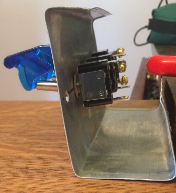

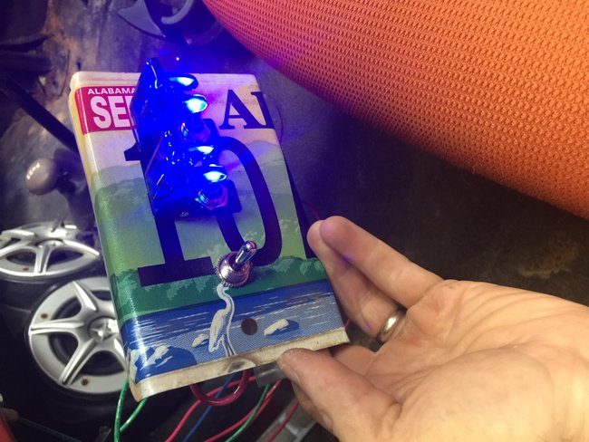

Here's a pic of it installed ......not sure why it gets rotated after uploading

I just saw your post. Apparently the 2carpro notifications got to my junk email half the time.
Mod is working great!!! Love it.
