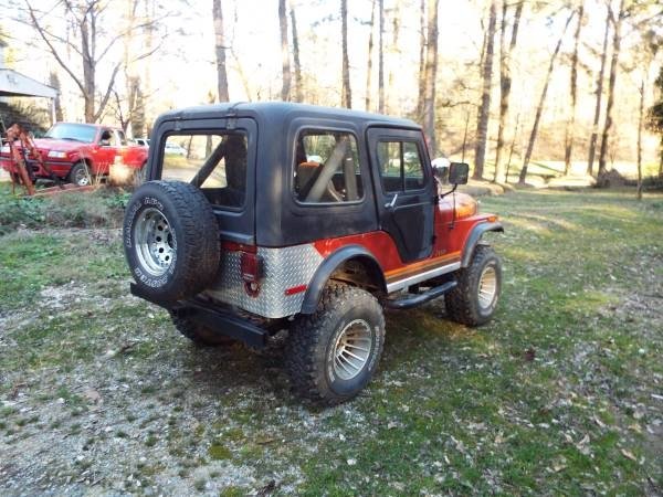

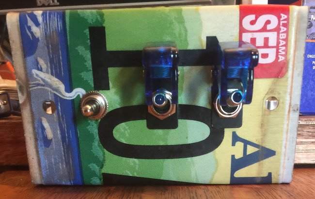

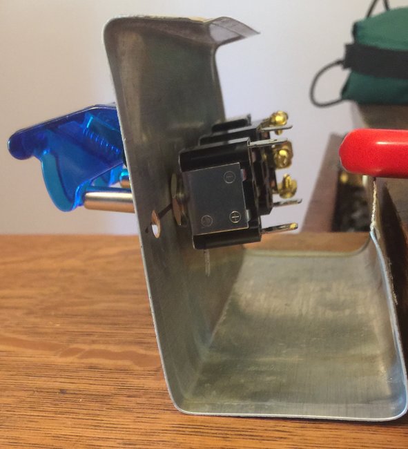

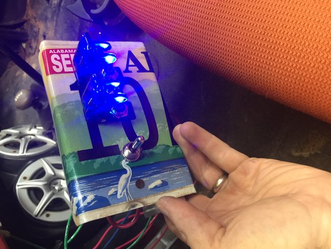

Picture one) How it looks on my dash, I may add a third safety toggle later.
Picture two ) Completed unit, modified ignition switch in my lower hand. My buddy could not believe I finished it and plugged it right in with no problems or no need to troubleshoot any mis-wiring.

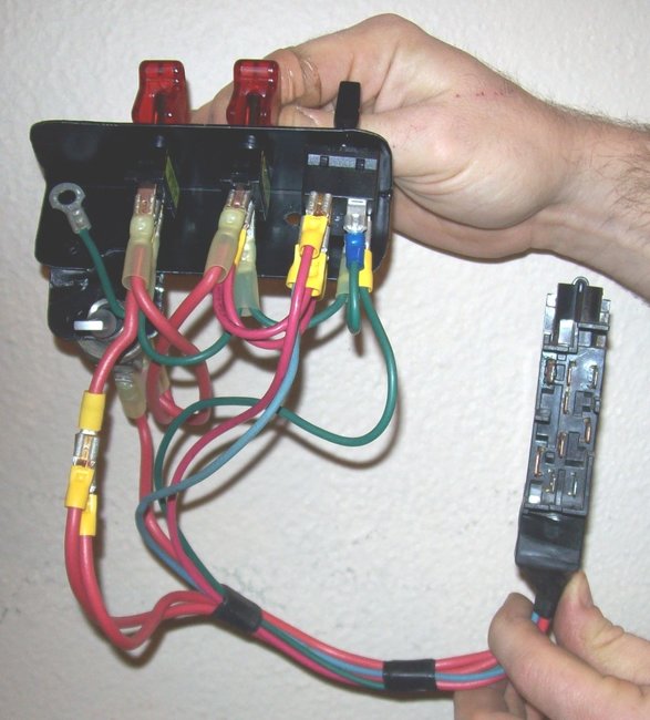

Picture three) See! the original harness clips right in to the modified ignition switch and it can be totally removed and put back to the old way in a jiffy, if need be! (if you get another OEM ignition switch)
Picture four) "Mr. Jeep"

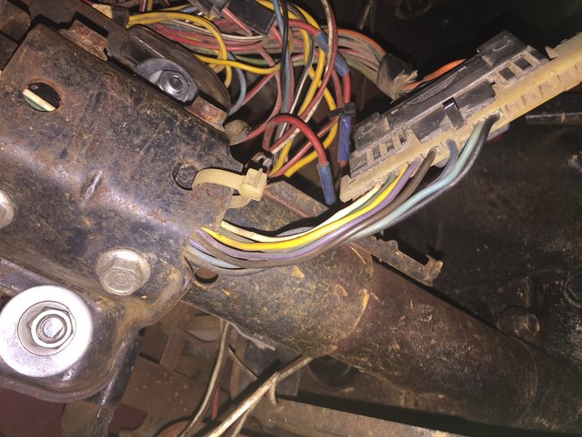

Here are a couple more pictures to show you what I am dealing with. I guess these wires are going up to the ignition switch on top of the column.
Sep 18, 2016 at 11:29 PM
CJ INPROGRESS
  • 26 POSTS
I believe the previous pictures are of the turn signal switch assembly. Apologize for the multiple replies.

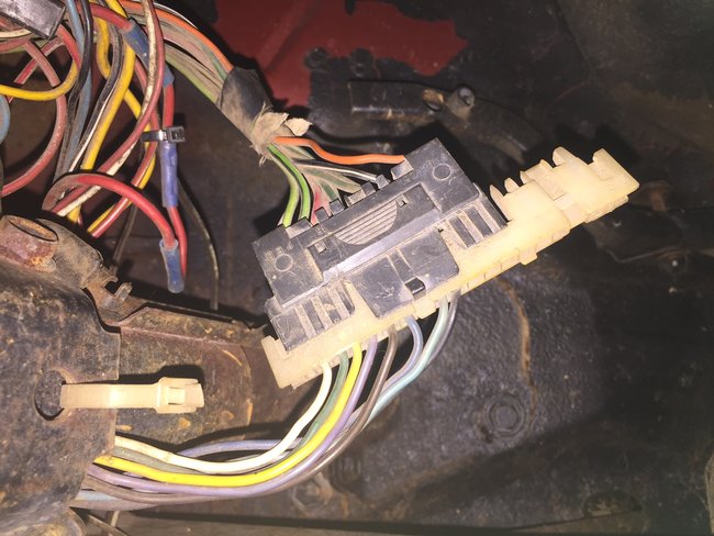

1) I removed the turn signal connection, you can see the 2 connectors for the ign switch above it
2) Drivers side door to access switch
3) Free at last!

Gonna show you a couple or 3 or more pics of what you are up against
Insure you have the straight column ignition switch (tilt is a mirror image of it) See link

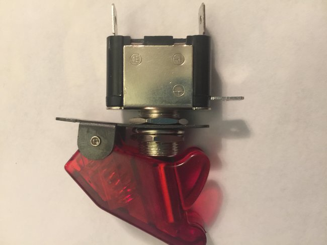

You can use any kind of toggles you want
I got these two lighted safety toggles at Radio Shack for about $5 a pop
The momentary switch is spring loaded back to center ("off") and is momentary up or down, whichever way you approach it (starts either position). The one pictured is from Radio Shack, it was not heavy enough in amps (lasted a few weeks). I wound up getting a heavy one from an electrical supply house about $8 (I'll try to find out the amp rating for you). It has 6 male terminals (3 are for one side, 3 for the other)
One set of three are used for starting, the other three are used to verify the brake system is operational.
The original ign switch performs the "Brake test", You and I just didn't know it! While cranking, your brake light in the speedometer blinks real fast. If it does not, either your brake hydraulics may be malfunctioning or your bulb is blown! This test is also checked in places that require inspections.
The third toggle is an off/ on - strictly for security- kills everything- Sorta hid outta site. Also from Radio Shack.

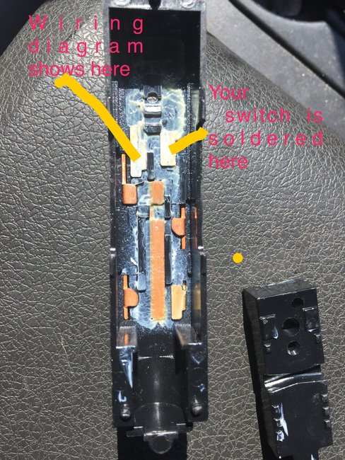

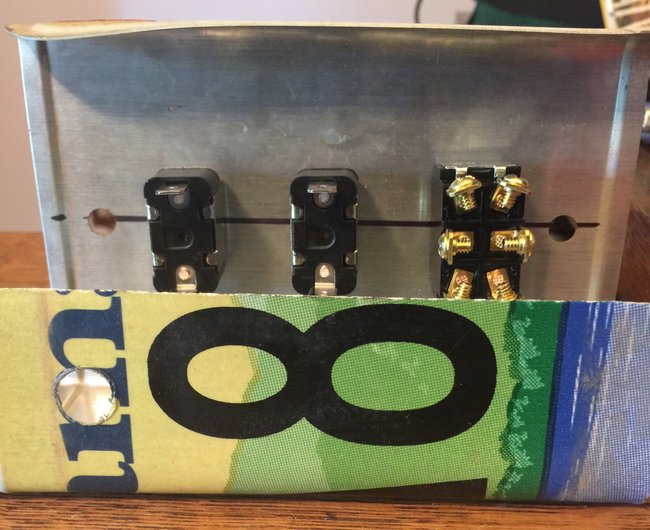

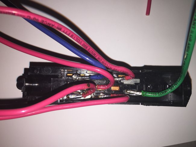

1) showing you the disassembled ign switch
2) This what we are gonna solder on- the opposite side from the male spades
3) Don't solder nuthin' yet! This sorta what it will eventually look like (I used my old one and had to clean it real good before I could solder). Wait till I get to the diagrams! I am using wire I had on hand, if you change colors, you will have to keep track of which color it takes the place of.
4) the goodies, less the aluminum angle iron mount

I verified that I do in fact have the straight column ignition switch. Is the switch fairly easy to take apart? From the picture, it appears it just kind of "unsnaps"
I will get to work getting some toggle switches. Will this switch work for the momentary ?Says its rated for 20 amps.
https://www.amazon.com/Heavy-Handle-Momentary-Toggle-Switch/dp/B000LFVFA8/ref=pd_sim_sbs_263_1?ie=UTF8&psc=1&refRID=NKTC39P8XGTZSEJX05EE
Would it be OK to wire everything using 12 ga? or do I need to plan on getting some 16 ga wire as well? I'll probably try and mimic what you did just because it will be easier for me to trace my steps.

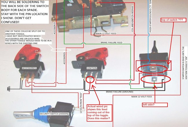

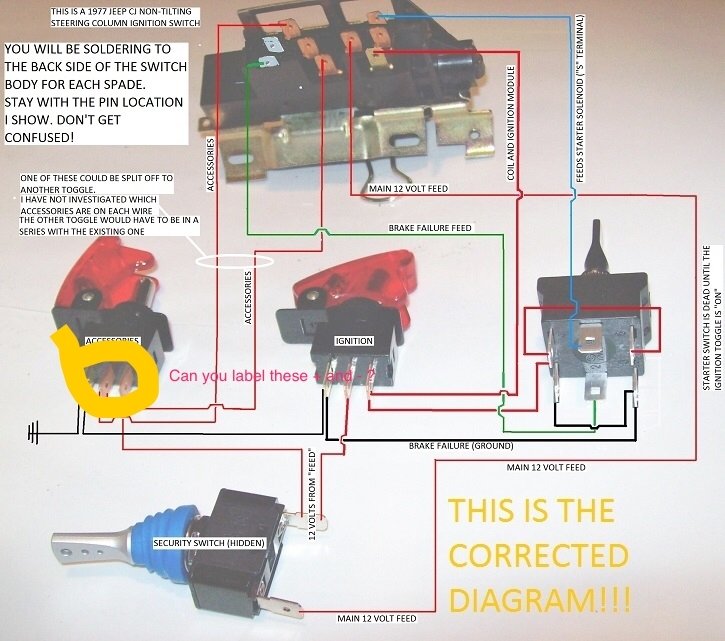

I had to revamp my original computer drawings! Hard to read as I originally done 'em. Now that I talked the Wife out of the 46" Flat screen for my monitor ('course she got a 55" to take it's place) It's a lot EZer to see and use Microsoft Paint.
You can use piggy-backs on the the terminals to save room like I did or looking back on it,
It mighta been better if I had maybe just crimped 2 wires into the same connector, in those that share the same spade. That woulda cut down on a bunch of crap in the tight quarters.
Look my work over (best you can) I'm not as perfect as the females think I am! I looked it over 4 or 5 times after I got done.
When I soldered, I had a spray bottle of water to cool things off before I started melting thru to the other side.
Remember in this diagram, you are not soldering to the terminal the colored line is to! You are soldering to the other end of that terminal. (On the backside of the ign switch)
Let me know if you understand all of this.

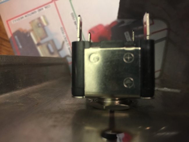

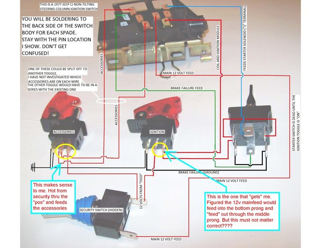

Once again, Great pics and info. I understand the wiring for the most part, but am still 15% ignorant when it comes to electric current, so bear with me.
Question 1: Is there a "top" or "bottom" or "left or right" to the momentary switch. I understand that the switch is basically split down the middle from top to bottom and that the "middle" poles feed from the ignition switch. I can't really tell from the pic which way the switch is laying. If its like the toggles in the pic, the "top of the switch should be to the far right. I've attached a (pic 1) that may help.Disregard the "left side" comment because obviously that would change depending on top or bottom. Was just trying to figure out which was top and which was bottom or if it even matters.
Question 2: The second toggle in the diagram appears to be wired a bit different in your actual harness(pic2). I made a note on the pic below of what I am talking about. Could be that it makes sense where it is, but with my limited knowledge, just want to make sure.
Question 3: Do you recommend 12ga wire for everything?
Question 4: I have not procured the new switch just yet. Any tips or tricks to dissembling it?

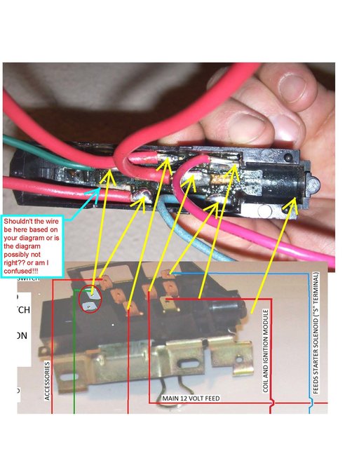

I've been studying hard and just wanted to make sure I am SURE about all this. Had another question regarding the ignition switch as well. It appears to me that the wiring diagram is showing a different pin to be soldered to for the brake failure feed when compared to the actual switch you show. I've attached a pic that may help. Disregard the "extra" yellow arrow in the far right of the pic. I forgot to delete. Apologize for peppering you with all these questions! Thank you in advance for your patience!!!
Sep 23, 2016 at 12:02 AM
CJ INPROGRESS
  • 26 POSTS
I think I just couldn't see the pin to solder to in the pic. Pretty positive you have it correct. Didnt mean to question your expertise!!!
Sep 23, 2016 at 12:24 AM
CJ INPROGRESS
  • 26 POSTS
Got the switch and have it apart. I'm still convinced the wiring diagram may be showing the brake failure feed on the incorrect pin to solder to. Attached pic of switch

I really wish I could edit my response. I'm positive you have it soldered correctly with the diagram.........I think. Thanks again.

Time flies!
I made that mod in 2007 and took most of the pics then.
A few years later somebody wanted a diagram, I was not as"in tune" with all of the researching and checking and double checking that I was doing "for me" originally.
I did really try to make the requested one right.
Upon looking it over for you, I did try to simplify it, as I looked at it "NOW" it just looked too complicated.
Sooooo, I just re did the whole generic pic of the switches just for you!
Yep, I did put the wire in the wrong spot on the diagram! I got it fixed, verify that!
I have a few more pics I made to keep me straight back then, I thought their poor quality would confuse you so I didn't post 'em.
You can use your switch in any orientation.
To keep you on track as far as the spades go, if you have the toggle moving up and down, on the backside, the 3 on the left go together and the 3 on the right go together. A voltmeter continuity test will prove this.
Let's try the right side 1st. If you put one lead in the center and the other above or below on a terminal, then flip (and hold) the toggle, the one above or below center will show continuity. Move to the other terminal and the toggle the other way. The Left side will work the same. THE LEFT AND RIGHT SIDES ARE NOT CONNECTED!
This switch can be used in various other ways!
Below
1) Combining 2 old pics, to see where I messed up making your diagram.
2) Same pic above, just the full size
3) Same in pic 1, This one is not turned upside down! Not rotated either!
I'm gonna reply below this post so that the Corrected version is all by itself!
Keep me straight, your turn!
The Medic

CJ MEDEVAC
  • 11,004 POSTS
THIS IS THE RIGHT AND CORRECTED DIAGRAM!
The Medic

Appreciate the updated diagrams!!! I thought I was going crazy analyzing all that today. I'm tryin to learn as I go and not just trying to get the mod completed.
The momentary switch explanation makes sense .Going to stick a multi-meter on it tomorrow and check it out.

CJ MEDEVAC
  • 11,004 POSTS
That little mess up had me checking and rechecking forever! You know, I still feel unsure!
I think it's right now
The black wire on the Jeep connector plugs into the spade that was in question. On the Jeep connector the 2 yellow wires (together) are on the same side as the black wire
So when you flip it upside down, turn it around, and punt that puppy...
I had to find the "OTHER SIDE" of the 2 yellow wires, that told me which side the black was on.
More flipping and turning in my head! As the Jeep connectors are not shown in the PUSH BUTTON diagram
I arrived at IN THE FINISHED DIAGRAM, Where the 2 YELLOW Jeep Connector wire would hover above the Ignition switch. This would be the black wire's side too.
Sorry, you seem really into it too! Am I right now?!

Well.... here's the soldered up switch. Hope it can pass The Medic's inspection. I tinned the wires up real have prior to adding them. Connections are extremely strong.
Now the challenging part (at least for me) ......wiring the switches.
Got to make a "dash" to mount them on and Waiting on connectors to arrive from Amazon.
Will keep you posted .

CJ INPROGRESS
  • 26 POSTS
Here's my "dash". Gotta get my security toggle still. Going to mount it so the switch is in the "channel" facing towards the front .
Used and old license plate . I'm a "use what you got kind of guy" .

Quick question. Can you label or confirm the polarity of the prongs for me in the attached pic?
My toggles are configured a bit different , so I would like to be sure.
Based on your diagram it appears that prong closest to the ground is the negative and the next prof over is positive .
Is this correct ? My prongs are backwards from yours . Positive being on the bottom.

Always leaving something out, assuming the other end understands the little stuff!
I'll back up a bit.
The safety switches I used are ON/OFF (2 positions only)
https://www.radioshack.com/products/safety-switch
Notice it has 3 spade terminals. On "mine", 2 terminals are copper colored and the 3rd is sorta silverish.
The 2 copper ones are actually the "switch"
The silver one is simply a ground for the lighted tip of the toggle. If you don't want the lighted tip to shine, you just don't ground it!
Now, I chose to have my 2 switches to light up when "ON", so I grounded them! In the quest for simplicity, I jumped from one to the other and only gave it only one ground.
Here's the good part!
I also JUMPED the brake failure's ground in along with it!
Soooooo, I only had to make one ground connection to the dash/ body.
Now to make this a bit more able to understand!
I coulda just bought 2 Plain Jane ON/ OFF toggles (no bells and whistles) They woulda only had 2 terminals, when turned "ON" the 2 wires would connect together/ when turned OFF, one of 'em would go dead.
So on the 2 terminals (that are switched) IT DOES NOT MATTER WHICH ONE IS HOT OR WHICH ONE TRAVELS TO THE ACCESSORY!
However in this scenario, we have no grounds for lights, We must ground the brake failure ground to "ground" all by itself.
Here's my concern
Did you buy 3 position switches for "IGN" and "ACCs" (as you saw 3 terminals on mine)? Which would be wrong.
Or did you buy 2 position switches (like mine) (lighted?) (w/ 3 terminals)
If you have lighted switches (3 terminals-like mine) Are the switch bodies marked to distinguish the switch terminals from the "light's ground"?
I really don't mean to make this hard! Or hard to read!
Oh Yeah!
Your solder job looks great!
Your Turn

I bought switches like yours. The ground is just on the bottom and not on the top like yours.
My switches are marked. + on the bottom terminal and acc on top terminal. Looking at the diagram you made, it appears that your switches are similar . + coming on the bottom and acc in the middle , ground up top.
I think I have it, just want to be consistent with what you've done in case I run into issues.
Going to go slow and methodical when I begin "assembling " this. My connectors should arrive here Thursday .
Here's a pic of one of my switches

Like I said, The wire is really positive as it comes to the switch from the "Hot source", it's also positive as it leaves the switch.
What? That's stupid!
Think of this DC set-up as:
There is no switch at all!
Let's say the wire came from the ign switch (Hot 12V), let's run thru your switch holder (not the switch), make a hard bend in the wire
From that bend, we're going back to the ign switch.
Let's hook on to an accessory wire that you have already soldered in.
Just for giggles, pretend this wire runs the heater fan (other stuff too)
Well right now
You can turn on the heater fan with it's switch, Any time! The only control is the switch on the dash. Anytime!
Let's kinda look at the circuit
Hot 12V (basically from the ign switch connector) The ignition switch is no longer in existence!
The meanders around and goes to the blower motor.
This wire is POSITIVE!
The wire coming out of the blower is NEGATIVE (it gets grounded somewhere)
This is where POS and NEG come into play
Lets go back now
Our GOAL here is to DUPLICATE the ignition switch, just in a different configuration!
So, what we're doing is Copying it's functions with switches.
Remember back there where we made a hard bend in the wire at your switch holder?
Cut the wire.
It's still a positive wire, Now one side is dead. Hook it to the switch. It's now a controllable positive wire!
Now that I have gone thru all of that.
I sorta may know why it's marked POS
DUH!
I'd say they want you to to hook the ALWAYS HOT wire to that POS terminal. Reason? Probably the lighted tip is internal hooked to the other side (what would be the so-called negative side terminal)
Hooking the Always Hot wire to the NEG or "so called wrong side" would result in the lighted tip always staying on never going off!
I would delete all of the ranting I did way above, but it took a while to peck it out, and it's still "correct info".
Bottom line
Out of the old ign switch is "HOT" wherever it goes (a switch) Call that the hot side. Hook it to POS on the switch if it is denoted.
Wherever any switch obtains it's HOT from, we can call this the "Inlet juice" or POS for the sake of the lighted switch. In the case of the security switch, once it's turned on, the Juice leaving it becomes the HOT for the next switch in line
Have I messed your head up really good?

CJ INPROGRESS
  • 26 POSTS
I'm getting there. Understanding it 90%. Electrical has always baffled me, but it should be common sense.
I've attached a pic with some additional comments. CORRECTION - What I meant in the comment to the far right was the main feed from the security.
Your guidance is much appreciated!! Thank you sir.

CJ MEDEVAC
  • 11,004 POSTS
On my switch it did not matter which terminal I used for the hot "IN" or the hot "OUT"
On yours, the "+" mark must mean the 12V "IN"
Your "light" may not work if you swapped it to look like mine!
SO,
The circle of confusion you drew, just swap my wires on my switch to the opposite terminals.
You have the theory right!
The "HOTs OUT" of the Security Switch will each go to the "+" (POS) side of your safety switches.
Is this what you needed to know? Yep, ask!, better safe than sorry!

CJ INPROGRESS
  • 26 POSTS
Yes sir . This is the explanation I was after . I believe I got it now. My connectors should arrive Friday .

Well.....it's official.
I'm a member of the club, thanks to your guidance.
Just need to clean up the wire arrangement and mount this baby in its permanent home
