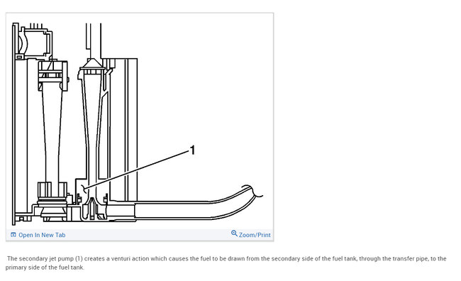

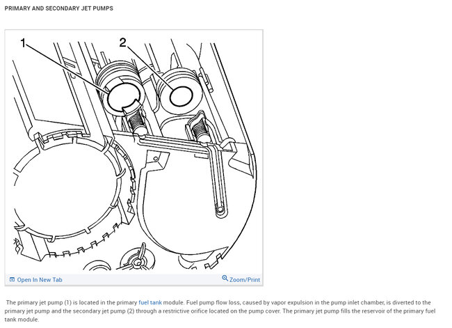

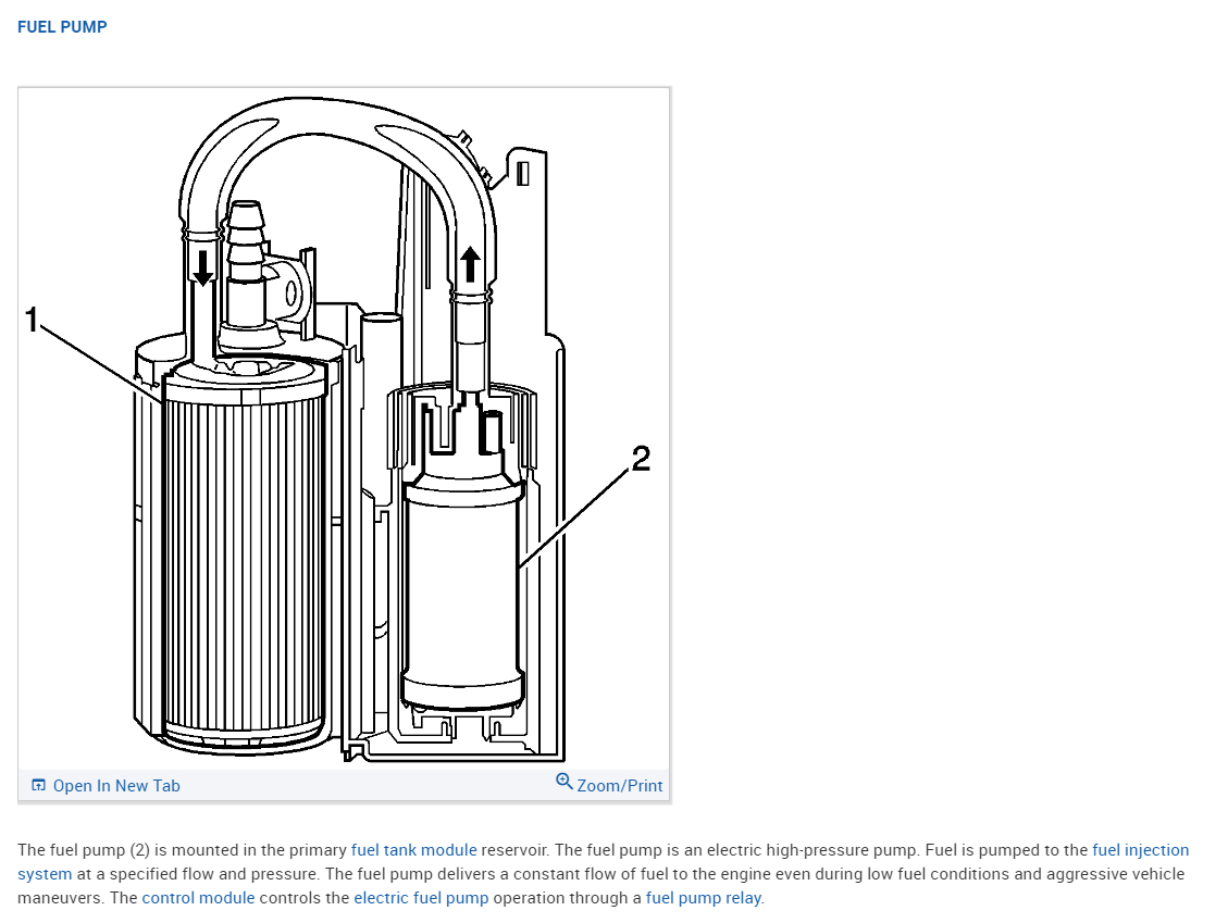

I have to replace the fuel pump on my vehicle listed above (LT model), after searching i have come across a few things indicating there are two fuel pumps. Is that true and if so, how do i know which to replace? i just don't know what to do and need some clarification about it.
Sep 28, 2023 at 12:24 AM
AL514
  • 5,697 POSTS

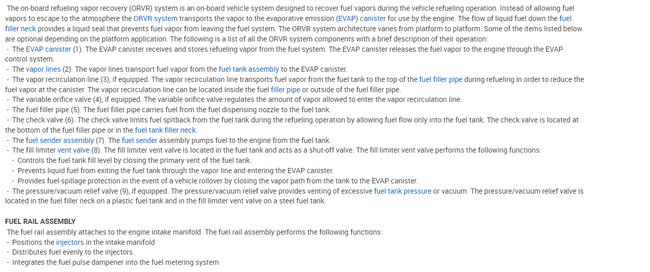

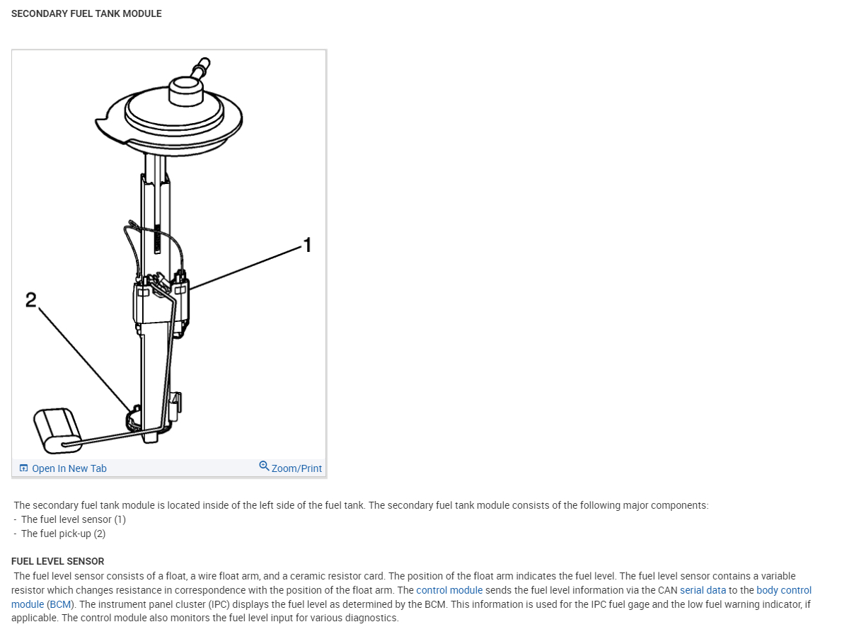

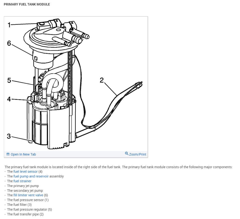

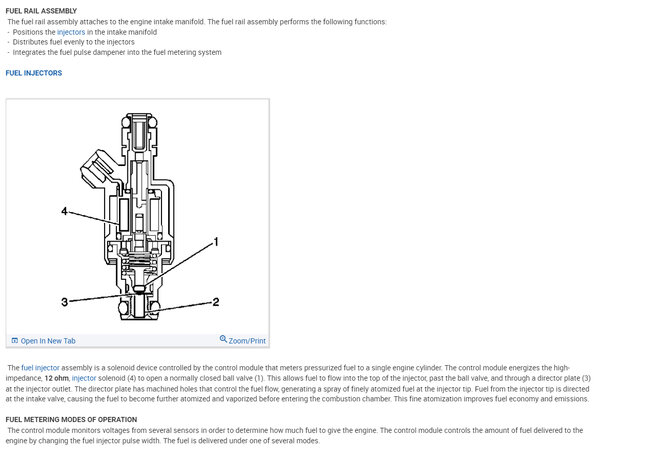

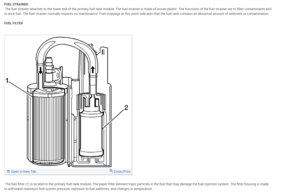

Hello, it looks like the pump assembly is one unit, it's a unique design. It is to ensure there is always solid fuel pressure "even during low fuel conditions and aggressive vehicle maneuvers". If there a reason you need to replace the pump assembly?

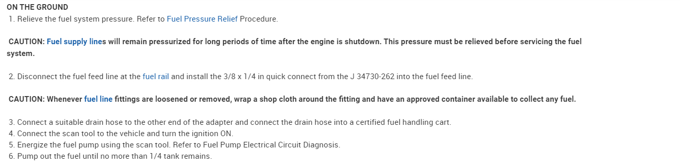

This is what service information is showing.
https://www.2carpros.com/articles/how-to-replace-an-electric-fuel-pump
Sep 28, 2023 at 3:11 AM
AL514
  • 5,697 POSTS

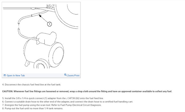

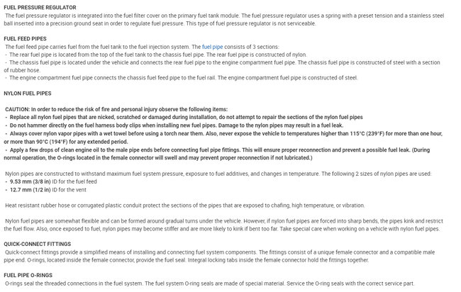

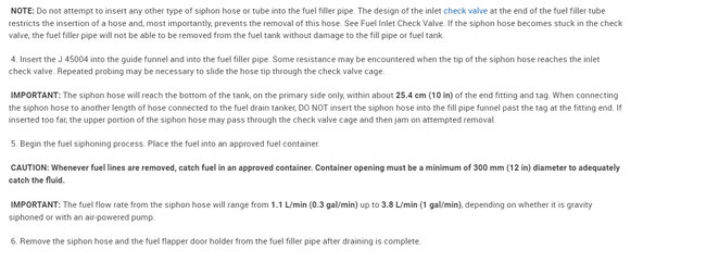

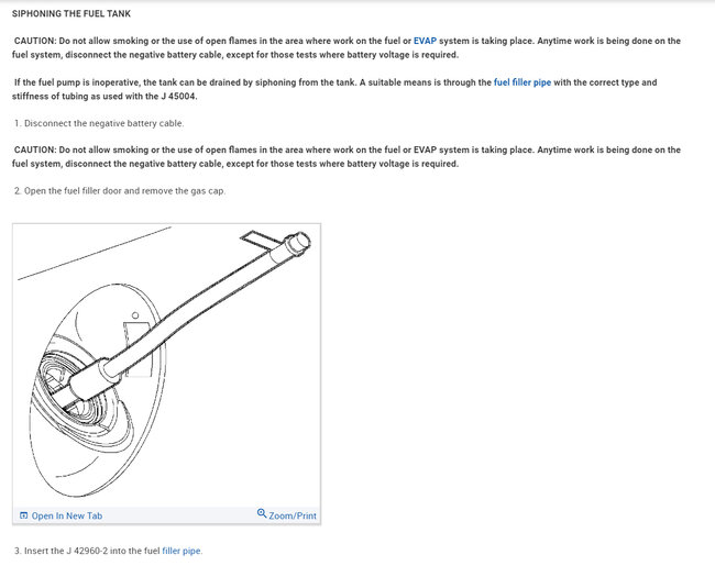

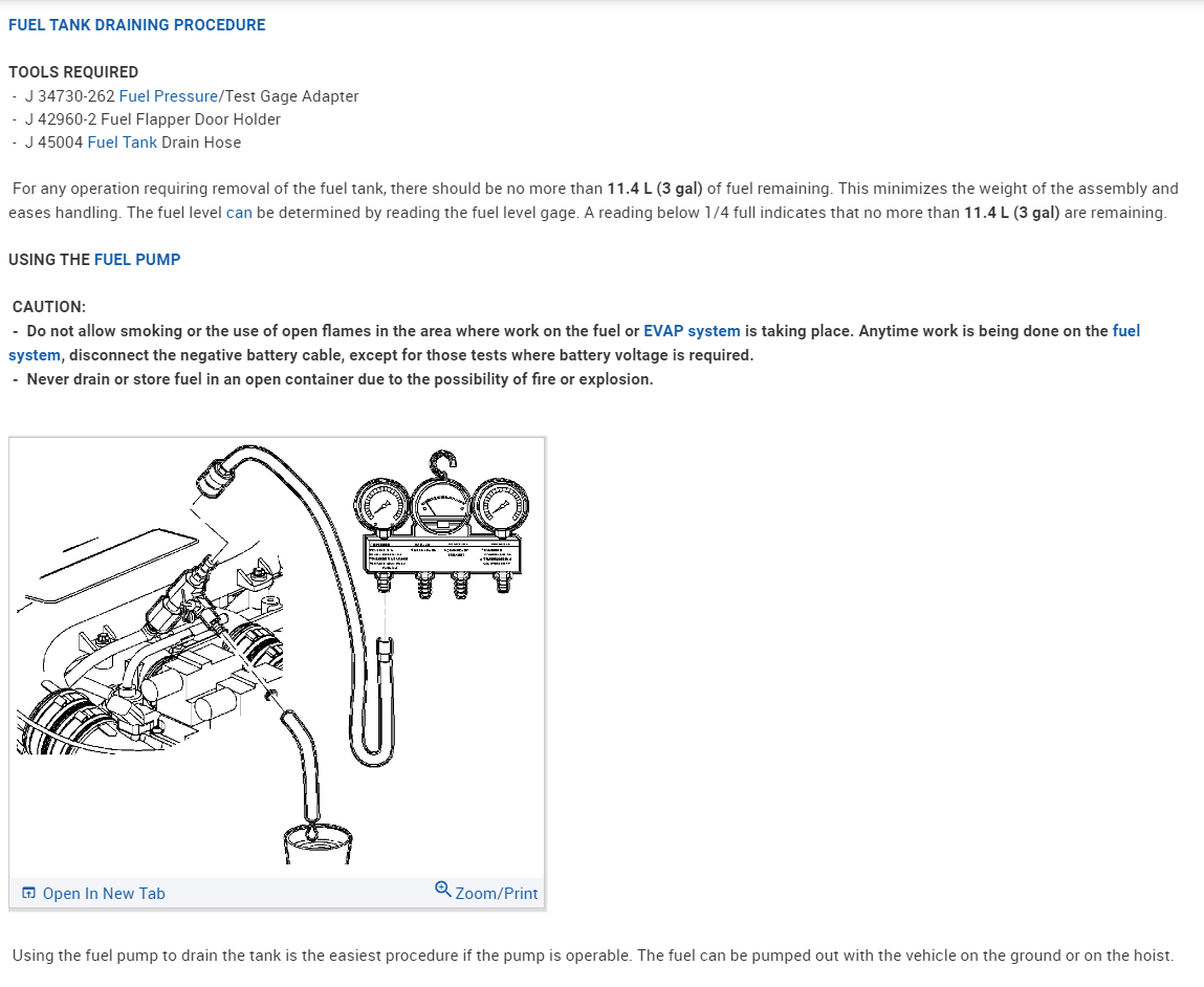

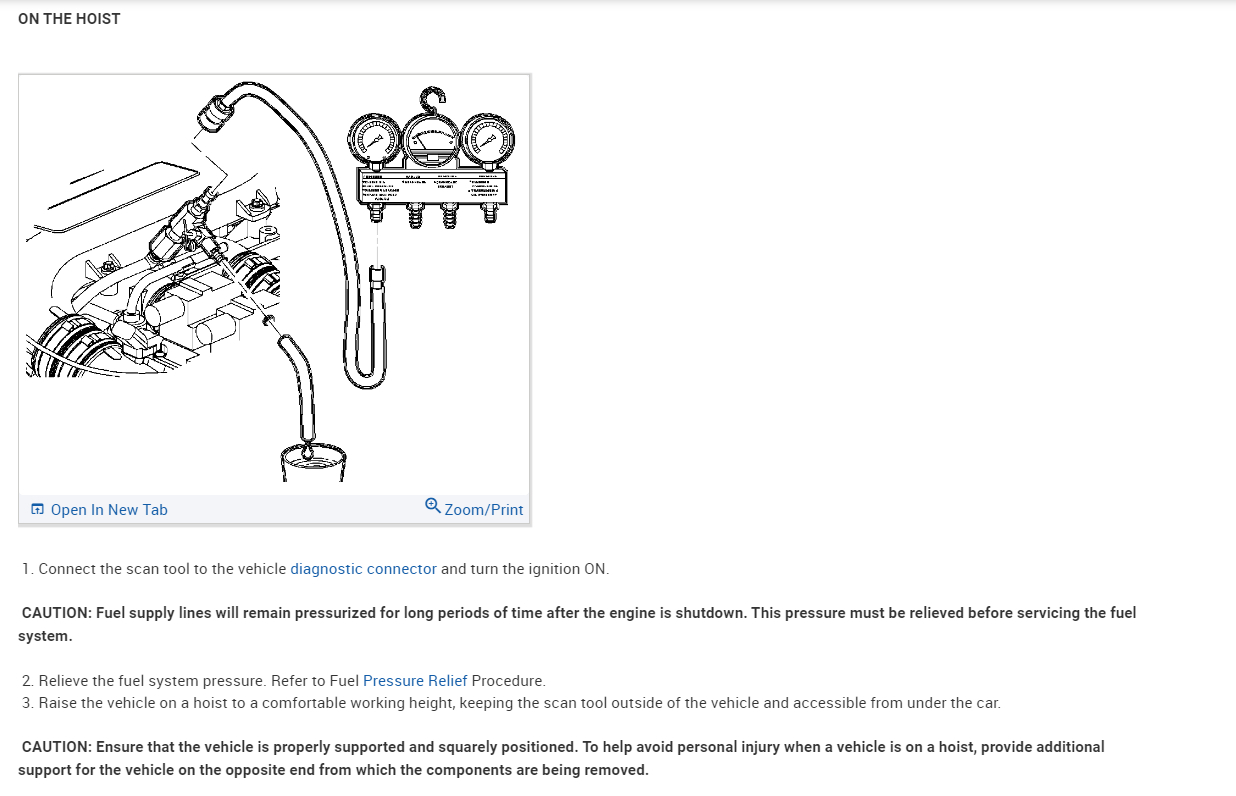

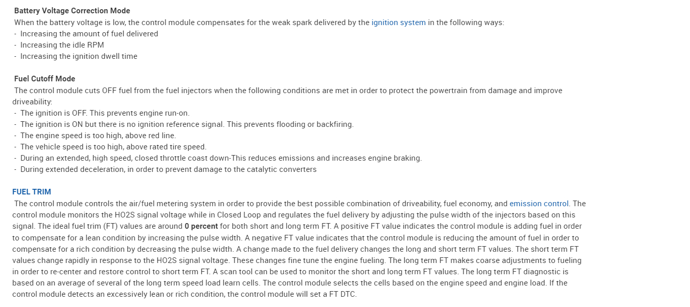

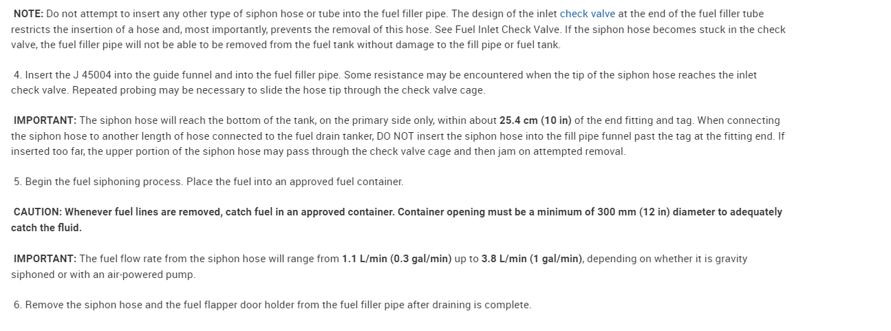

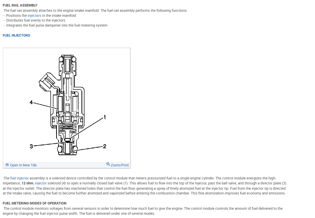

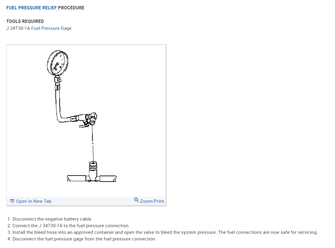

Here is the process for fuel pressure relief and draining the tank. And then pretty much all the service information on this fuel system and operations. I don't see any access to the fuel pump assembly, so it looks like the tank needs to be dropped.
There are quite a few Fuel System Technical Service Bulletins, so if you are having some specific issue, it would be good to look that up before dropping the tank.
