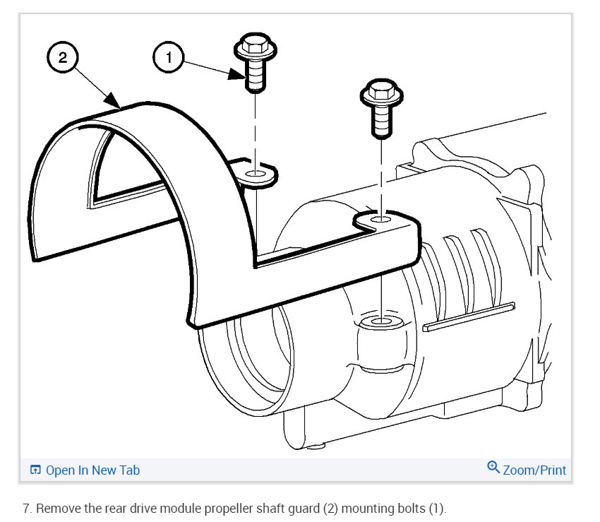

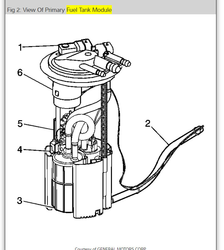

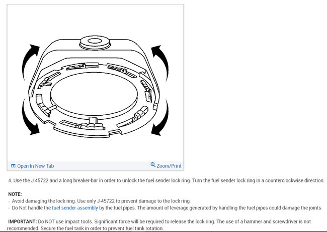

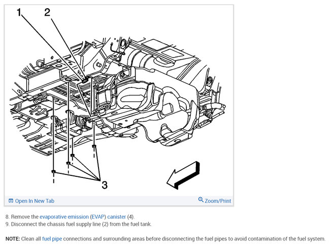

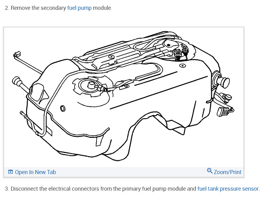

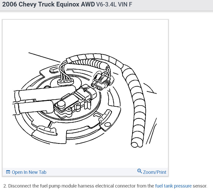

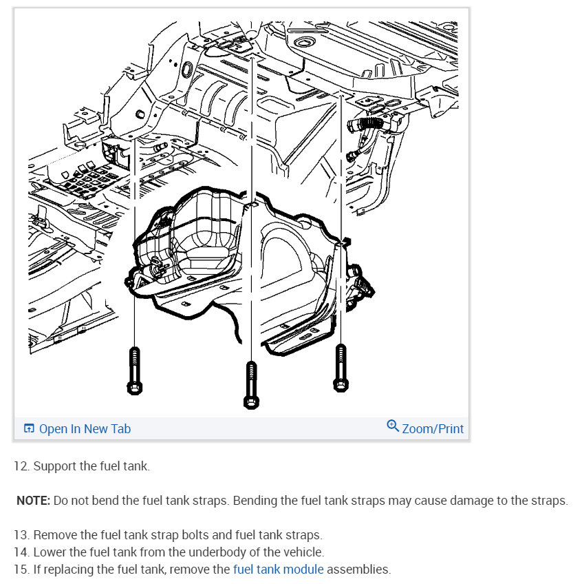

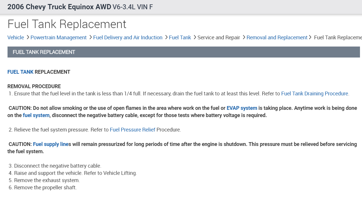

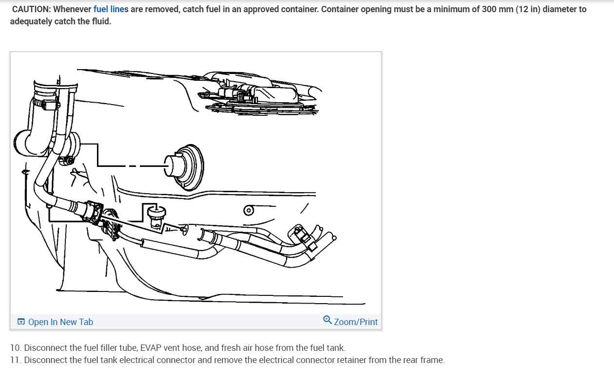

how do i access my fuel pump? Can I do it myself?
Feb 23, 2016 at 7:26 AM
WRENCHTECH
  • 20,761 POSTS
Here are the instruction in the diagrams below to do the job. Check out the diagrams (Below). Please let us know what happens. Take you time have a friend help
