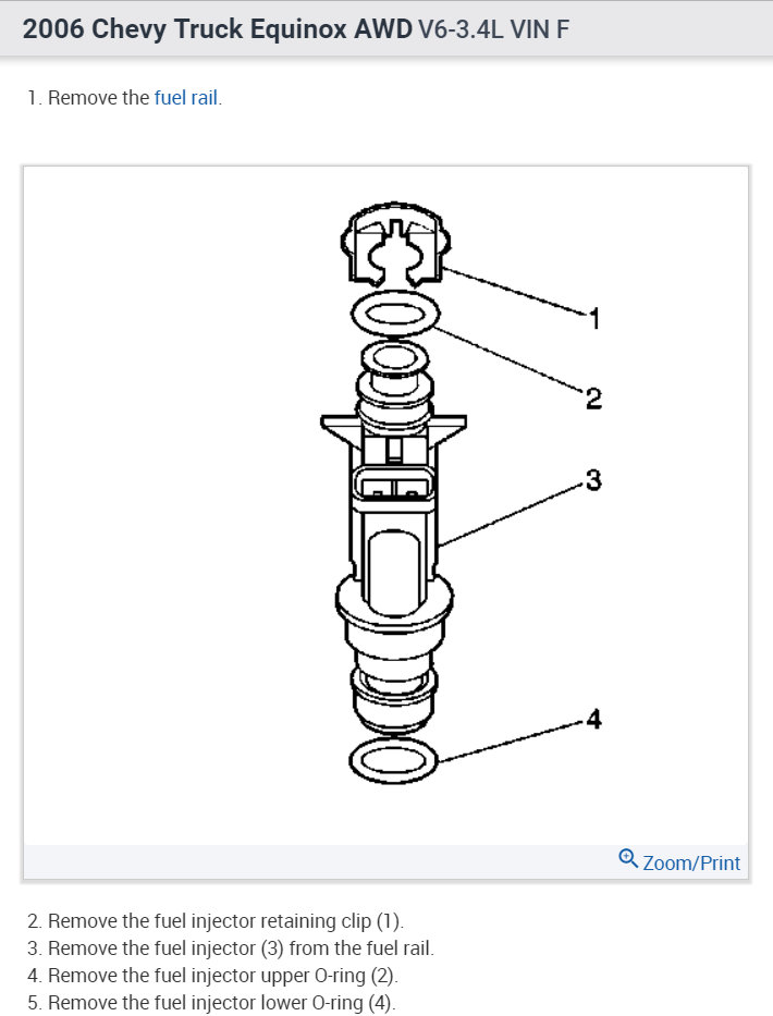

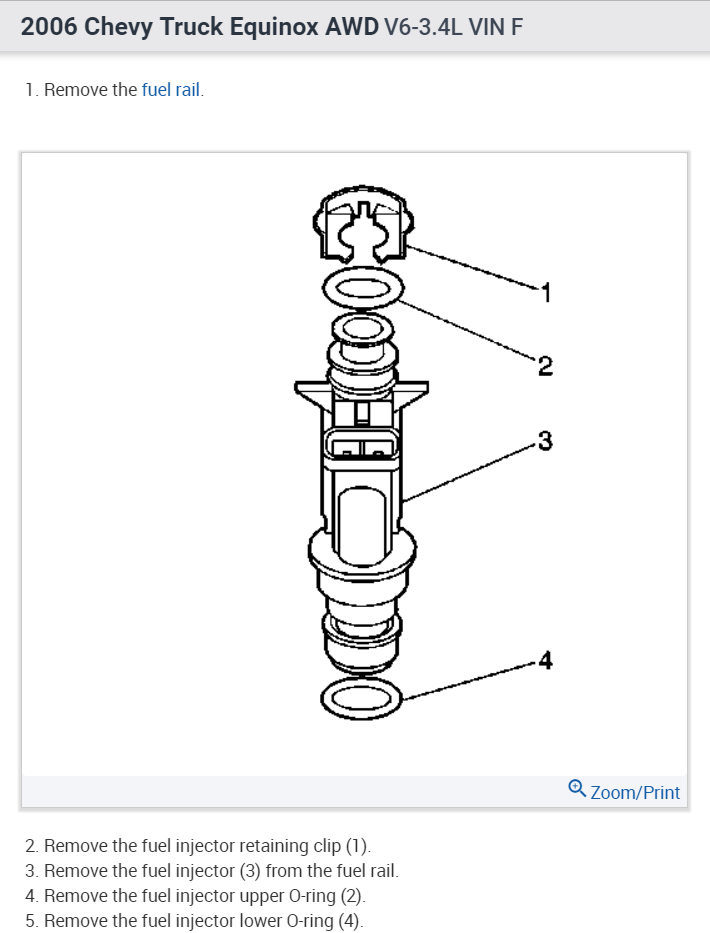

TMALLERNEE
I had the spark plugs changed in my SUV and now when I start the car there is a exhaust/gas smell coming through the vents. What might this be from? Thanks for your help.
Oct 22, 2020 at 10:47 AM (Merged)
  • 110,194 POSTS
If you smell fuel through the vents, there must be a leak under the hood of the vehicle. I would lift the hood and using a flash light check each one of the injectors this is usually where they leak.
Here is a guide and diagrams below to help you see what to look for:
https://www.2carpros.com/articles/how-to-test-a-fuel-injector
KENDRARUSSELL
Thanks so much, I had this problem and needed to replace #3. All fixed.
