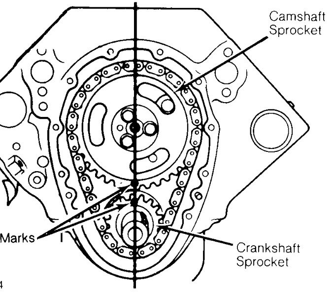

Putting in a timeing chain on a f350 5.8 1989 ford
1989 FORD F-350
100,000 MILES • 5.8L • V8 • 2WD • MANUAL
CHARLES POST
Details regarding put in a timeing chain
Apr 12, 2016 at 10:48 AM
HMAC300
  • 48,601 POSTS
remove front cover see pic drop oil pan down then remove bolt for camshaft remove chain,gear, and crank gear-a puller will be needed. reverse for install torque for camshaft bolt is 40-45 ft. lbs. align new gear and chain like picture. you will need a puller for harmonic balancer
