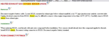

MASTERTECHTIM
  • 4,750 POSTS
only one
https://images.2carpros.com/forum/automotive_pictures/139033_no_24.jpg
