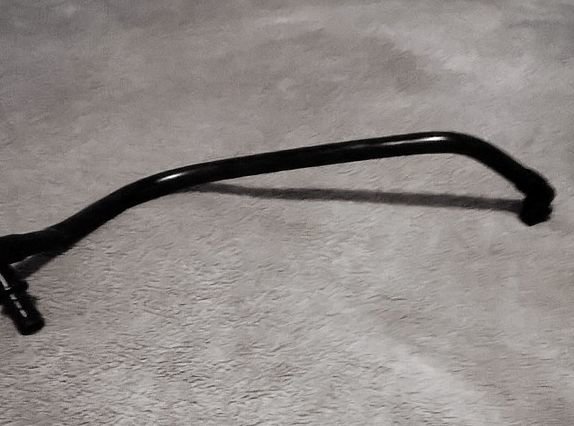

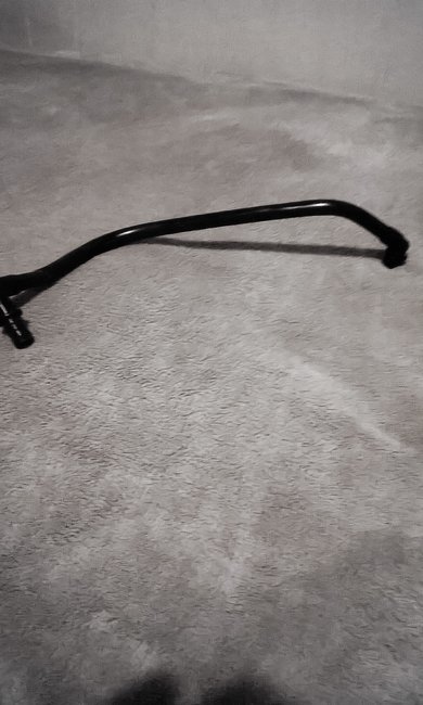

The hose that plugs into back of the motor and the other end plugs into top of large hose that goes to air filter has a bad fitting that goes into back of motor and keeps coming out of hole, so I took it off just to see what would happen and there was no change in the rough way it was running.

How can I send you a pic of this hose ?

This is no working for me.
Oct 12, 2017 at 4:49 AM
BROKENEGGS
  • 198 POSTS

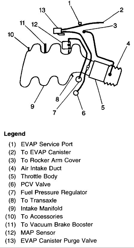

I tried o send a pic to you but I just can't get it to work. But I was able to share it on my FB timeline. You can see a pic of it there. Just go to FB and type my account name ( Richard Whitman ) and you will find the pic there. I can't find this thing at any parts stores here in Houston, Texas. Please let me know what the proper name of it is, Because I am going to have to order it from dealer or factory and I can't order it if I don't know the name of what I am trying to order. Again Thanks for everything.
Oct 12, 2017 at 6:56 AM
STEVE W.
  • 15,345 POSTS
Most likely item number 3 which is a fresh air hose for the PCV system.
Oct 12, 2017 at 11:00 AM
BROKENEGGS
  • 198 POSTS
please check out pic on Facebook. Open Facebook at top left type in Richard Whitman and check out the picture of item I need. If you know what it is called please let me know.
Oct 12, 2017 at 11:21 AM
STEVE W.
  • 15,345 POSTS
That picture IS yours from facebook. It is item 3 in the left hand image.

COULD THIS BE THE CAUSE OF ROUGH RUNNING, Do you think when I replace this it will solve my problem?
Oct 13, 2017 at 5:44 AM
STEVE W.
  • 15,345 POSTS
If it is broken or loose it is a vacuum leak. It is the tube that let's fresh air get into the engine so the PCV system can work.
