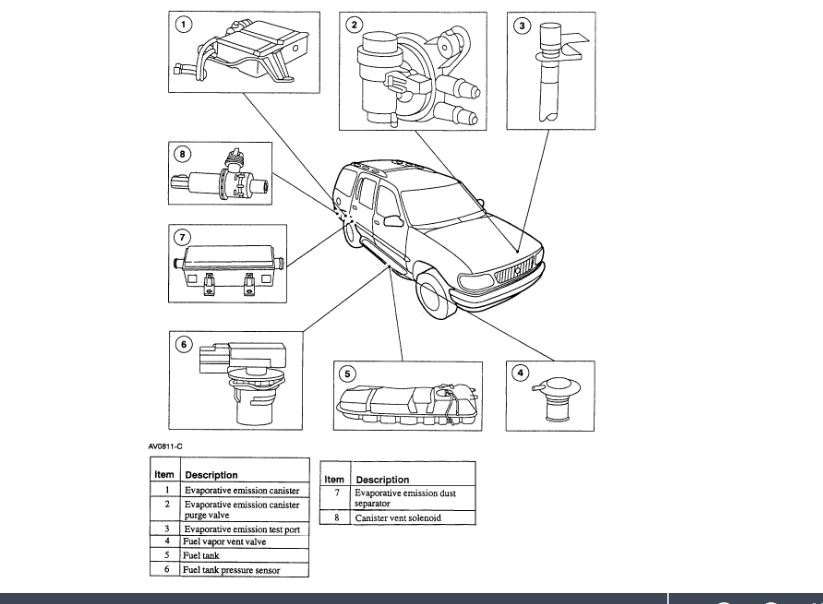

Trying to locate to purge valve. Thanks for your help.
Nov 12, 2018 at 2:29 AM
Good afternoon.
I attached pictures of the valve for you. It is under the hood drivers side.

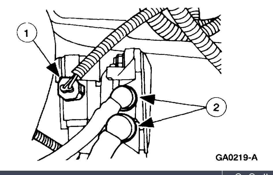

2. Disconnect the tubes.
1 Disconnect the electrical connector.
2 Disconnect the tubes from the evaporative emission (EVAP) canister purge valve.
3. Disconnect the evaporative emission canister purge valve and bracket.
^ Remove the bolt.
4. Remove the evaporative emission canister purge valve.
1 Disconnect the vacuum line from the evaporative emission canister purge valve.
2 Remove the evaporative emission canister purge valve.
INSTALLATION
1. To install, reverse removal procedure.
2. Leak test the evaporative emissions system. See: Evaporative Emissions System > Component Tests and General Diagnostics > EVAP System Leak Test
3. Perform the Evaporative Emission Running Loss Monitor Repair Verification Drive Cycle.
