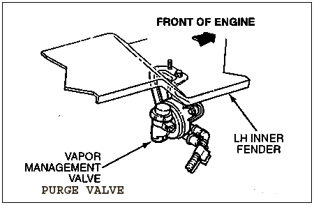

were is the purg valve on my food i need to peplace it to pass

Sketch below shows purge valve location
https://images.2carpros.com/forum/automotive_pictures/433905_1996_Purge_Valve_copy_1.jpg
The 2 hose connectors (one green) (one black) are a little bit of a pain to get off...you have to squeeze in the center where the little plastic hold arm slides over each hose acceptor.
https://images.2carpros.com/forum/automotive_pictures/433905_Purge_Valve_1.jpg
PURGE VALVE LOOKS LIKE THE ONE ABOVE. OBD-II code P0442 is sometimes just a gas cap replacement too. Good Luck; Rick
