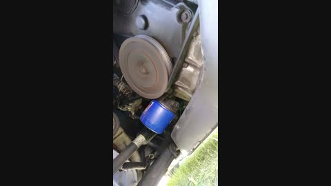

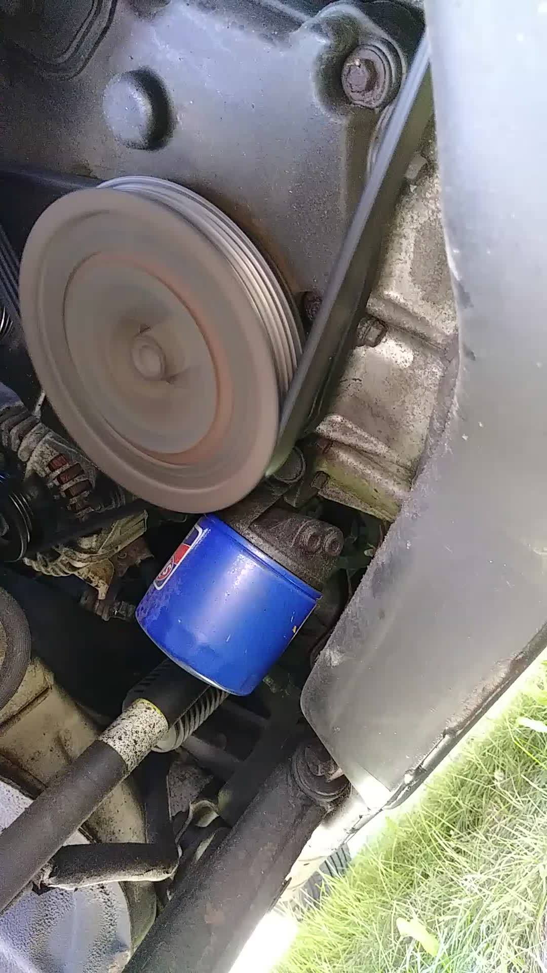

I have a pulley (I think?) That is wobbling during idle and I think when I drive. My AC quit working and my car kind of sputters mainly right after I get gas. I do not know if these two things are related, but here is what I would like to know:
What is the thing in the video, shaking?

That is your crankshaft pulley that is wobbling. If the bolt holding that on is loose and comes off that could cause massive damage while driving if the pulley comes off. It is possible the pulley is out of round from wobbling like that. It is supposed to be press fit on so it should be extremely tight on the crankshaft. I would definitely have that looked at as soon as possible. The A/C not working would not be related. When is the last time you had refrigerant added? Do you notice if the A/C compressor is cycling? I have attached a tutorial for you to look at. Hope this helps and feel free to ask any questions. Thanks for using 2CarPros.

I needed a new harmonic balancer, accessory drive belt idler pulley, two serpentine belts, alternator drive belt, engine damper. Both the alternator drive belt and engine damper are under labor and I can still hear it squeak.

The problem was the wobbling. Yes it solved that, he basically replaced everything, but there is still that sound that sounds Like there is something wobbling. Maybe I am suppose to hear it run, but it seems kind of loud for when it runs idle. I can hear it inside the car.
